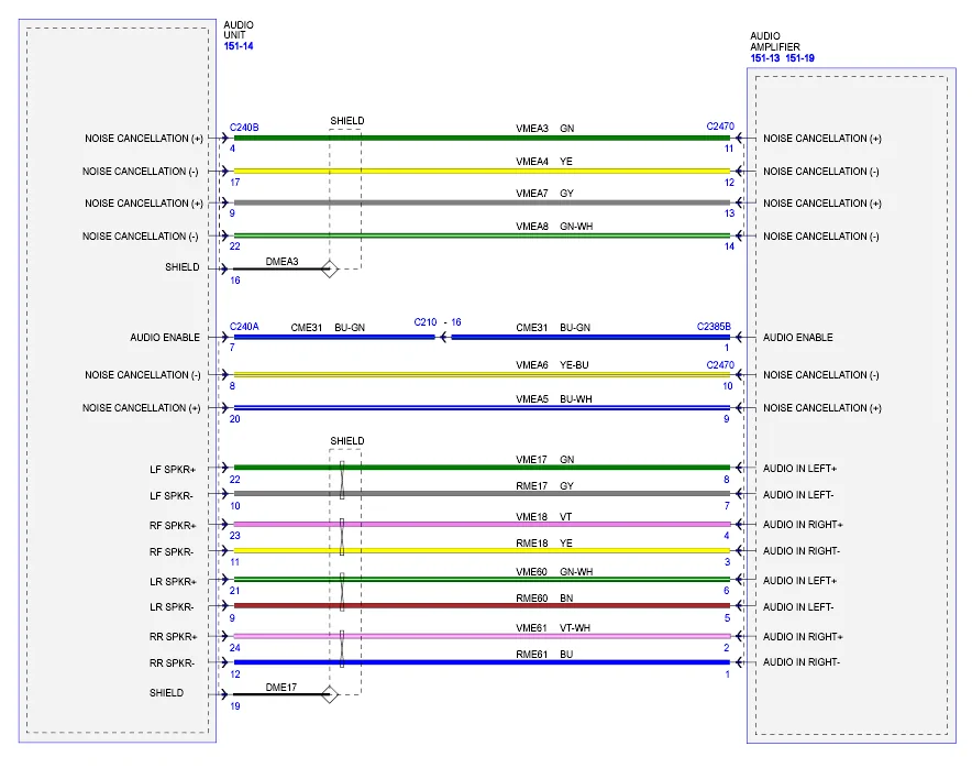

The inputs are on the black connector. All connections are just above the drivers kick panel. There is a grey and a brown connector too. You will see them if you look under the dash.

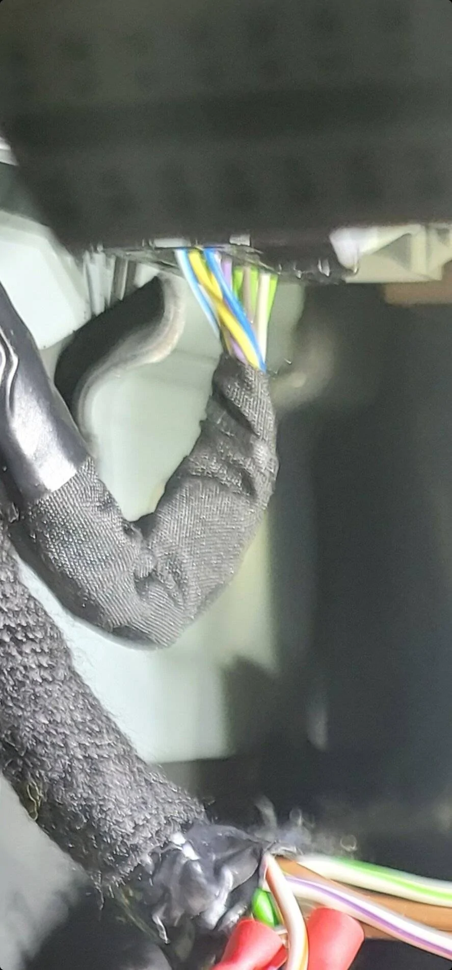

Perfect, I have a pic I took last night. Brown and grey were the outputs. This is the black so will be a piece of cake.

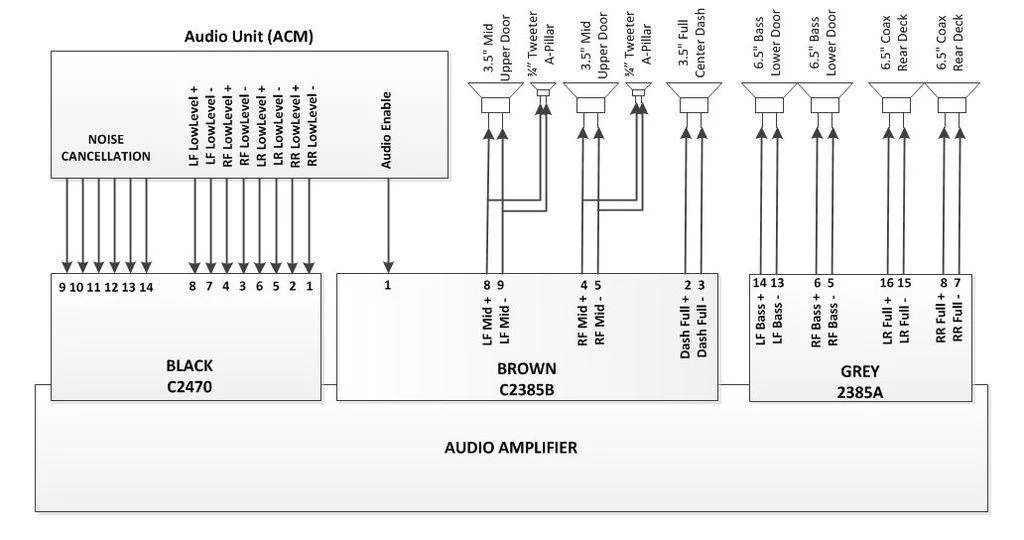

You want pins 8,7,4,3 at the amp side.
