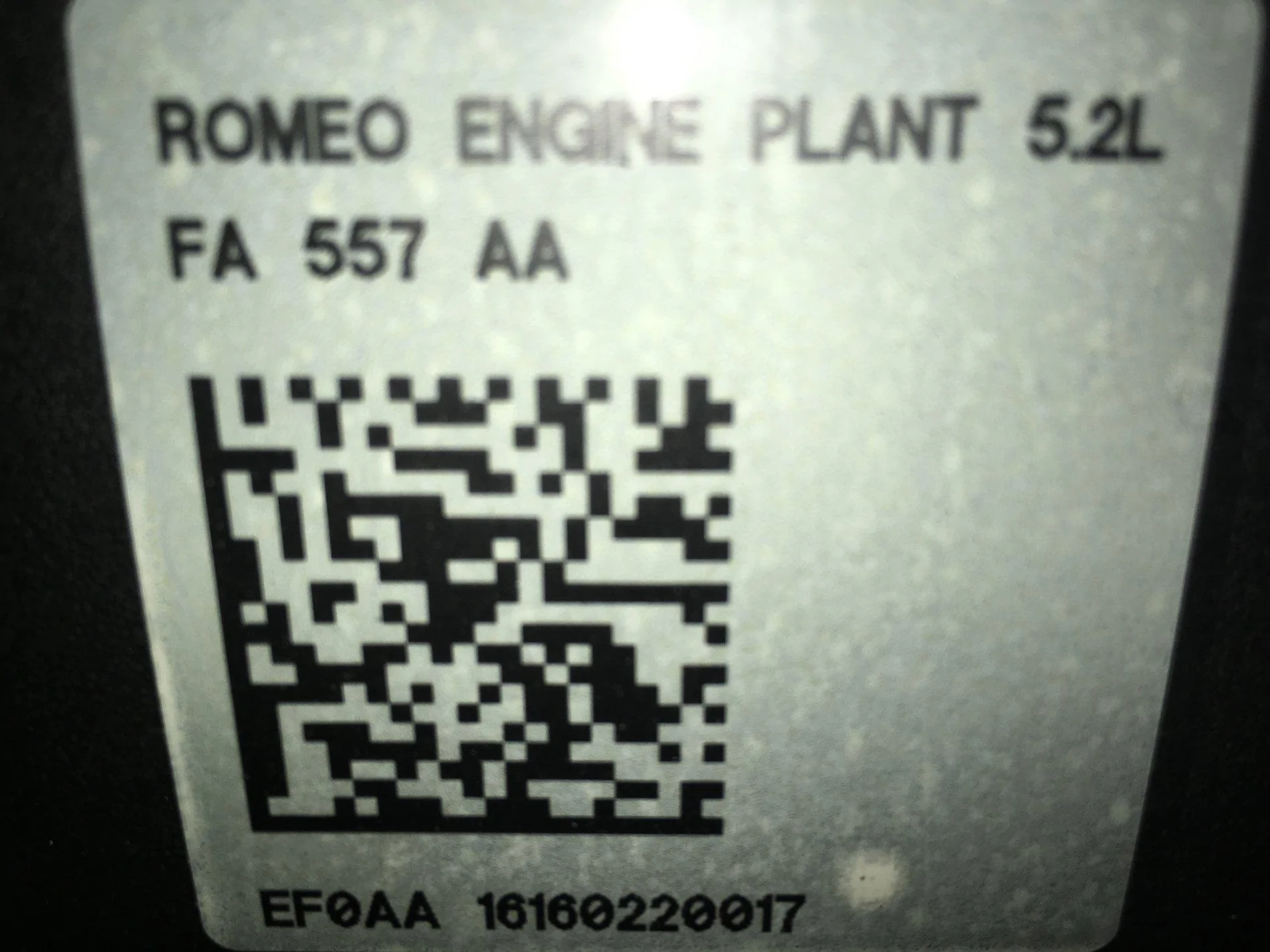

your Label decoded
2016 GT350R GR245 Engine Build date 3/31/2016
The Engine Design plan (Calibration Code) GA-555-AA
means that the engine design plan 2016 for a GT350R with no revisions.
this means the Motor is intended to be installed in a GT350R using the procedures outlined in the
GA-555-AA plan.

This should be 3/30/16 if I am correct. Thanks for the info H6088, great information

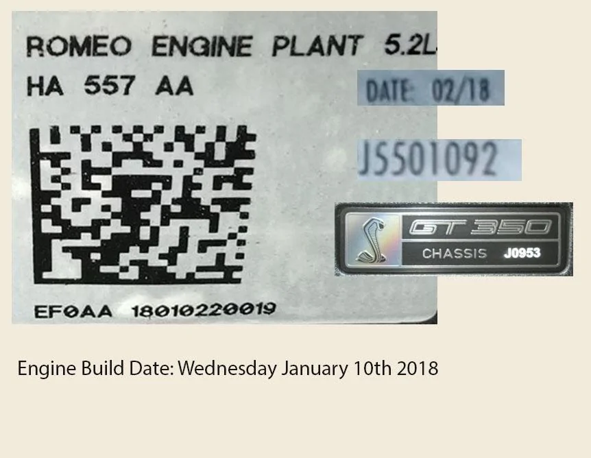

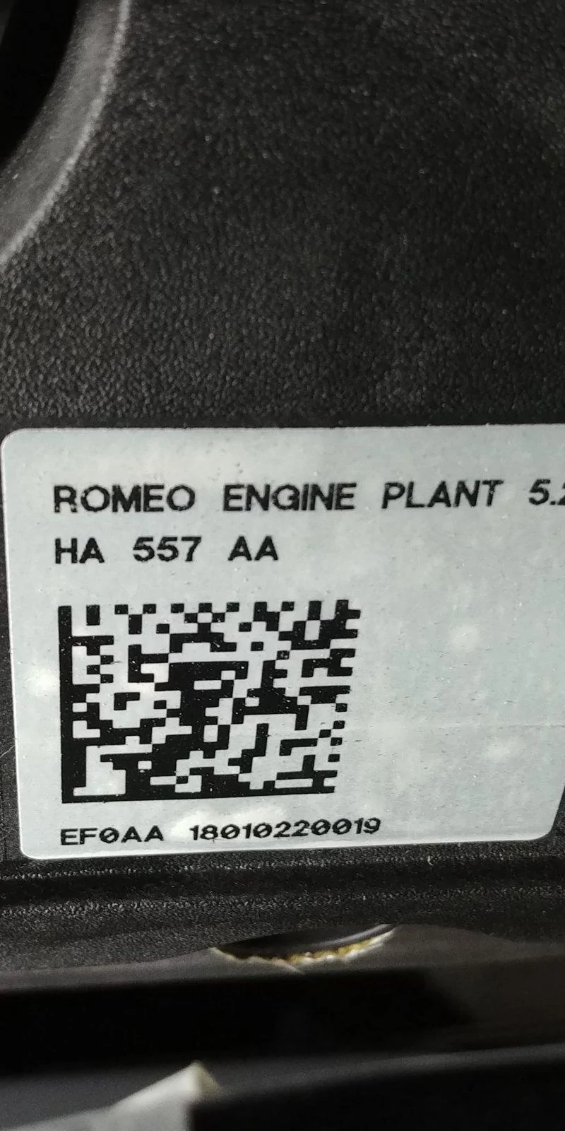

My engine build decal was the one featured in the first post. I'll add to it the build date and chassis date, as well as the MSRP blend and build dates:
Engine Build Date: 18010 = Jan 10th, 2018.
Door Jam decal build date: 02/18
MSRP sticker: Blend date Feb 21, 2018
MSRP sticker: actual build date listed on bottom is Feb 13, 2018
Chassis J0953
Small sticker under coil cover has a possible date of "11-08-17". What's that mean? (see pics)
It was stated elsewhere and appears to be true, that the slight change in piston rings made around 1/1/18 may not have been large enough for them to change the engine designation.
Question: Ford docs show that MY18 cars were not being assembled in Dec and Jan, so why are there engine build dates in Jan? Do they make engines at Romeo even though car assembly was not starting up again until Feb?
