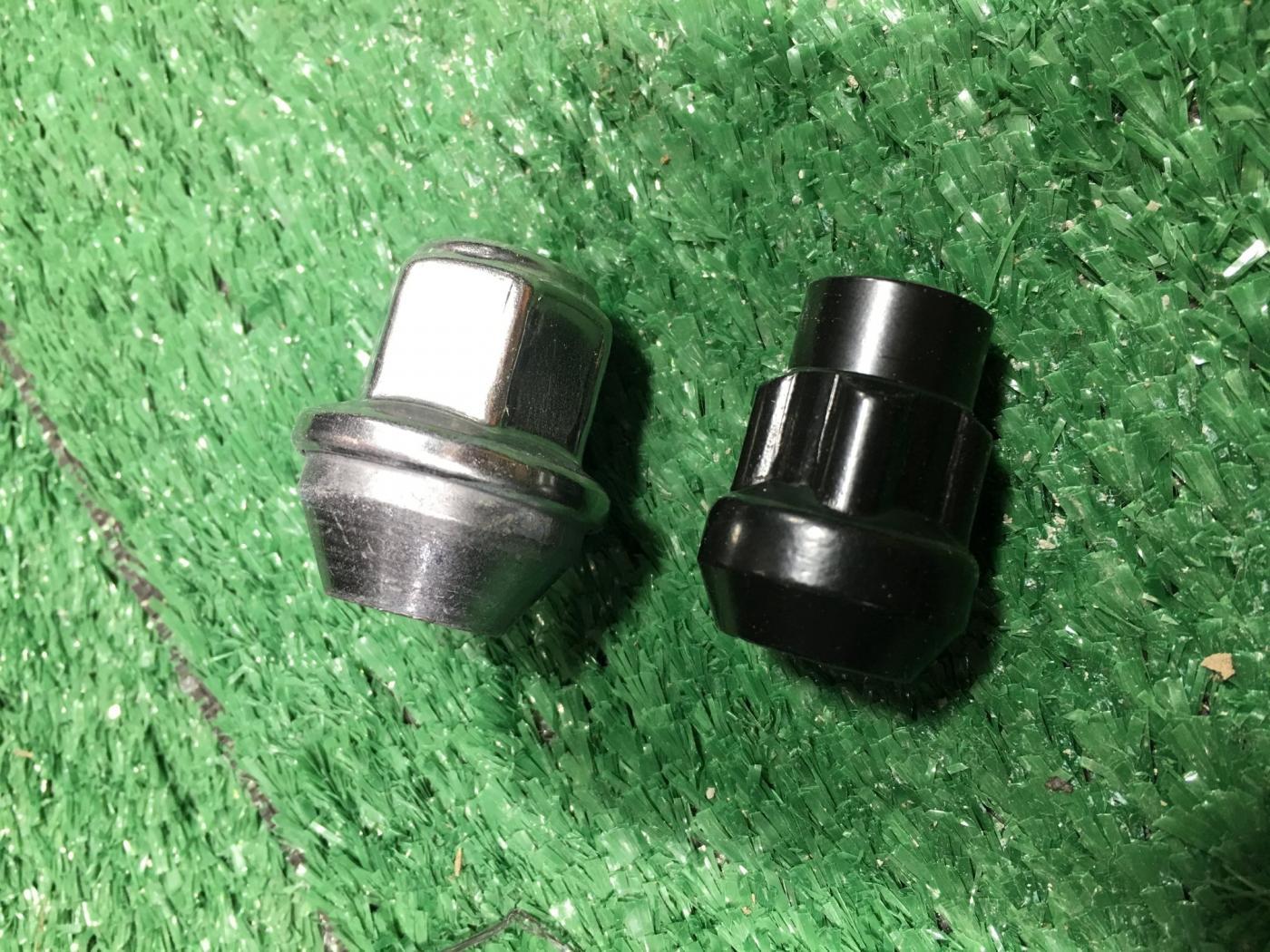

I was informed by Ford Racing that the lugs are larger on the GT350s therefore I don't see how lug nuts from any 2015 Mustang would fit. Maybe someone can address the lug size of the standard Mustangs compared to the GT350 lugs. I was told the GT350 has 14mm lugs while the regular Mustang has 1/2" lugs.
The chrome are stock, the black are '15-'16 from American Muscle. The black don't fit!
