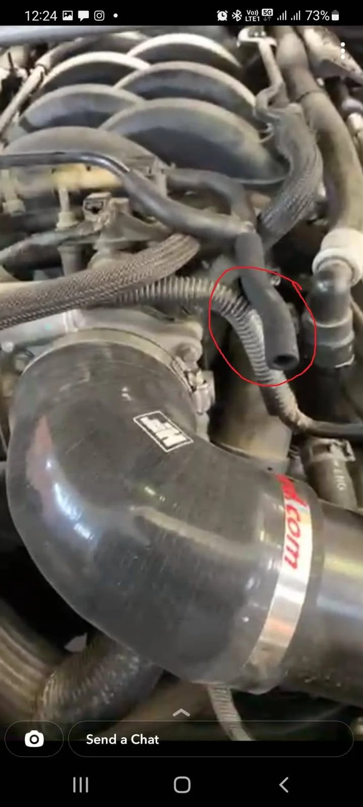

Hi I installed a twin turb on my car and i left the vacuum line without any connection i found out later that it was its leaking boost with 9 psi springs i hardly got 4 psi i would like to know what is proper way to connect it.
Thank you.

I don't see how 5lbs of boost is getting out that little hole though.

Besides that line you will also have 2 other items that are boost leaks that will need addressed to be proper.

so i have to make hole there and connect it to intake tube
No. Just remove the Y that hose connects to and replace it with an elbow that completely eliminates the hose all together
