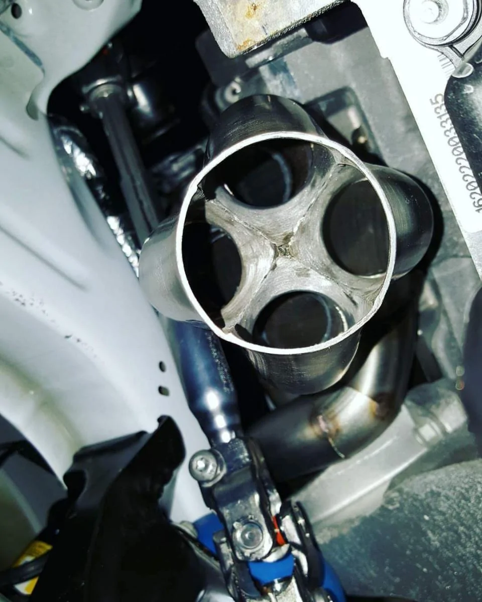

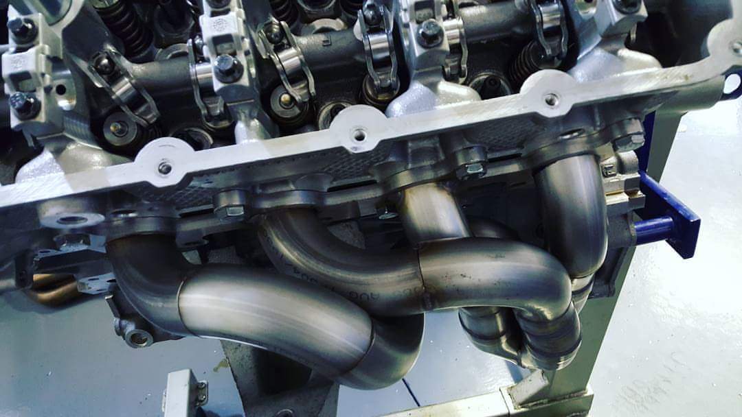

The key to keeping the sound the same (with the addition of some turbine music) is to build a proper set of manifolds. The turbo manifolds will be built from 321 stainless steel, and will feature 1.75" primaries with 2.5" collectors. The runner length will be optimized to make the best use of the flat plane engine's exhaust pulses for scavenging, as well as timing the pulses to reach the turbine in a fixed pattern. This will help with transient response and lag. They will feature 4-1 collectors with a proper "merge". If we get it right, the car should sound amazing, and retain the sound that you are all now very familiar with. Much like our C7 Stingray Twin Turbo system, our fabrication methods won't stray far away..

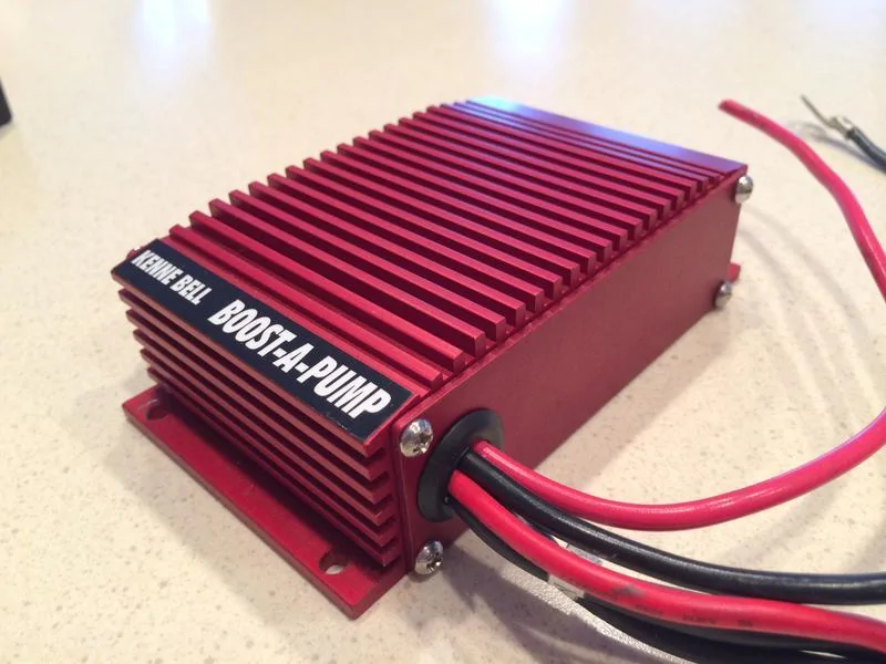

We will also be experimenting with flow rates of the OEM twin fuel pump design using Kenne Bell's tried and true dual 40amp/20 volt Boost-a-Pump voltage booster. This has been proven to provide enough fuel for 1000whp with the GT500. We're hoping for similar results here. If not, we'll redesign with a new basket and pump setup.
Oh, and yes.. it's going on the corn. This beast will be fed a steady diet of E85 fuel to safely generate (what we're hoping) will be in excess of 900-1000hp at the wheels.

Making some good progress on the turbo manifolds! True 4-1 merge collectors, CNC milled stainless T3 transition flanges. All sourced, machined, and fabricated in the USA! :)
