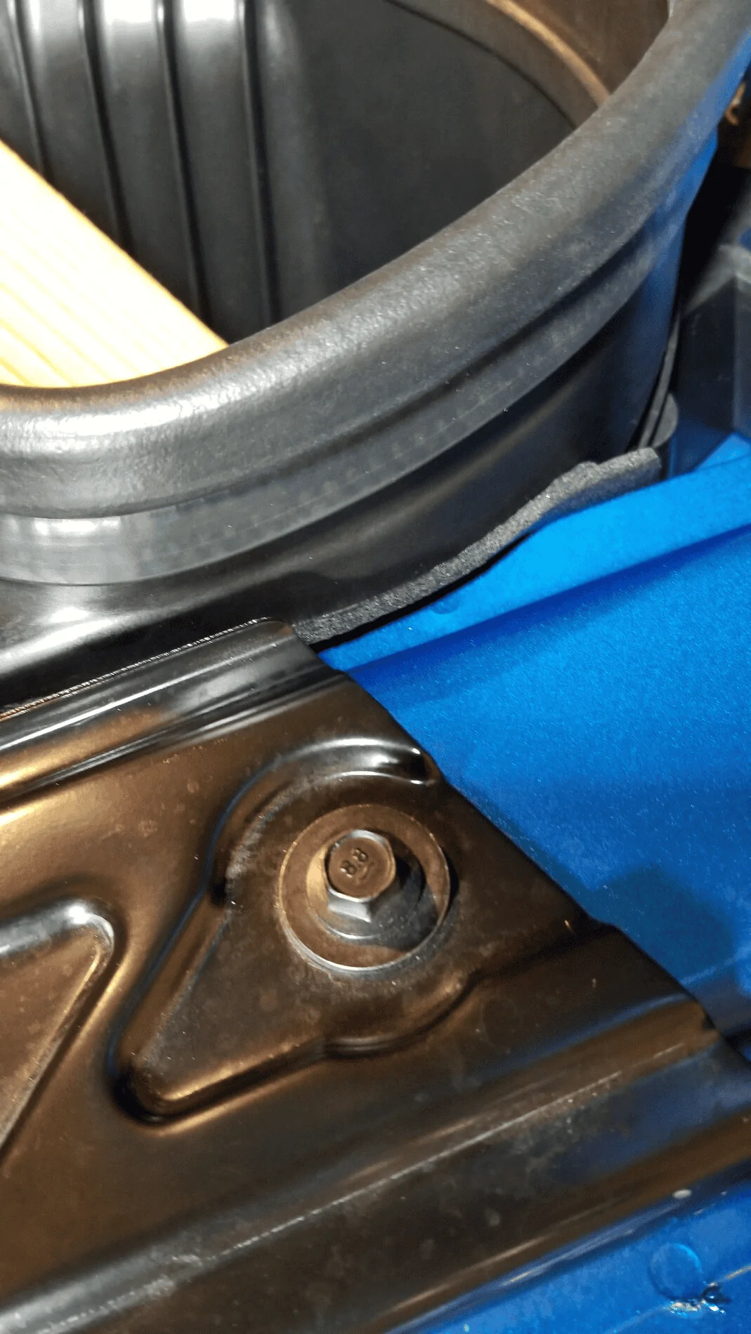

This is really great info. I have the FP calibration kit with the GT350 intake. I was thinking the GT500 lid would fit on it too. That kit comes with an open top intake that seals to the hood. I don't mind that so much as the poorly implemented foam seal along the right side of the box (what Ford incorrectly calls an air filter #9601 ). How is that installed to create a good seal on the GT500? I thought I had mine correct but looking at your pictures I may have installed it on the wrong side of the intake housing! I situated the the foam on the outside of the box so the soft compressible foam would seal around the hole. Now it is tearing and the two foam halves are separating. I have had to use black RTV to close it up. My OCD won't allow me to leave it alone.
Air intake temperatures are quite likely higher with the open top seal. So I would love to close it all up good. But have my doubts now that I have seen the same shitty foam piece in use on the GT500 intake assembly.
Is this correct? I noticed there is a hard foam wedge on the back that looks like it is supposed to sit into the open slot that points downward. Couldn't for the life of me figure out how it was supposed to be so did I did it this way:
It's a really bad design. All because of that brace sticking out. Hopefully these pics are helpful for everyone. Again, I am likely using the foam incorrectly but it was the only way I could get it to seal.

I'm not quite sure. I looked up some videos of GT500 intake installs to try and figure this out. From what little I could see it looks like it goes on outside of the airbox. I looked at that spot on my car and it looks like that square wedge locates in a notch in the body underneath the rad support frame rail.

That being said, everything I've seen indicates it goes on before the airbox tray and sits on the outside of it.

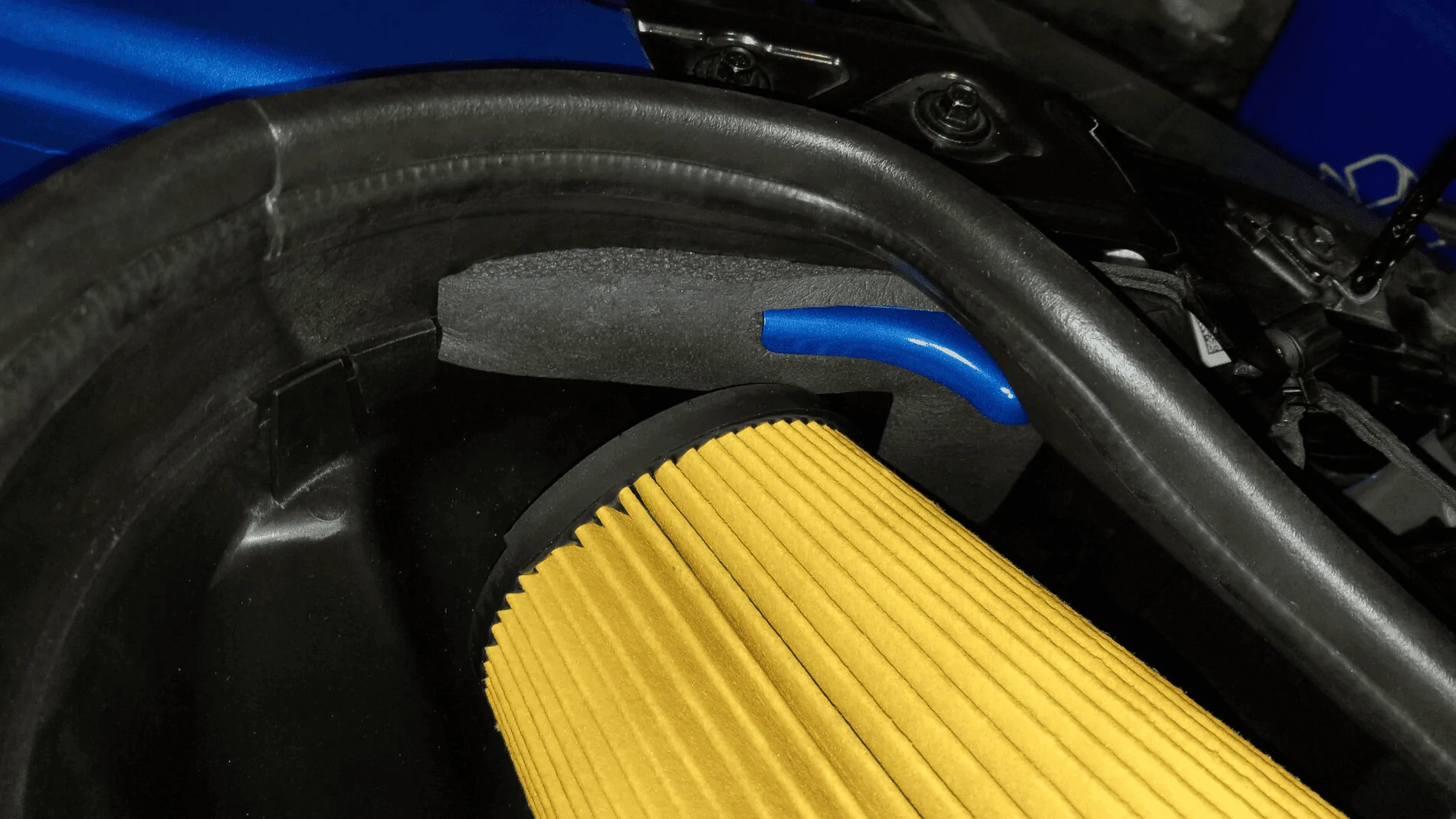

Heres the GT500 airbox with GT350 intake tube. Everything fit right up with exception of that foam peice on the front. It's kinda mashed in there but it's all sealed up well enough. It may look like theres a gap the foam is being pinched. The GT350 snorkel portion of the airbox is a direct snap on.
Also forgot to mention the foam "weather strip" tape used around the intake tube since the GT500 intake tube is a lil larger.

Cool. How are your AIT's compared to the stock intake box?

IAT's seem pretty identical to the stock enclosed box. Much improved over the open GT350 one and now water wont get on my filter.

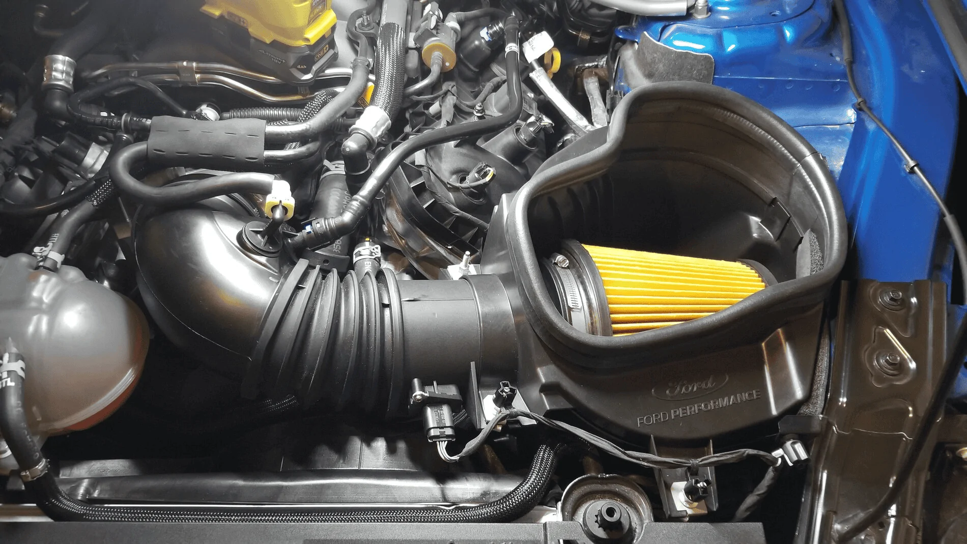

This is something I would also like to know. I'm about to get the power pack 3 installed and the only thing I dont like about it, is the hot air intake.
It definitely looks like the 500 air box should just clamp around the GT350 tube. If anything is different I would think the diameter of the opening in the 500 box might be bigger, which could be sealed with some weather stripping.
Where were you able to price out the GT500 airbox? Thanks.
I just installed the whole pp3, replacing a steeda pro-flow. Last night while cruising, (granted it was cool last night around 65) my ait's were no more than 8 degrees above ambient. The top of the 350 box is relatively tight against the hood.
I am by no means saying the new gt500 setup wouldnt be better, for obvious reasons they worked hard on intake charge temps.
