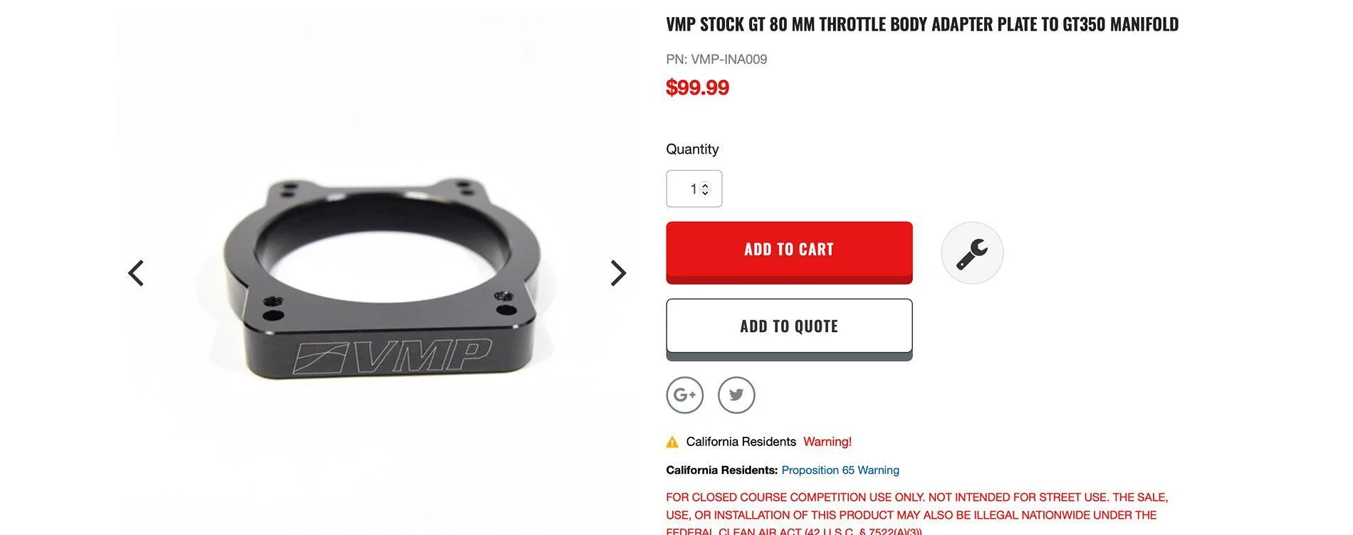

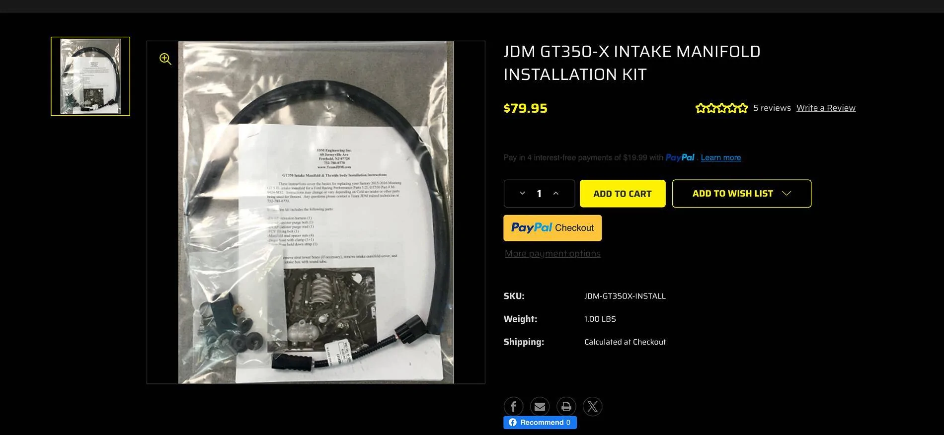

I recently picked up a GT350 IM, Roush CAI, SCT tuner, and will be getting a tune soon. My question is, what's the best budget adapter to run a stock GT throttle body on the GT350 IM. Are they all about $100? Also, do I need a JDM install kit? Is it worth the money? Thanks.

I've got the VMP, no regrets. You'll want the wiring harness extension for the EVAP to avoid a hack job for sure, the rest is up to you.
I had enough odds and ends laying around to make it look OEM beyond the throttle body adapter and harness extension.

Thanks for the info. I picked up the install kit. Mainly because it seems like it would be a lot easier than messing with the wires, with the added benefit of looking cleaner.
Still need to grab a throttle body. This install is ending up being a lot more expensive than I expected. lol

At $99 for the adapter you may want to just consider the GT350 throttle body.
Most of the tuners seem to recommend you stay with the stock GT TB. The GT350 apparently has issues with drivability and throttle response for no real gains.

I just attached my stock 2015 gt tb to my gt350 intake mani, no adaptor needed. Is that normal?

One or the other is not what it seems in your case. The bolt pattern was definitely different in my case.

The difference in bolt patterns is obvious. Outer is GT350 intake, pre-'18 TB is inner.
