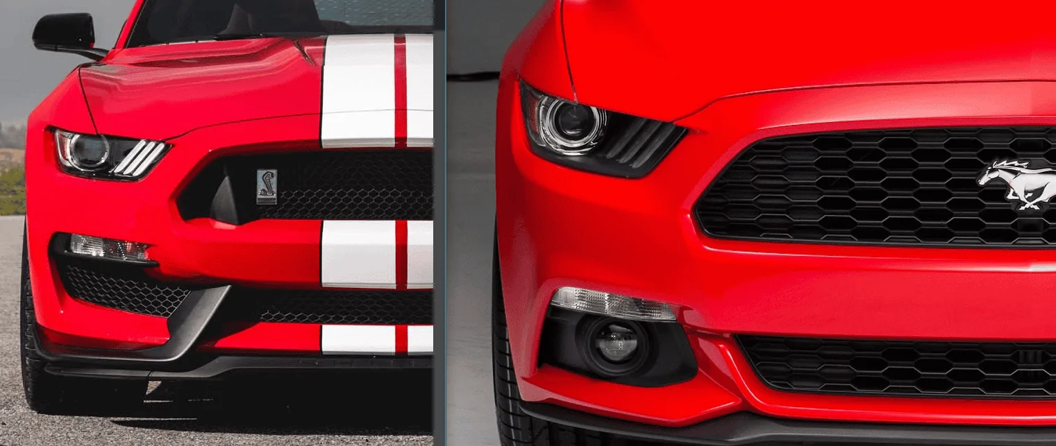

Do you know he's doing that? Or are they replica fenders made for the standard s550? I guess for just the fenders, it would depend on where it starts getting wider...but if i look at pictures of the front ends, it starts getting wider right at the headlights and flows all the way down. Which should mean...where the fender starts should be wider to match that in the bumper, right? From the pic below, the fender even right at the front where it flares out from the headlight, can't be the same width.
For the GT350, I thought the hood sits lower and everything is cut/fits together differently. I know there's different core support between the gt350 and GT. The front bumper also seems to be sloped up more on the gt350 than the GT. So even if you could fit certain parts, I feel like the body lines would be way off.
