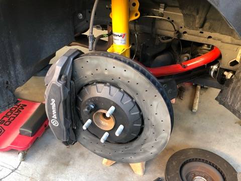

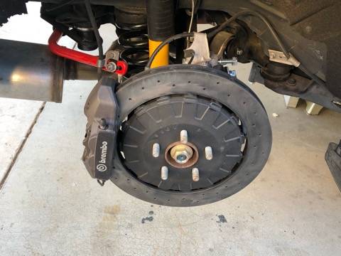

Kellys69z
Jun 30, 2015
264
83
Mesa az
2015 gt premium, Dodge 2500 Cummings, 69 Camaro
I’m I just did the same thing. Front is close, but rear has a wider track width.
Looks sweet! Did you use the adapter bracket for the front or the whole knuckle from a GT350?
Kellys69z
Jun 30, 2015
264
83
Mesa az
I used all gt350 hubs/knuckles. Bought used takeoffs from fleebay.
That is exactly where I got mine as well. Good to know it all works my kit even came with the control arms but I am not sure if I really need those at all especially since they have higher mileage than what my car is.
Kellys69z
Jun 30, 2015
264
83
Mesa az
Yes you do the control arms and tie rod ends are gt350 specific. Also give the knuckles a good looking over I had 1 rear and 1 front that was bent.
