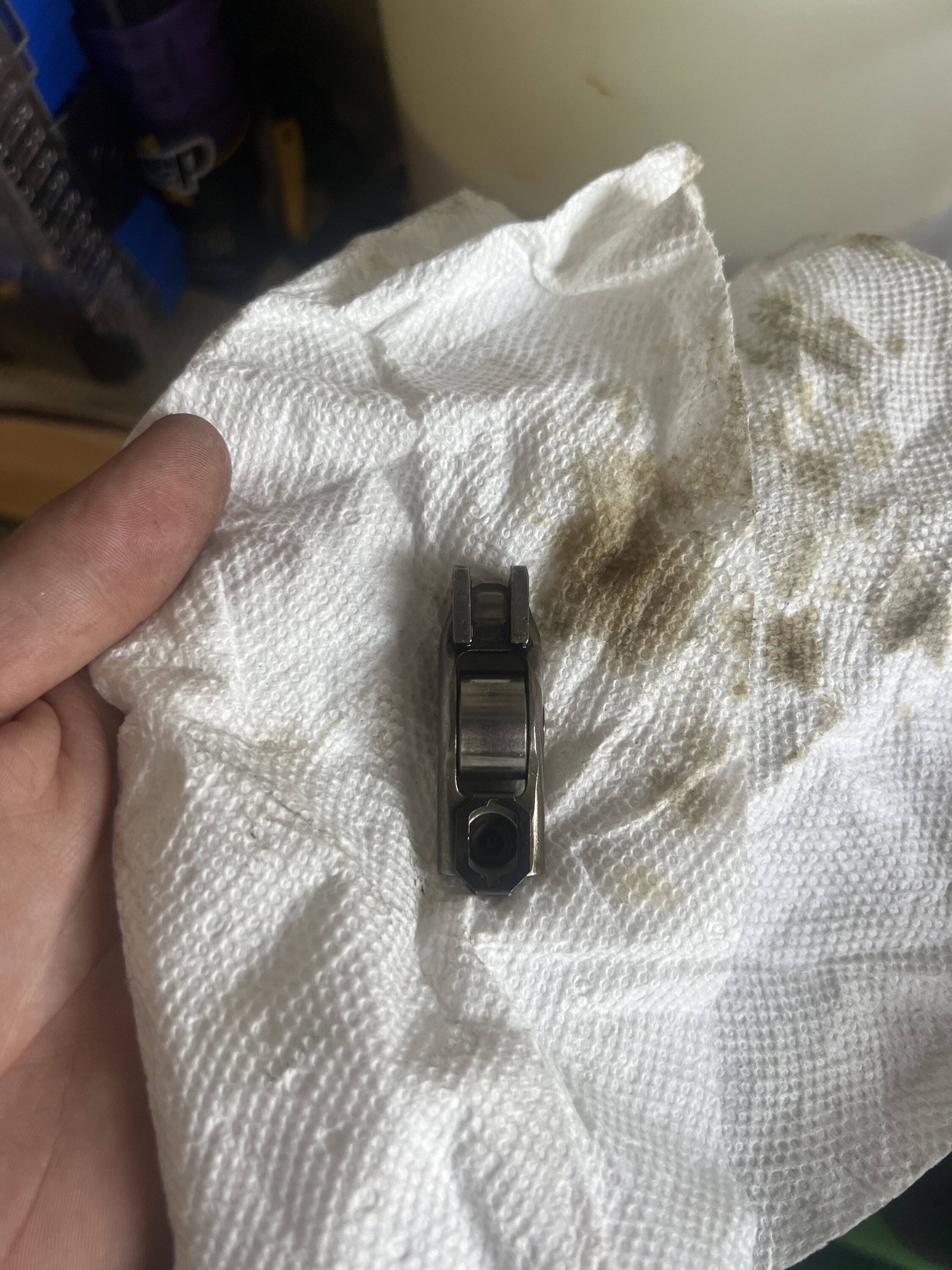

2016 Mustang GT
found this rocker roller laying in the head. Assuming lifter failure, still wondering why it would have 0PSI

Home World: CLASSIFIED
Puddintane
'17 S550
Holy. Prolly the valve is bent.
