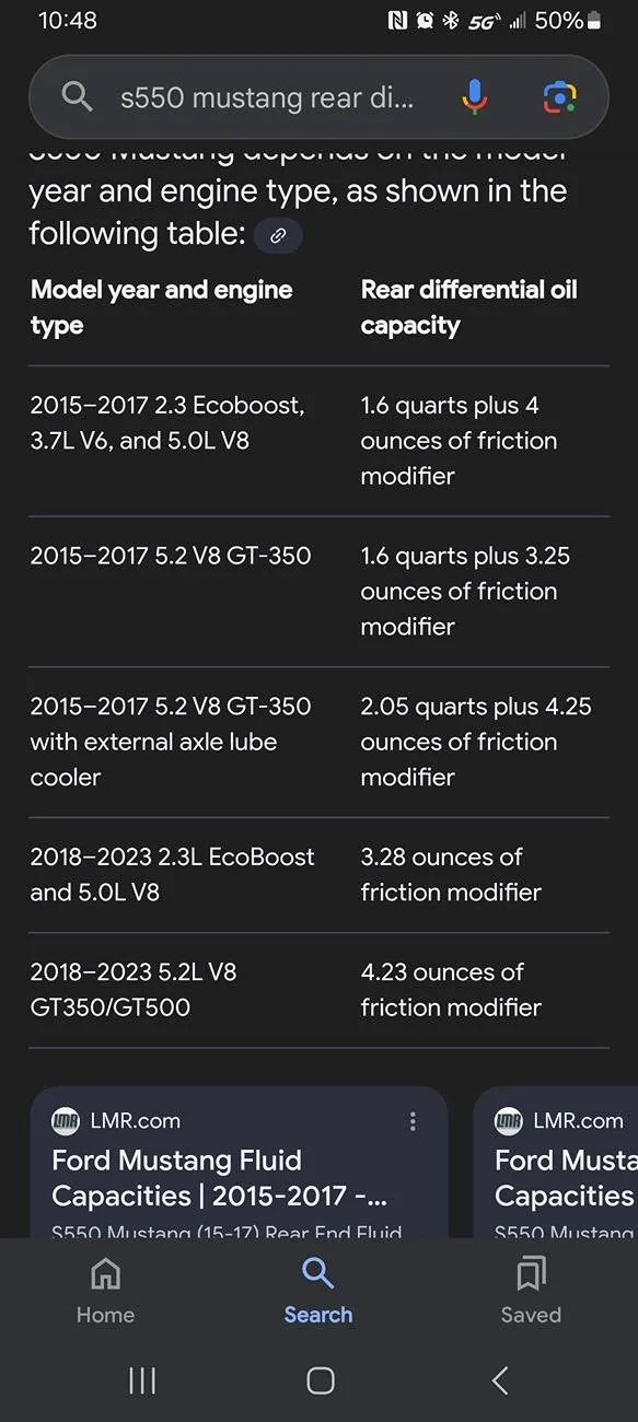

Also I'm a little conflicted on specific fill capacity for the diff. I found this chart stating 2018 requires a different amount of frictoin modifier than the 2015-2017 models which seems odd.
Doing the math for the recommended 1.6 qts oil plus the 3.28oz's of Friction modifier would total just over 1.7 qts of rear diff fluid. At what point are the tenths of a quart irrelevant? I went old school method and filled to the bottom of fill plug which is 1.9qts.
