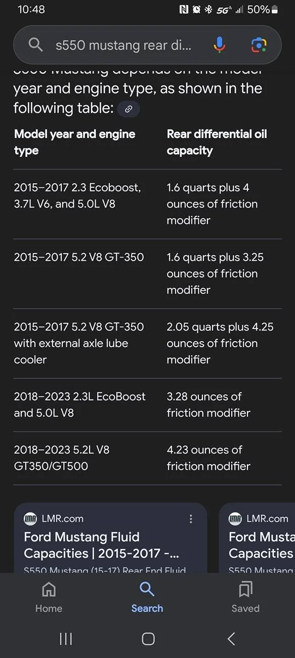

Thanks! Do you remember the exact amount of fluid you ran by chance? I'm right at 1.9qts to the bottom of the fill plug. Tried to go off of this chart but I don't see how .2 qts could cause any significant issues.

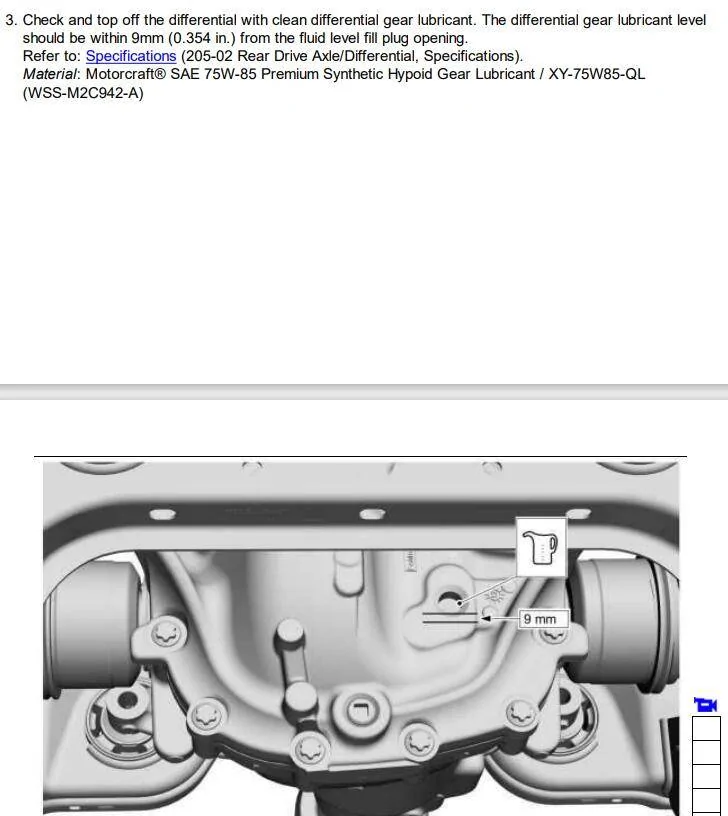

I filled mine to a few mm below the fill plug and topped it up with FM. I didn’t use the whole tube of FM to do it but it was enough to shut it up.
I’ve read somewhere that proper fill level for these cars is 8 or 9mm below the plug.
'Within 9mm' :like:

Dropped diff fluid again (it was clean). Had put about 500 miles on that fluid. Replaced with the same easy fill amsoil 75w-90 1.6qts (which contains friction modifier) but this time I added the 3.25 oz's. of Ford friction modifier.
This immediatly resolved the growling noise. I have put around 400 miles since and am confident there are no other issues. I apprciate the input. Hope this saves someone some time and money in the future.
