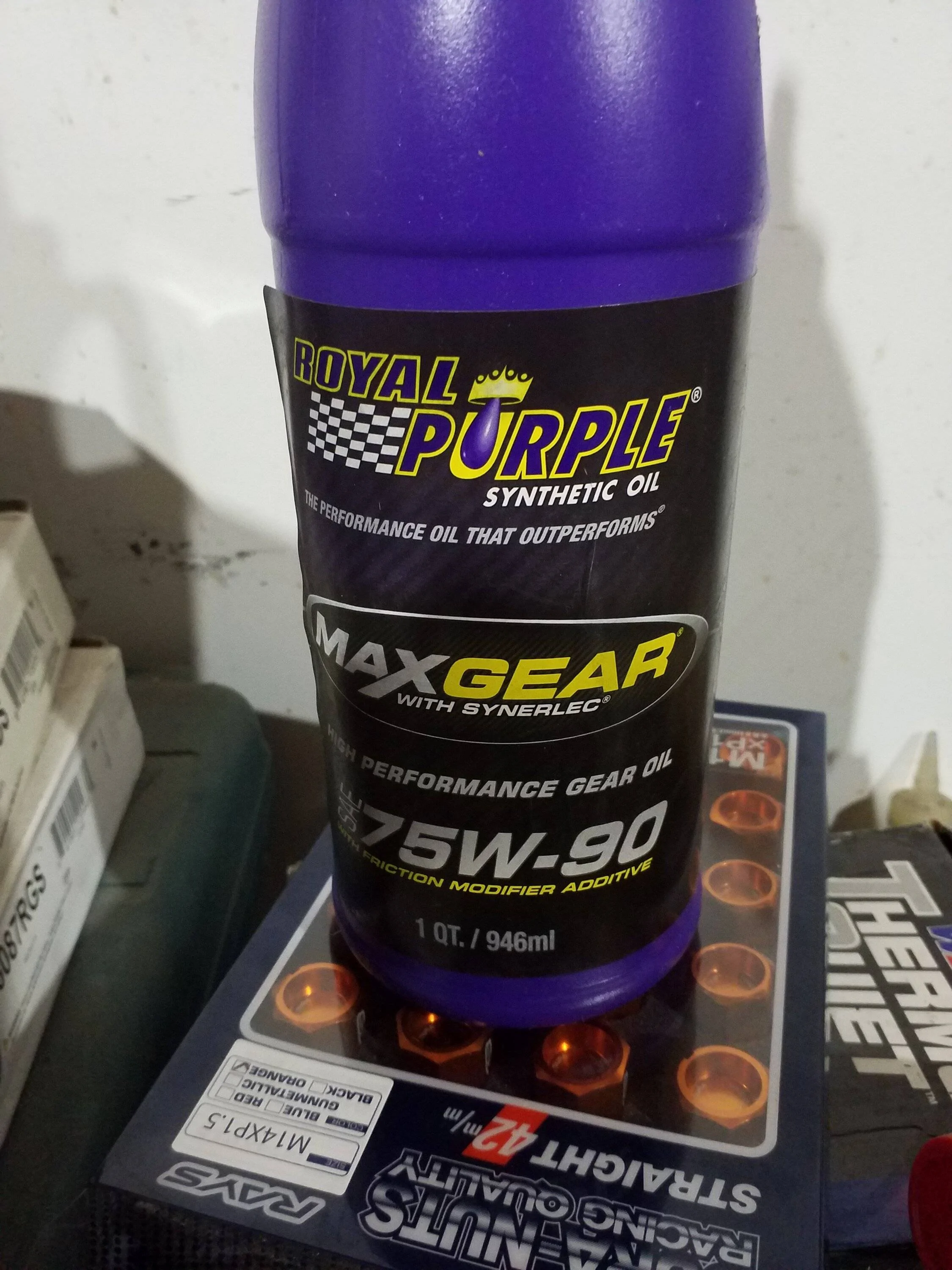

I went with the Royal Purple 75 90, which includes the additives that Ford recommends. I have had no issues with this while using B&G in the mt82.
