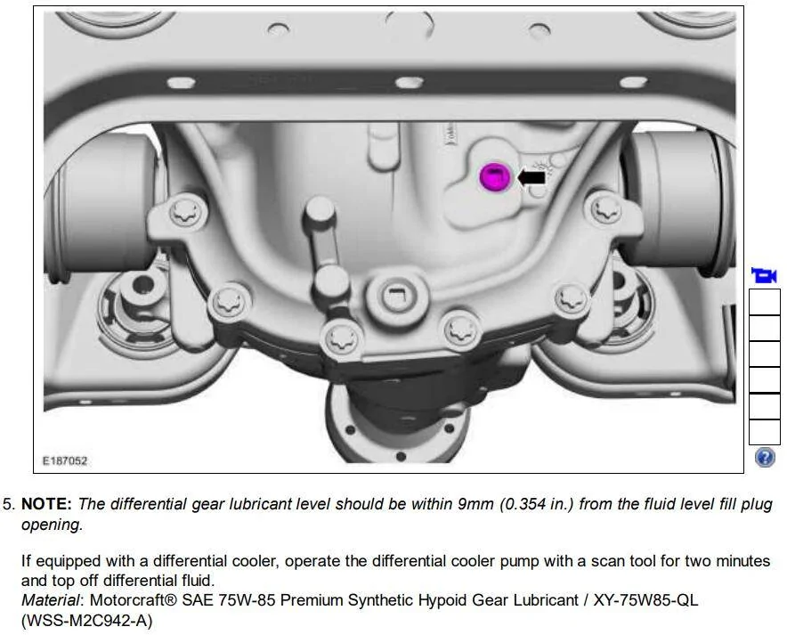

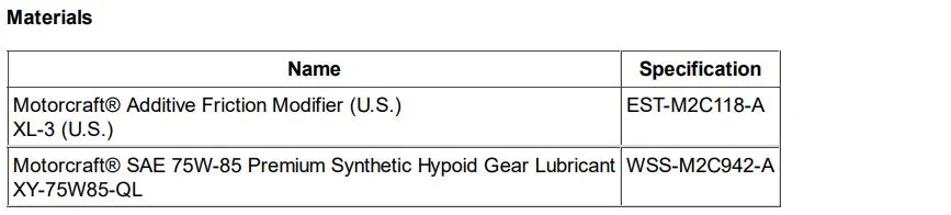

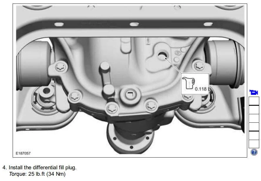

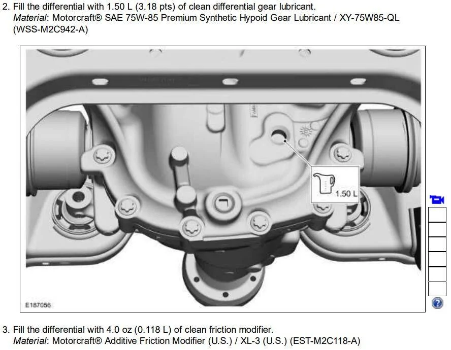

hello again thanks for the tip - I had better slim down.
yes, if you could check please that would be great. I need to track down the friction reducing fluid
I almost forgot … :
WD :like:
