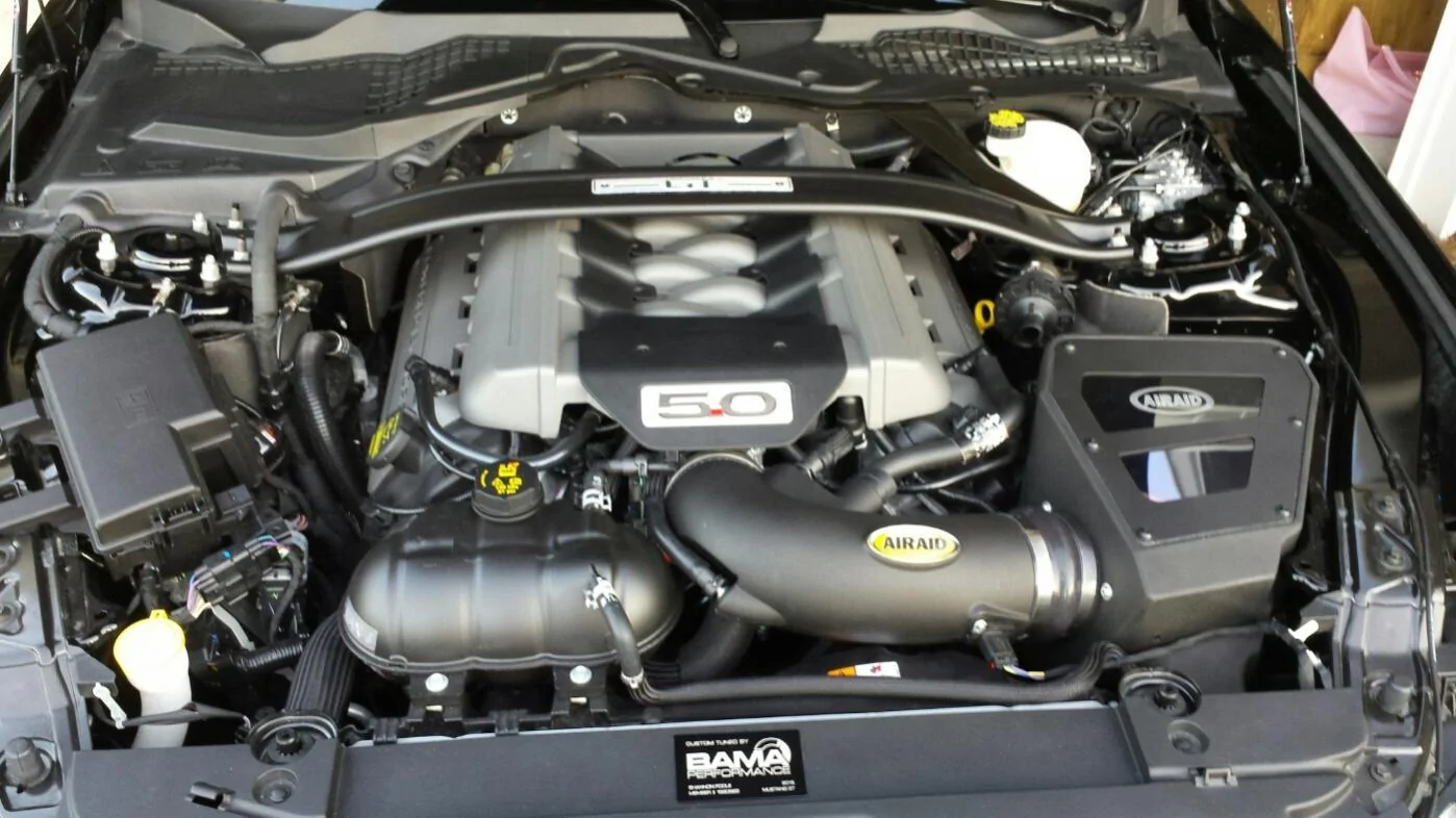

Here you go...
Opened 7 more holes with dremmel tool.
Left the four down untouched, so water do not flow in.

There's a filter so no bugs or big debris is going to get into the engine; that's why there's a filter.
The filter will certainly need to be changed more often though as more fine dust etc is going to get in now.

I'm considering doing what Duttch did and drop in a k&n filter. Did you notice any difference Duttch?
yes, a bit even with my stock air filter at that time.
have a jlt cai now and custom tune.
the more air in the more out :)

Here you go...
I did this this morning, I have a JLT. Before I was seeing between 3-4 degrees difference between ambient at 60mph, today it was between 2-3, so I would say that it did help.

I did this as well a couple weeks ago, just couldn't find the thread....
Now I'm hitting temps as low as a two degree difference, which in FL is pretty good.

I'll be doing this soon when I get my Airaid CAI, anyone know if the Boxed version has an average lower temperature or does the plastic box not make a difference?

Moving, I average 4-5 degrees difference between IAT and ambient temperatures with the airaid. And my filter is just as clean as it was the day I installed.
