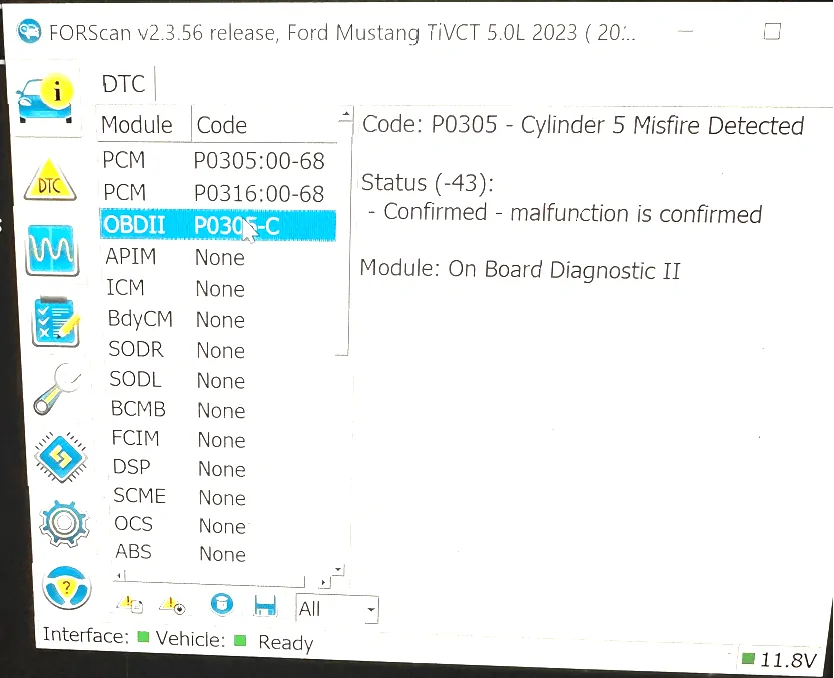

If you are handy with computers there is a free software called ForScan that gives you dealer level access to your car's systems.

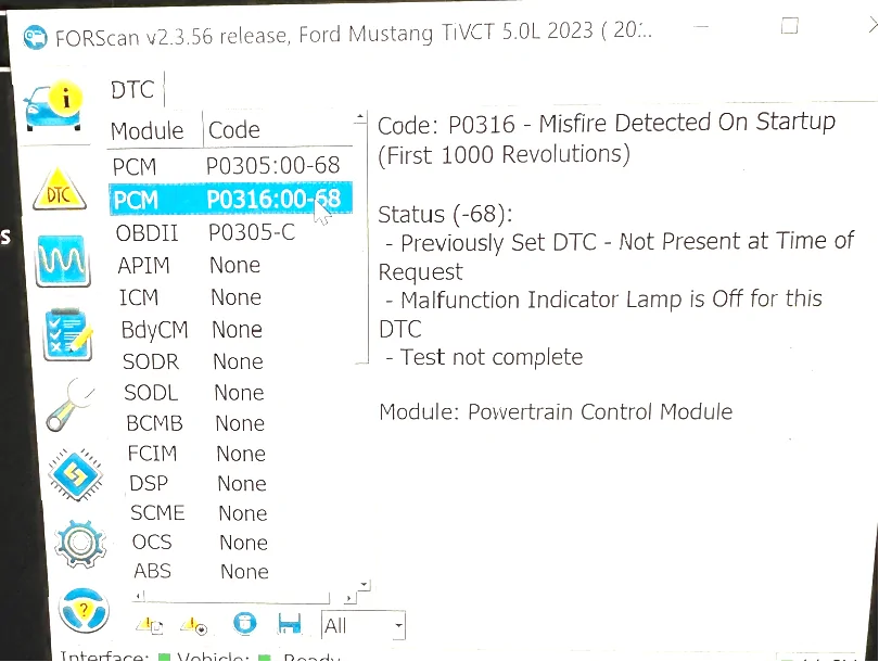

I took your advice and used Forscan on a laptop. The first two codes on the "PCM" modules do show "Previously set DTC - not present at time of request"
The third code, on the OBDII module just says that the P0305 "Malfunction is confirmed".

"Malfunction is confirmed" is when it turned the light on.

I appreciate your help. I won't worry about it unless something new pops up.

Certain codes are stored permanently or semi permanently.....this doesn't mean the car still has the error. If the light went off, the code is no longer active. K4xfd has provided good advice. I always keep a code reader and do my own diagnostics. I am showing a catalyst code currently; came on yesterday after filling up. I had the code before ( I am Roush supercharged) and dealer noted it and cleared code. They told me when the cat's really go bad, they already have it noted and will replace under warranty. As a side note, missfires can happen depending on fuel and circumstances and other varioius reasons. The sensors are doing their job in your car.
