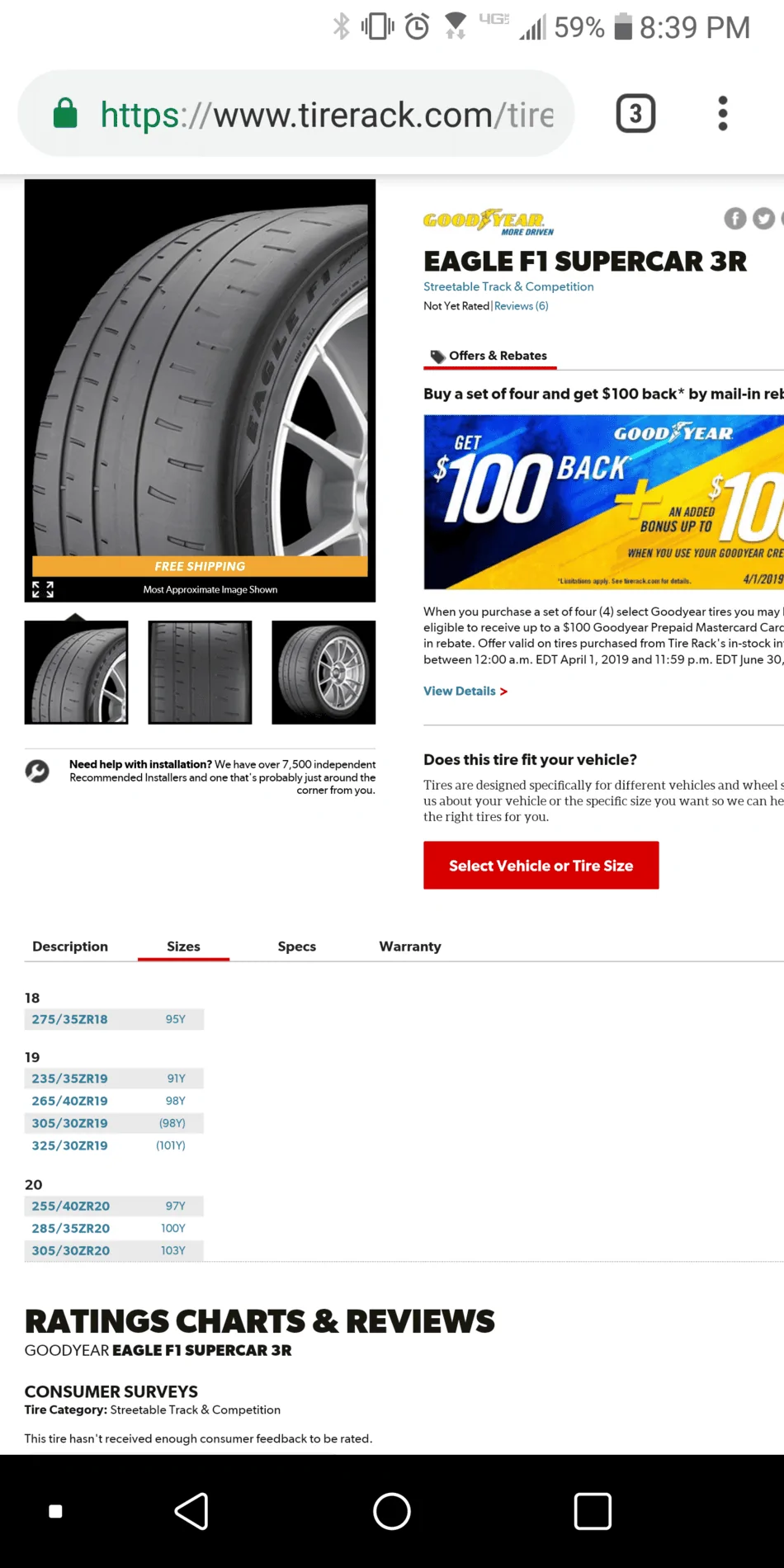

What the? When did they come out with that? It's been nothing but 20's since release. This is great, good to have options
Yes for the regular Supercar 3, not the 3R. The ZL1 1LE OEM sizes are 19".
That may have been my mistake, I forgot they came out with an extreme version for the zl1 1le
