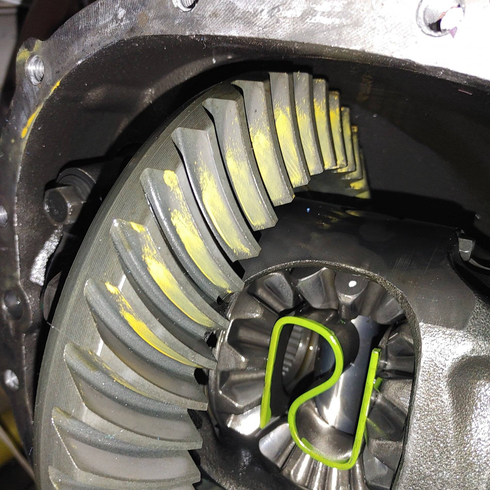

Noone? Anyways, gears replaced. Pattern can't get better than that. Also replaced the pinion seal, pinion bearing, axle seals, axle bearings. Nothing wrong with the old ones, but what the hell haha.

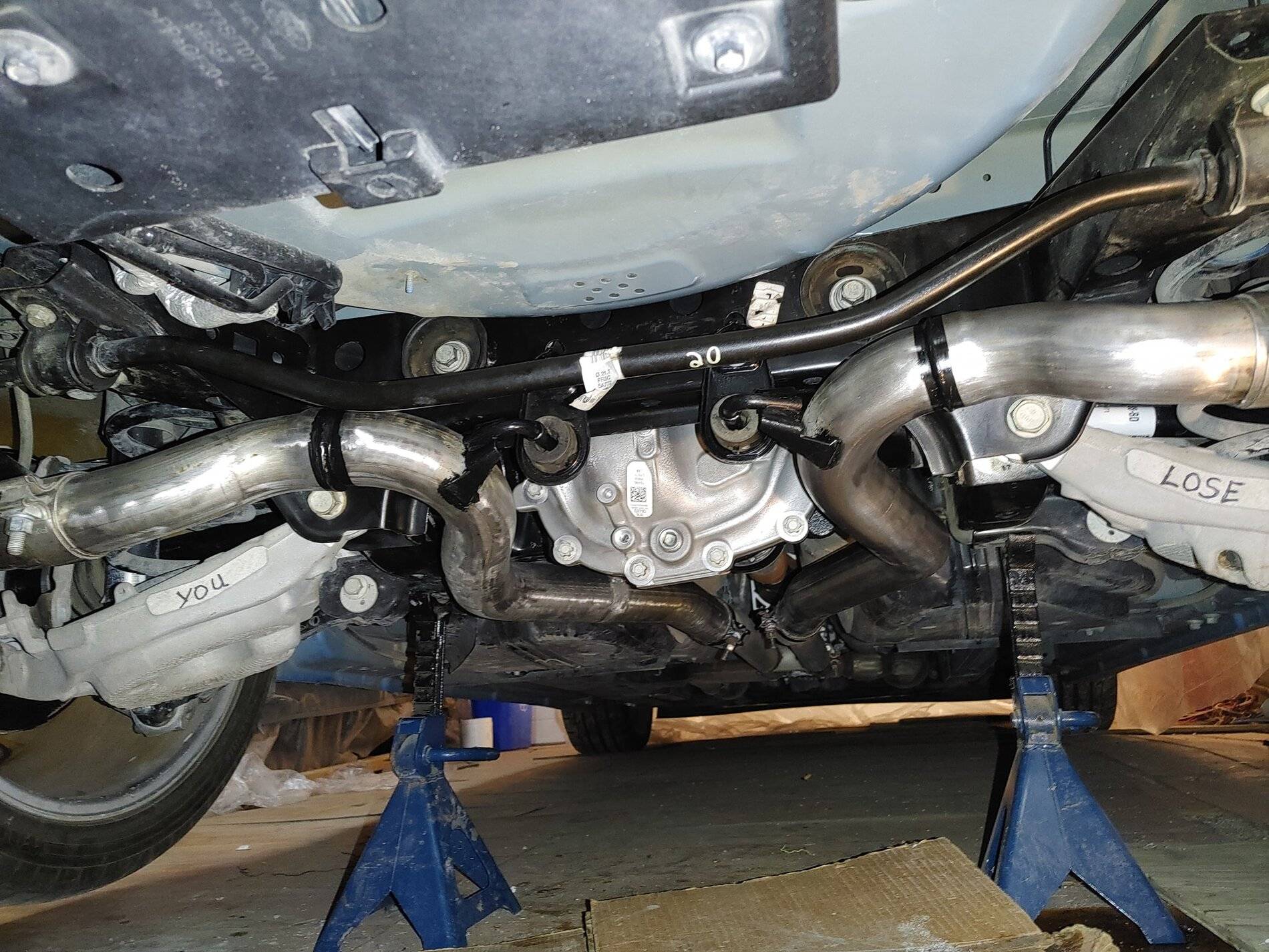

All buttoned up. Everything is torqued to factory specs. Now to wait till spring to try out the new gears haha. All in all it wasn't that bad. Hardest part was setting up the gears. But even that was a breeze. Love the satisfaction of the DIY instals.

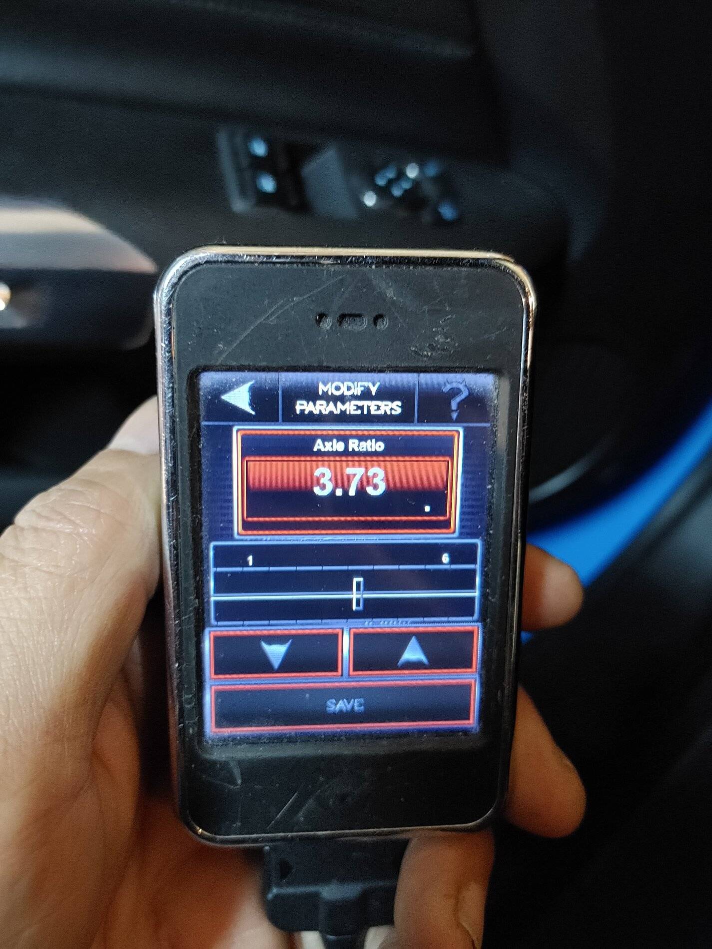

Yeah I can just change the gear ratio on my handheld. BTW, was curious as what would FORD & other company's would quote me. FORD almost 2k to do it. Yeah, nah. Other diff companies wouldn't touch it cause they said 'never done one before' haha. I've done various gear swaps before. Dodge 8.75 / Chevy 10-12 bolts / Ford 9" / Dana 60's. They all the same, well except for the Dana 60. That was truly a pain in the ass haha.

Yep. Can change the ratio on my device.
