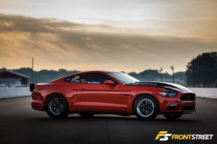

One question, in your 11.30 video what wheels and tire are u running and what springs too, the stance of your car is perfect
RoadCone
RoadCone
Dec 28, 2016
71
1,087
994
Ohio
2016 Competition Orange PP
It’s the Project 6GR wheels. 10” fronts and 11” rears. I was running a 325 Mt SS drag radial and 19” rims. Not the most optimal for drag racing.
Thank you
