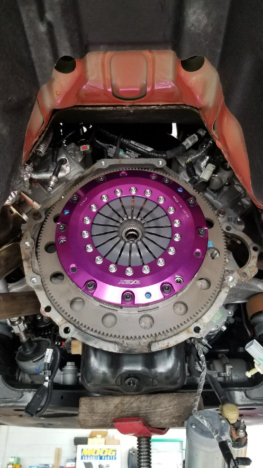

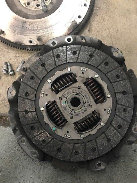

The Exedy is in... Stock Clutch and flywheel weight 47.8lbs. Exedy 38.9.
That is a 9lb loss.

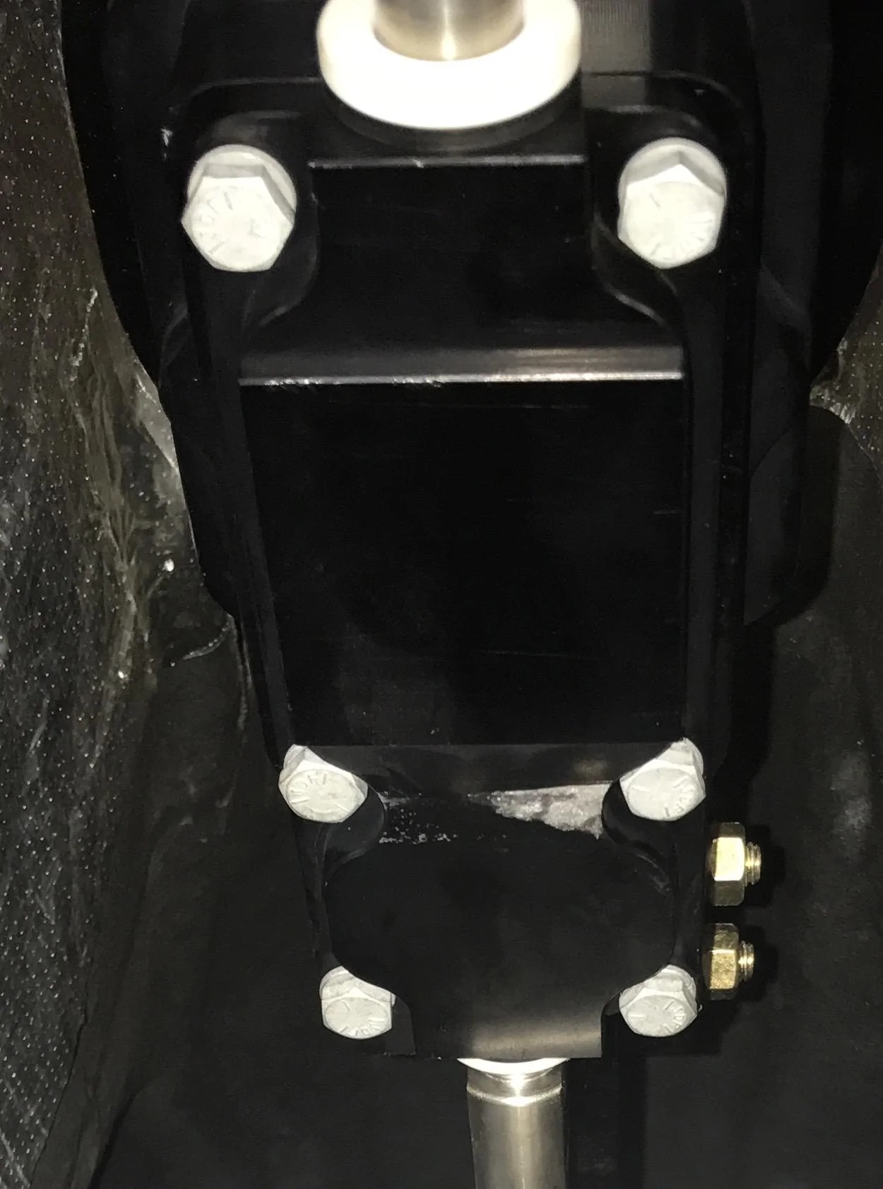

Also the bottom of the shifter was making contact with the DS loop, maybe one of those knock gremlins.
The clutch is more On/Off. I stalled it out a couple of times or chirp the tires off a light. Here is the Awesome news, the motor is so much smoother in the revs! Night and day to me. I compare it being like a circular saw and now it is a buzz saw. Placebo effect?? I don't think so.
The WOT box is installed and we set it to 5500. Sounds awesome on it and I may try [MENTION=16083]GTBOB[/MENTION] ET Street R Biased ply. If I can hit it hard and hook, it will be a Huge difference!
I have included pics also for comments and your viewing pleasure.
