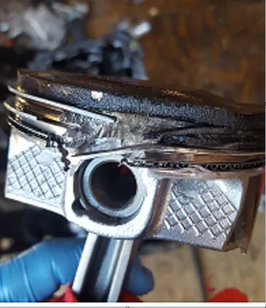

That's all I needed to hear Dominant1. Something happened for my cat to collapse like that. Keep trying to wrap my mind around what caused it and preparing for the worse smh. Hopefully I'll find out tomorrow

Hoping for something simple but it never is smh. I herd a couple people having issues with the 18intake but I dont see it causing misfire codes to pop up

My drivers side Stainless Power Cat looked just like that. When I took my engine apart my #5 piston looked like this. Car still ran sorta ok, just smoked a lot.

Wow just found it piston 8 is done smh. They just did a compression test on it smfh. FML

Your first post mentioned turning the boost up to 12 pounds. Did you retune for the added boost? Just curious. Sorry to hear of the problem, hope you got cash saved up.

Yeah mine left my tuner's shop with 13lbs dyno tuned by my tuner so i don't think i will have and issue....

Rough man. Sucks when things go wrong. The only positive I can say is, relatively speaking, you can get a factory shortblock pretty cheap.
