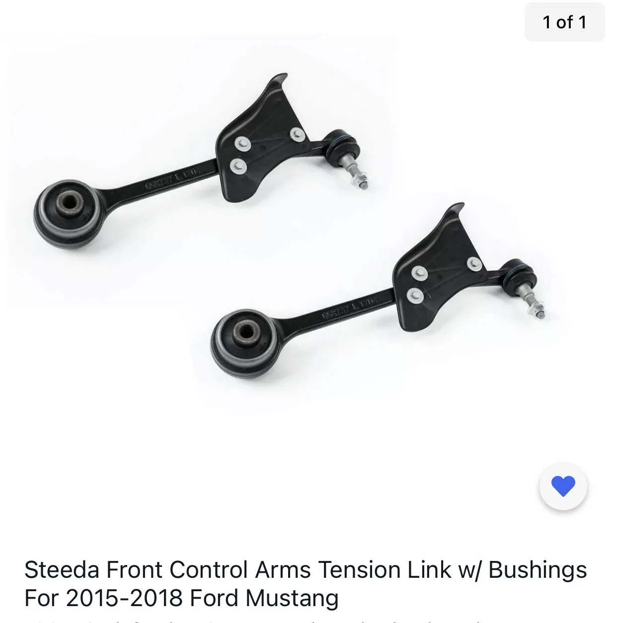

I tried to get a video but it’s hard to hear. But In another post “Front end suspension clunking” someone replied with having the same problem and it being a ball joint in the tension link. I ordered new steeda tension links so hopefully that’s the issue. If that is the fix I’m happy but I would expect the OEM tension links to last more than 20k.

@86pagt whats the tension link?
I know for certain mine is brakes. Just can’t for the life of me figure out how. I’m putting all new Z26 pads in this weekend and see what happens.

The forward front control arm…I’m going to try it…. I had thought about new pads also but going to try these since I ordered them
I replaced both front tension links and the my clunk is gone I hope your successful with your brake pads
