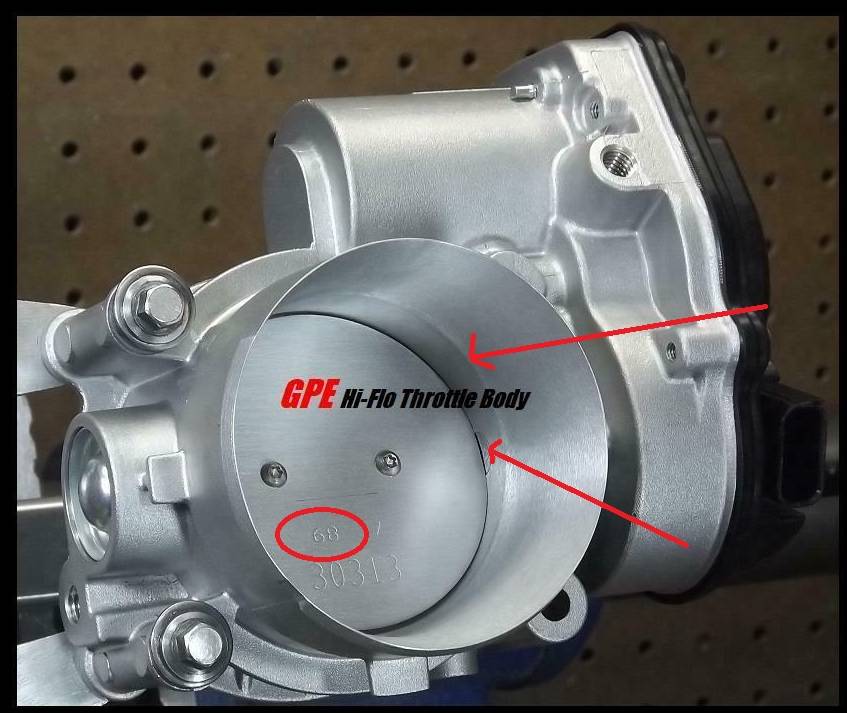

Questions?
Stock TB inner diameter step
Image from vendor ebay page.

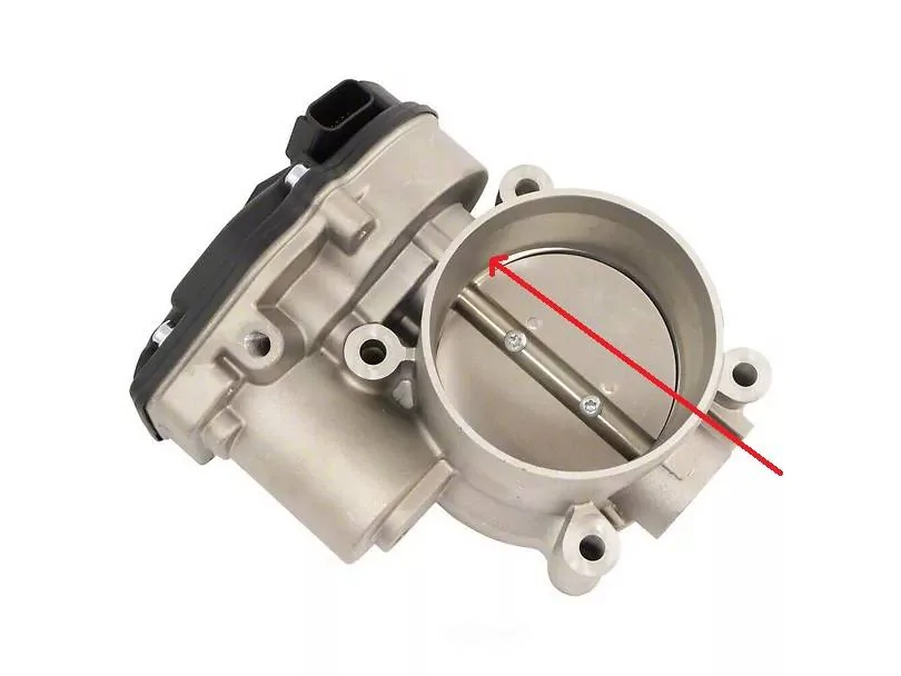

Looks like you can still see the inner dia. step(or maybe the new 77mm dia.)? Stamped on the plate "68". Is this indicating 68mm (same as stock)? Also looks like the front half of the butterfly valve shaft has been removed. Will that affect the strength of the shaft and the amount of thread engagement of the tiny screws? I assume that shouldn't be an issue?
Can someone measure the diameter of the inner bore where the plate is?

Excellent observation; would be good to know. If the center of the TB is unchanged the 80mm TB may be a better way to go.
