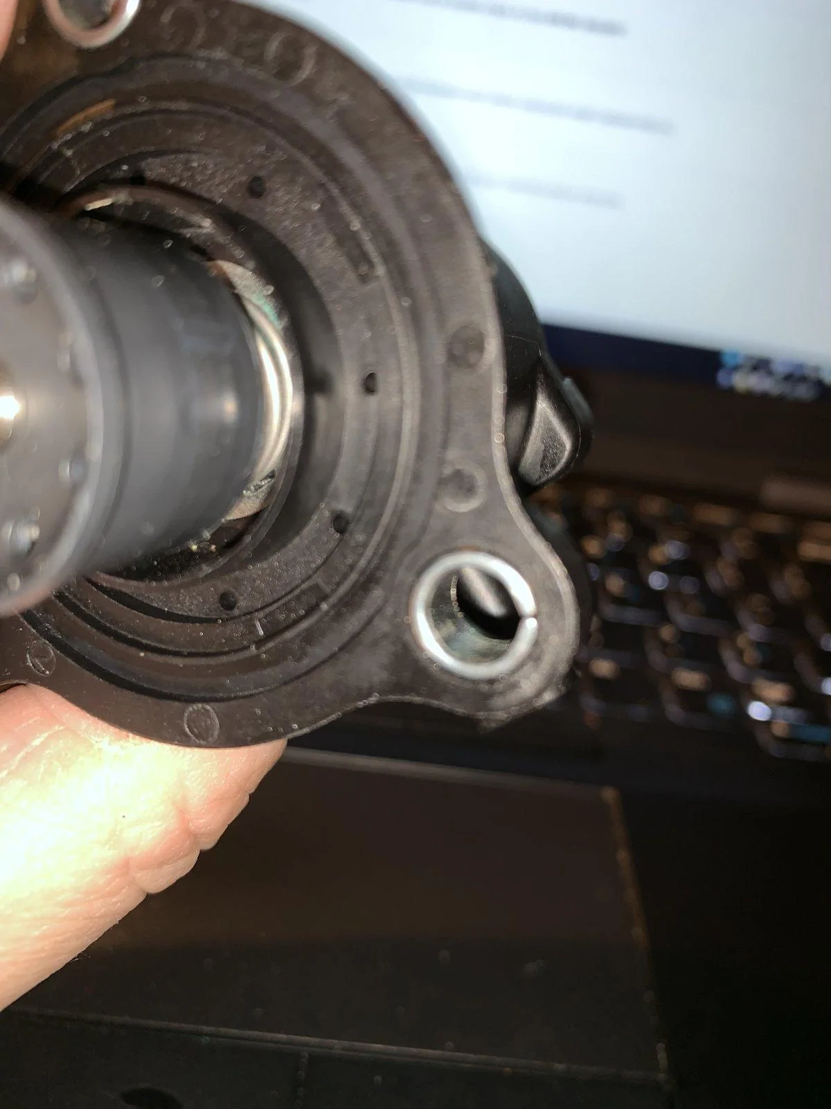

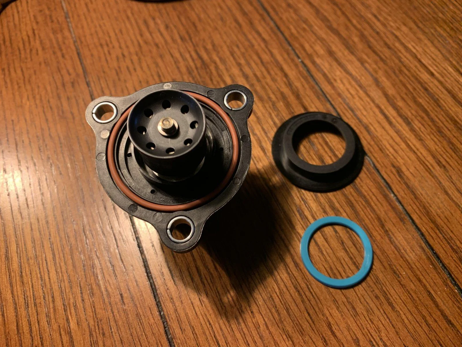

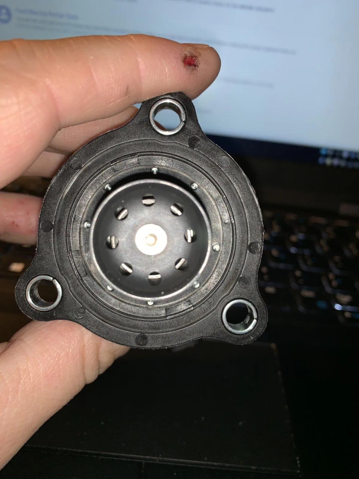

For those familiar with the 15-18 BOV, the attached images will show the difference.

the short version is that the big valve plunger in the center doesnt just pop out like in the previous versions. its hard attached to the metal pin that activates it.
