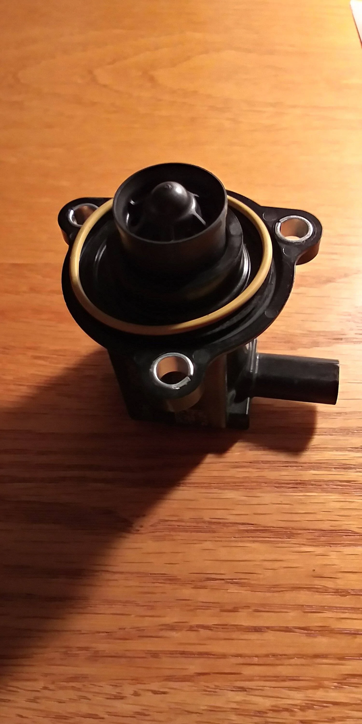

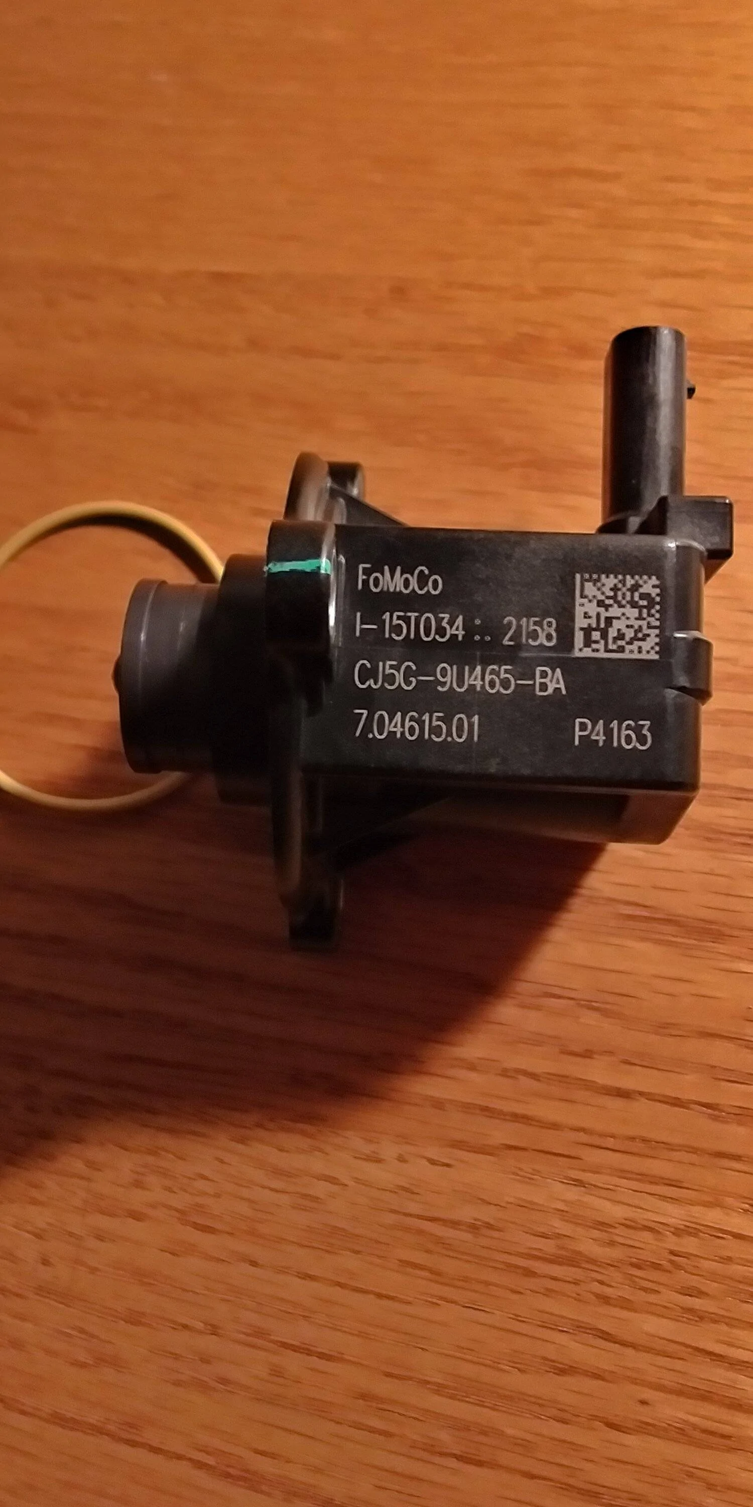

So I removed my bypass valve & have a nifty new DV+ but I can't figure out how to disassemble the d@mn OE diverter. The OE part is CJ5G-9U465-BA (with the yellow O-Ring). I can get the center plunger out but that's it. The DV+ doesn't fit flush against the yellow O-Ring with just the plunger removed. I've pulled & pulled on the plunger collar but can't get anything else to come apart. What's the trick?

I had to grab the outer edge of the collar with pliers where the center plunger fit and squeeze the collar a bit to egg shape it while barely rotating it to break the plastic of the collar loose from the main housing, then it all went together as the instruction state. Just don't squeeze too much to crack the collar.

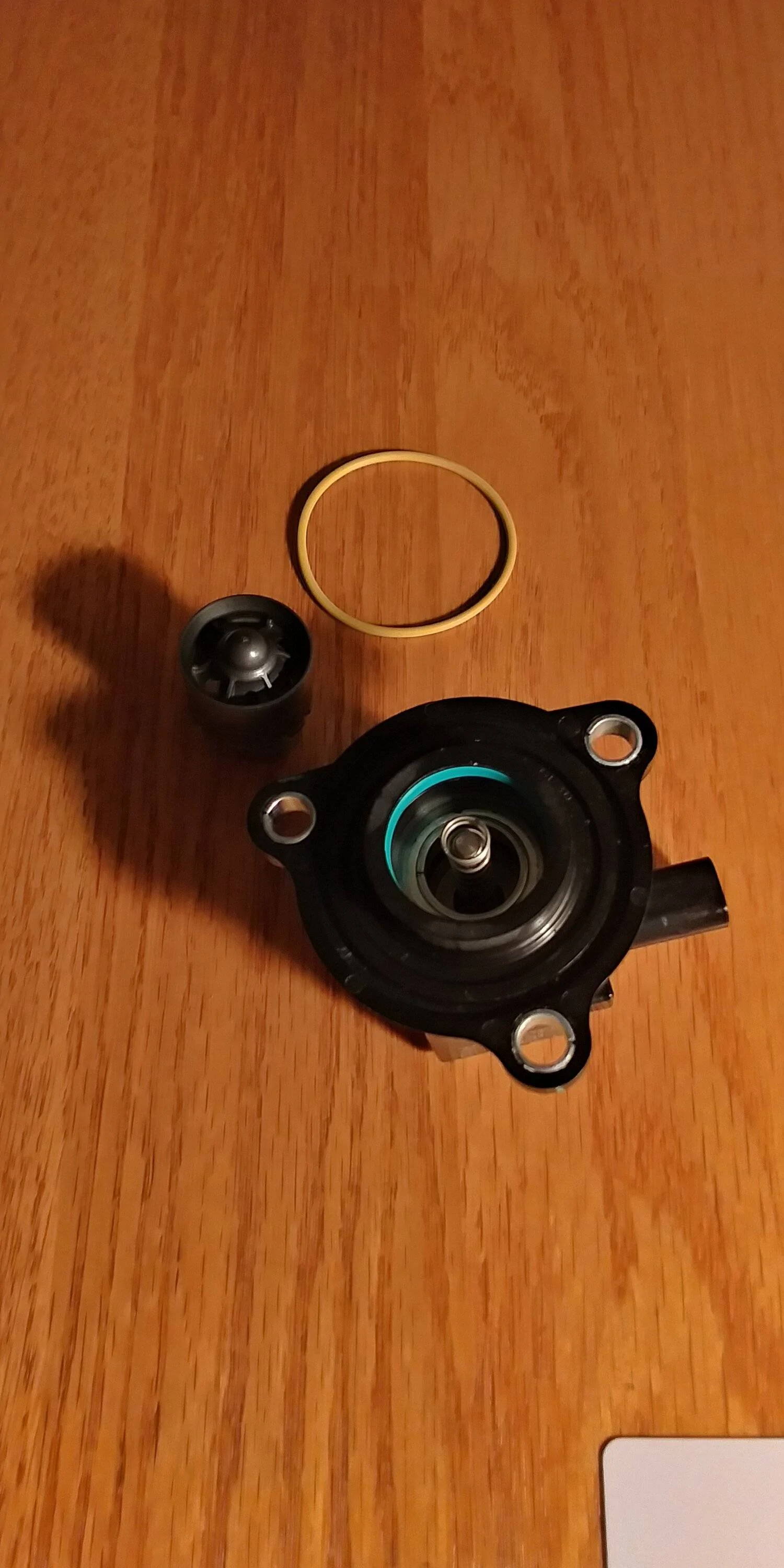

Thanks. I finally got it separated. It wasn't easy and took a substantial amount of force. When it finally popped free it flew across the room. I trashed the Teflon diaphragm in the process. Oh well. But I have the valve ready to re-install.
