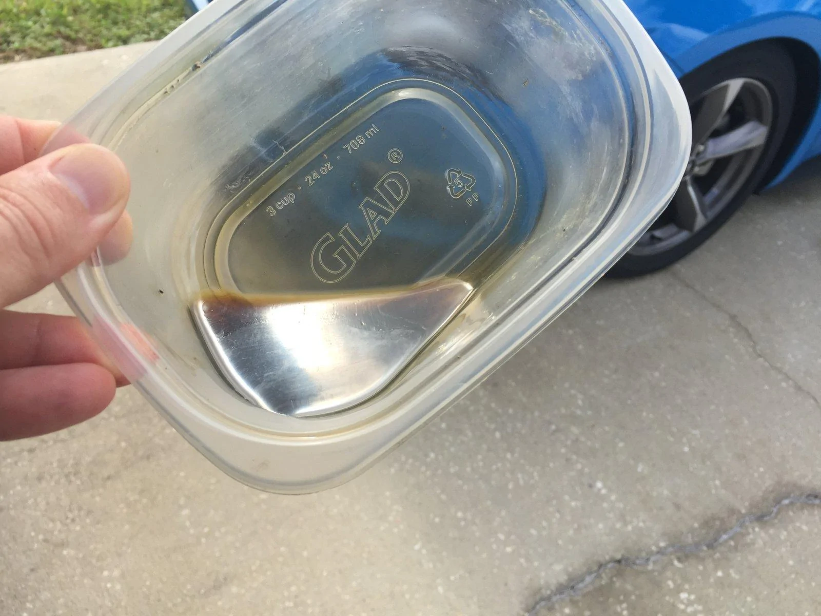

wes936
Jul 8, 2018
27
Palm Bay Florida
2017 Ford Mustang Grabber Blue EB 6MT
This is what I get every 2000 miles, about 4 ounces or so. Have let it sit for a few days and it does not separate. Personally I’m glad this stuff is not going into my intake.
