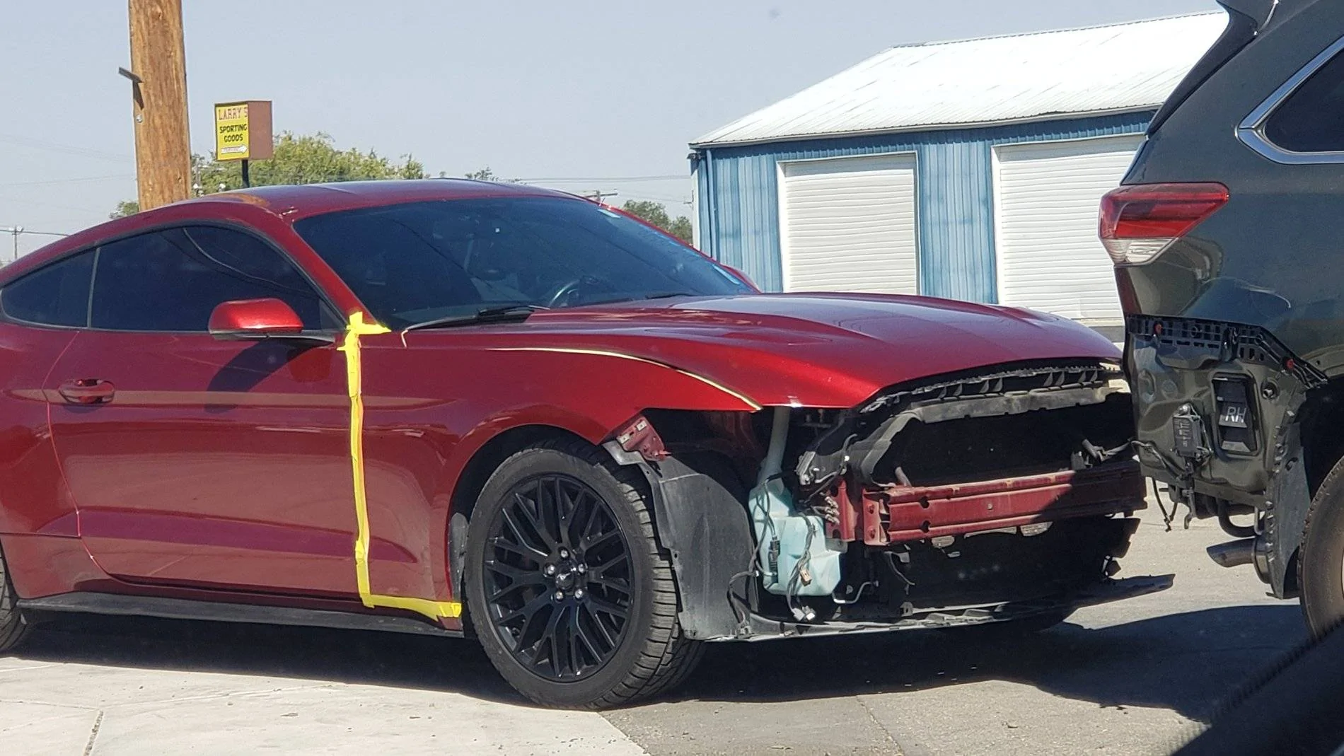

Dropped my car off Monday morning. They said it should be about 3-4 days. They're also replacing the hood vents, as mine are cracking. Drove by today and see this. Why so much disassemble for hood? Is it to blend paint into the fenders?
