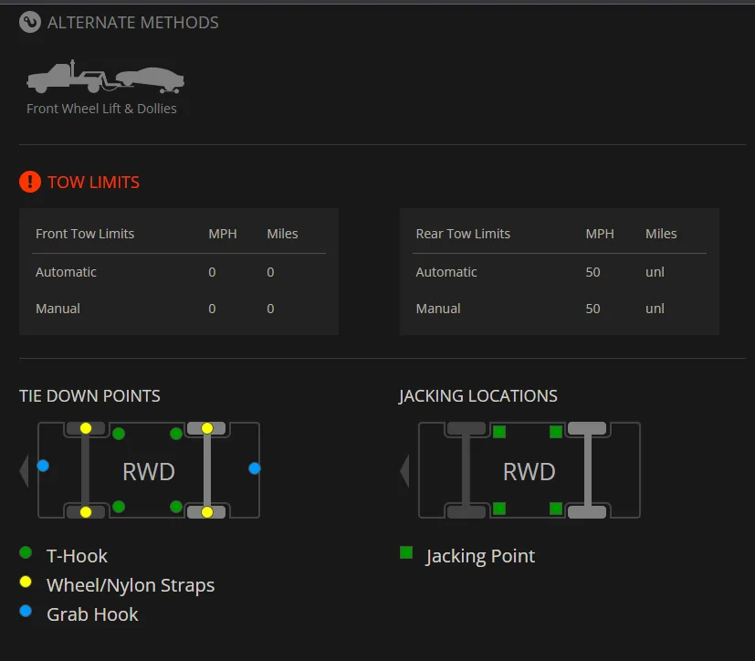

I towed cars for 23 years. Your car already has the T slots for winching the car up the flatbed. You can see them behind the front tires, and in front of the rear tires. As long as you are using T hooks, or Mini J hooks in those slots, nothing else is needed. On edit: Chart added below.

Awesome. Thanks Lloyd! Keeping a copy of this in the glove box.
