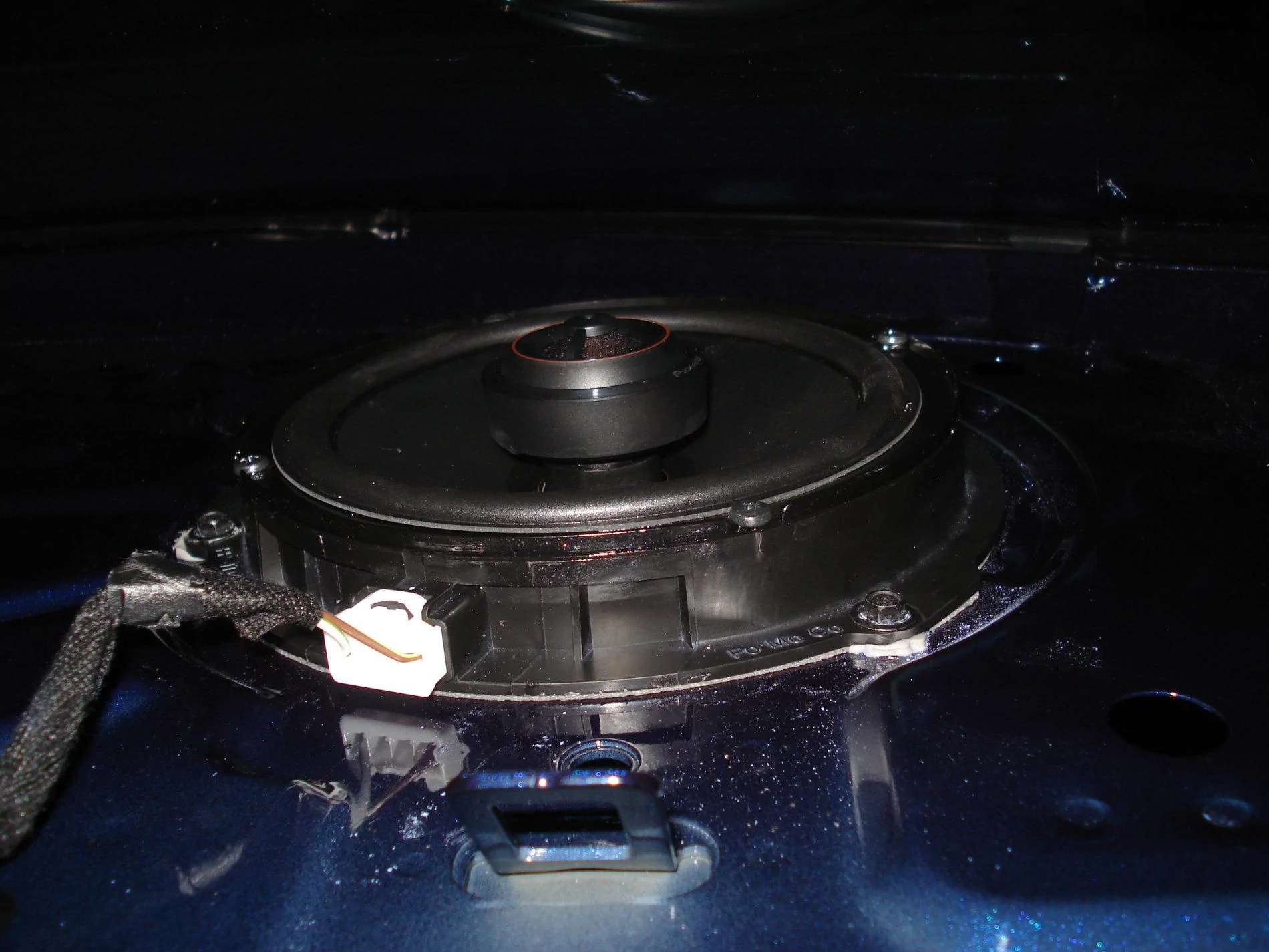

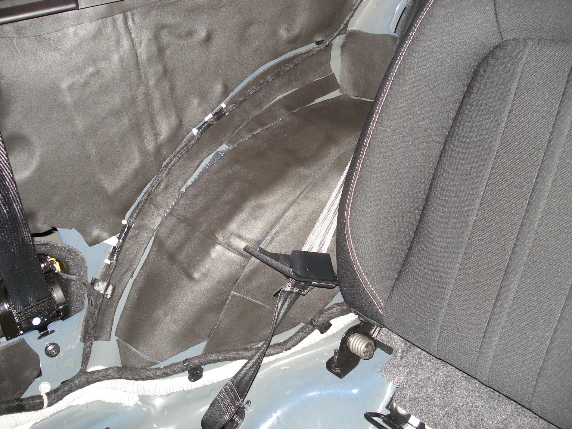

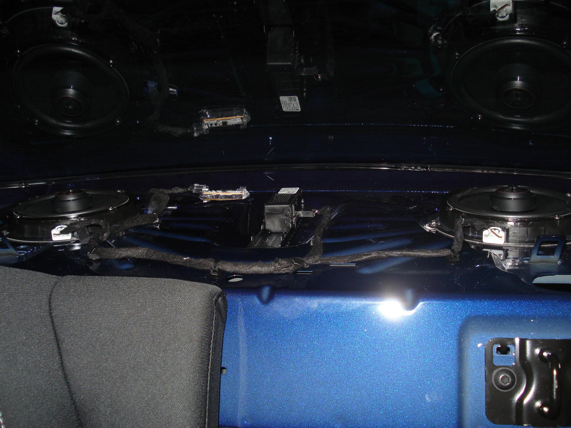

After removing all the paneling from the rear, along with the side panels over the fender wells, it became clear I would do some sound deadening before putting everything back.

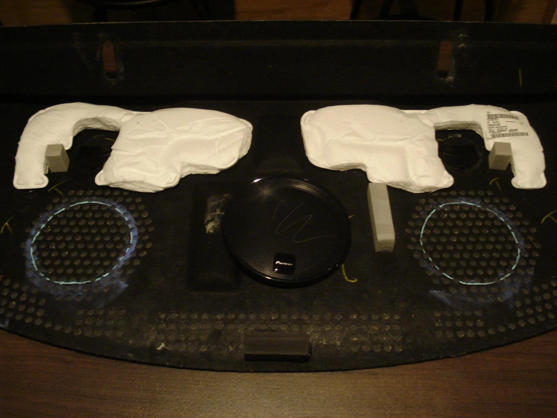

I also realized I needed a proper way to figure out how to deal with my rear deck speakers with elevated adjustable tweeters. I needed to cut some holes in the rear deck cover, and install some dome shaped speaker grills so the tweeters didn't have any obstruction. A disappointment is the 2-way rear speakers do not come with speaker grills. However, the front component speaker kit does come with speaker grills. Voila!!!
To make sure the holes I cut in the rear deck cover were correct, I decided to do this first before even removing the old speakers. To mark my holes to be perfectly centered over the speakers, I took some blue chalk-line chalk, and saturated the foam rings on the factory speakers. I re-installed the rear deck cover, and smacked down on it until it hit the tops of the factory speakers. Once removed, it left a perfect chalk ring where the factory speakers were. I then took a small modelling paint brush, and painted some blue paint around the inside edge to mark exactly where I had to cut. Here ya go!

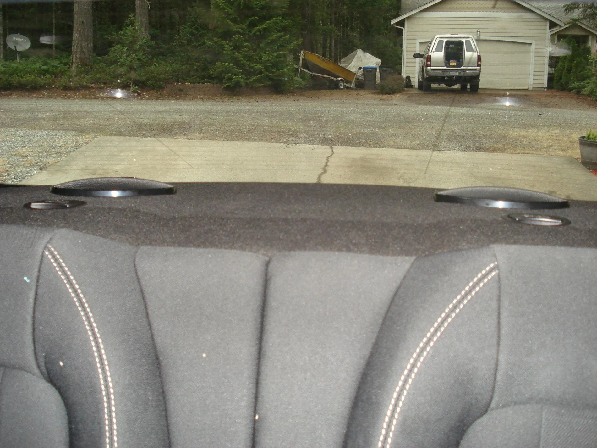

Next was the speaker installation. This part was easy but time consuming, because I decided I wanted to cannibalize the factory speakers for the rings and the factory plug and wiring. There's lots of YouTube vids on how to do this. I really spent some time on this, because these speakers are fairly pricey at $120 a pair. So, I wanted to do it right. I installed them into the modified rings with some black RTV sealant to prevent rattling, with the screws provided. I then bought some black closed cell foam weather stripping for rings around the upper edges to focus the sound dispersion through the deck cover.

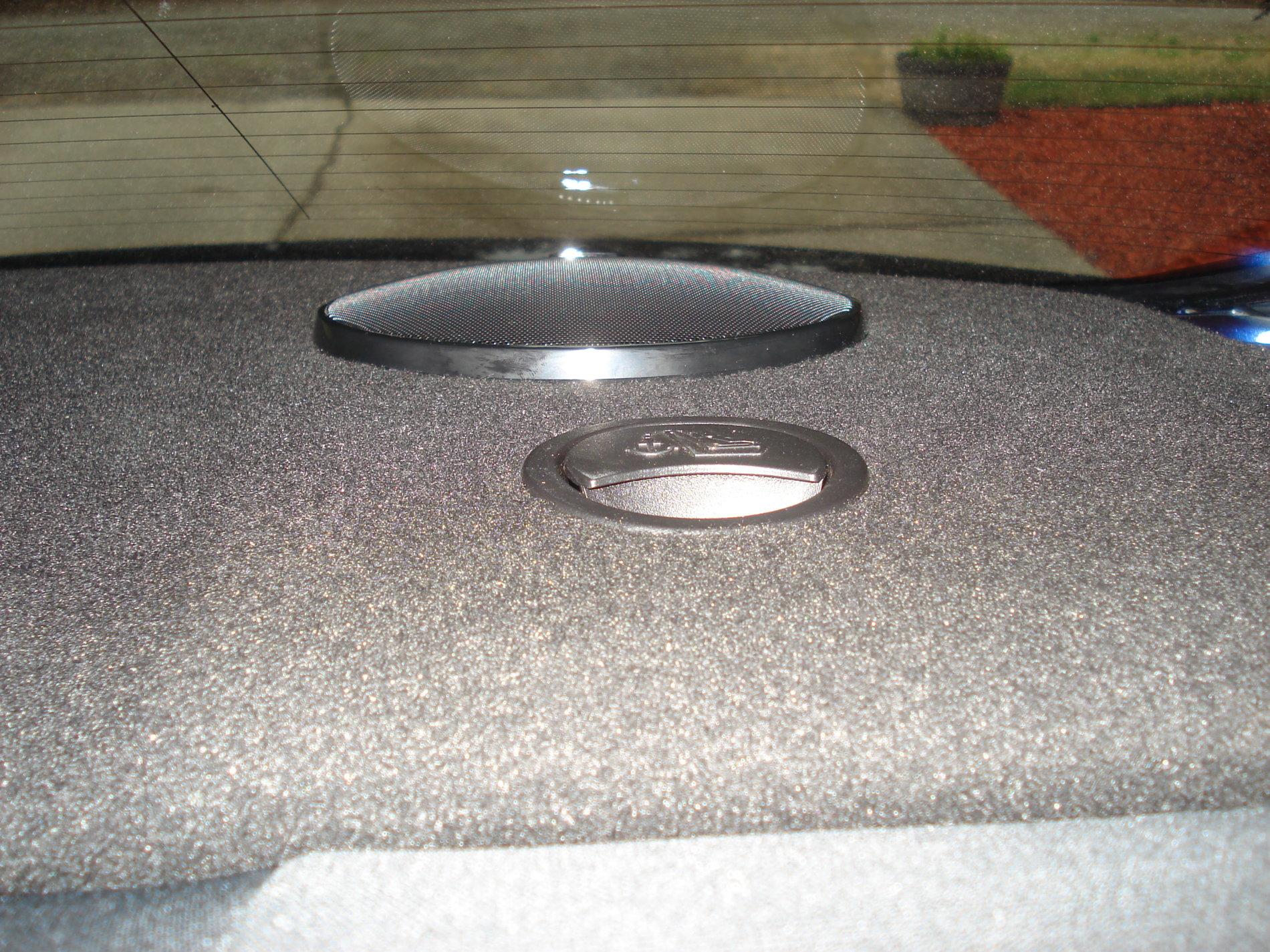

After installation, I realized the I had to make sure there would never be any issues with the new speaker grills on the rear deck. So, I installed the speaker grills with the supplied screws, but cut them off short with my Dremel since they'll impact the speakers below, and ran some black RTV silicon around the inside edges of the holes to prevent that cheap cardboard like rear deck from fraying or absorbing moisture. Those speaker grills are a permanent install now. But, I think they look GREAT and really set off the fact that this is an upgraded stereo.

Now, on the inner door panel where the speaker mounts, I used some Uxcell 5mm foam to help deaden more sound. I also used Uxcell foam over the rear fender wells, and used some Loctite expanding spray foam in the C-pillars to stop the rattle I had from the right rear C-pillar plastic paneling around the side curtain air bag.
