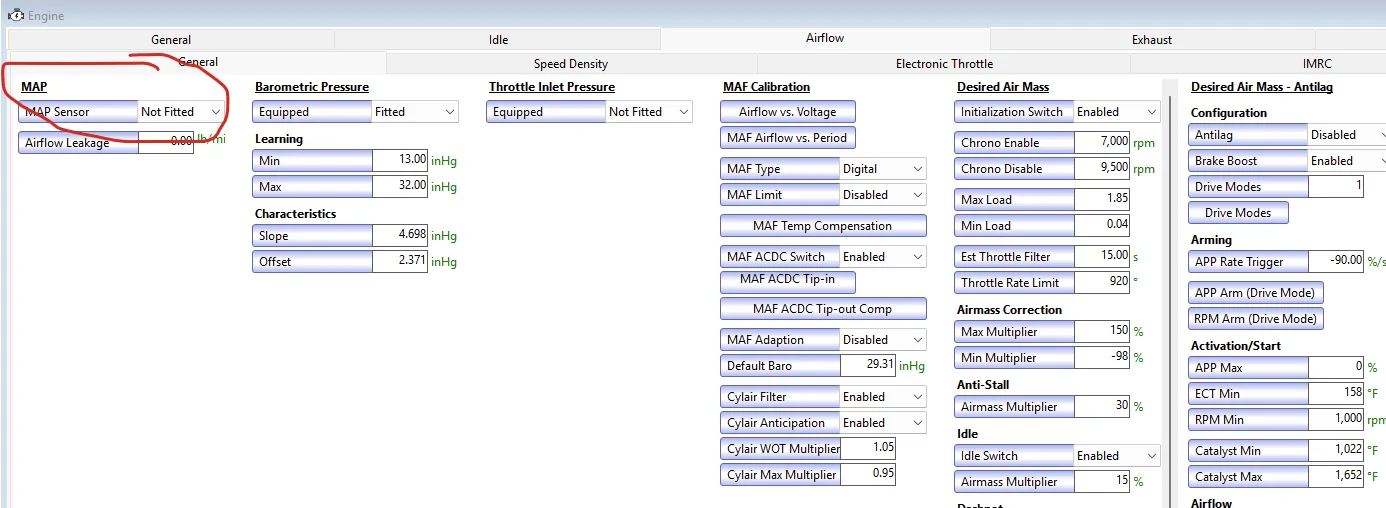

I heard there is a way to do this on HP tuners but would this only be with a Custom OS? I am self tuned on HP tuners. I have PCMTec but have not used it. I'd love any input and I will also share anything I learn here.
I had plumbed a GM map sensor into my AC pressure circuit and logged data in some attempt to tune my VE in the past. I'm not sure how the conversion harness plumbs in the MAP sensor. I don't believe the stock OS is going to be able to be edited directly to see a real MAP sensor (Rather than its inferred MAP), regardless of where it is wired.

I suspect the MAF is hard-coded into the Mustang logic, so it wouldn’t be switchable in the tuning even though there is a map sensor switch.

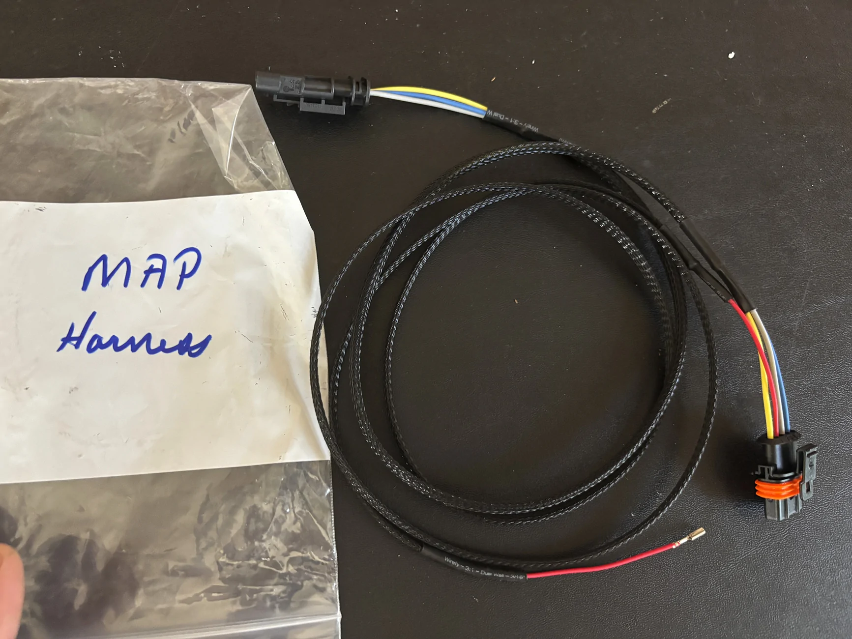

Have you confirmed VMP has this harness? I don't see it on their site or anywhere. Here is the harness I received. Not sure where the red pin/power source is supposed to come from. With my GM MAP sensor I had to use a 5V regulator. I believe Roush uses Ford MAP sensors.
I confirmed Shoemaker stopped selling their kit in Instagram comments to the post where he announced the kit (which also included sensor and MAF bock off) He simply said maybe we'll offer it again. Strange, what is he using for his customers? The harness I got was suppsoed to be Shoemaker's but a full solution would connect to the MAF sensor with a harness to a new temperature sensor since our cars get the temp from the MAF otherwise. Harness to the IRMC gives me the possibility of using a Roush OS I think.

The VMP harness appears to just use the MCT temp from the MAP sensor (T-MAP) to get the signal into the PCM. It's not a SD conversion by any stretch. It even has a wire for logging boost because it doesn't feed into the PCM.
I'm not sure how the Shoemaker harness works or what it even connects to. There are no details about how it's supposed to work or what OS it goes with.
At the moment, the lead case seems to be the Roush OS. You can pick a stock Roush OS from PCMTec's library and install it in other cars by merging the VIN and OSID. The Roush harness needed is part number 1318-12B579. It requires a TOP and correct MAP sensor, which I can get part numbers for. For NA, TOP and MAP are technically the same thing but you can't just leave one out because the logic will look for both. You might need an MCT sensor for NA as well but it will be the same as IAT.
If anyone knows how to do this with the stock MAF OS, I'd love to hear how. I believe it's hard-coded though. Maybe a patch could switch it from MAFS to SPDEN. Someone was posting a while back about being able to make logic changes and I don't think this is a difficult one. Who remembers what forum member that was?
