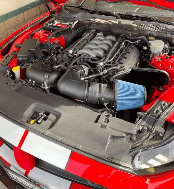

To be completely honest the no tune required intakes are no good. The maf sensors are super sensitive on these cars. I had the same no tune pmas on my car and the car was running a little off, didn't see any power gains. It felt like the car lost torque and was just sluggish. I put the stock cai back on and the car felt 10x better and stronger. You need a proper tune in order to see power gains. Since you added the gen 3 manifold pairing that with the PMAS and a tune you will definitely see nice power gains. I had the same setup with E85 when my car was naturally aspirated, you lose a little torque but man does it pull better all the way to 7500 rpm.
