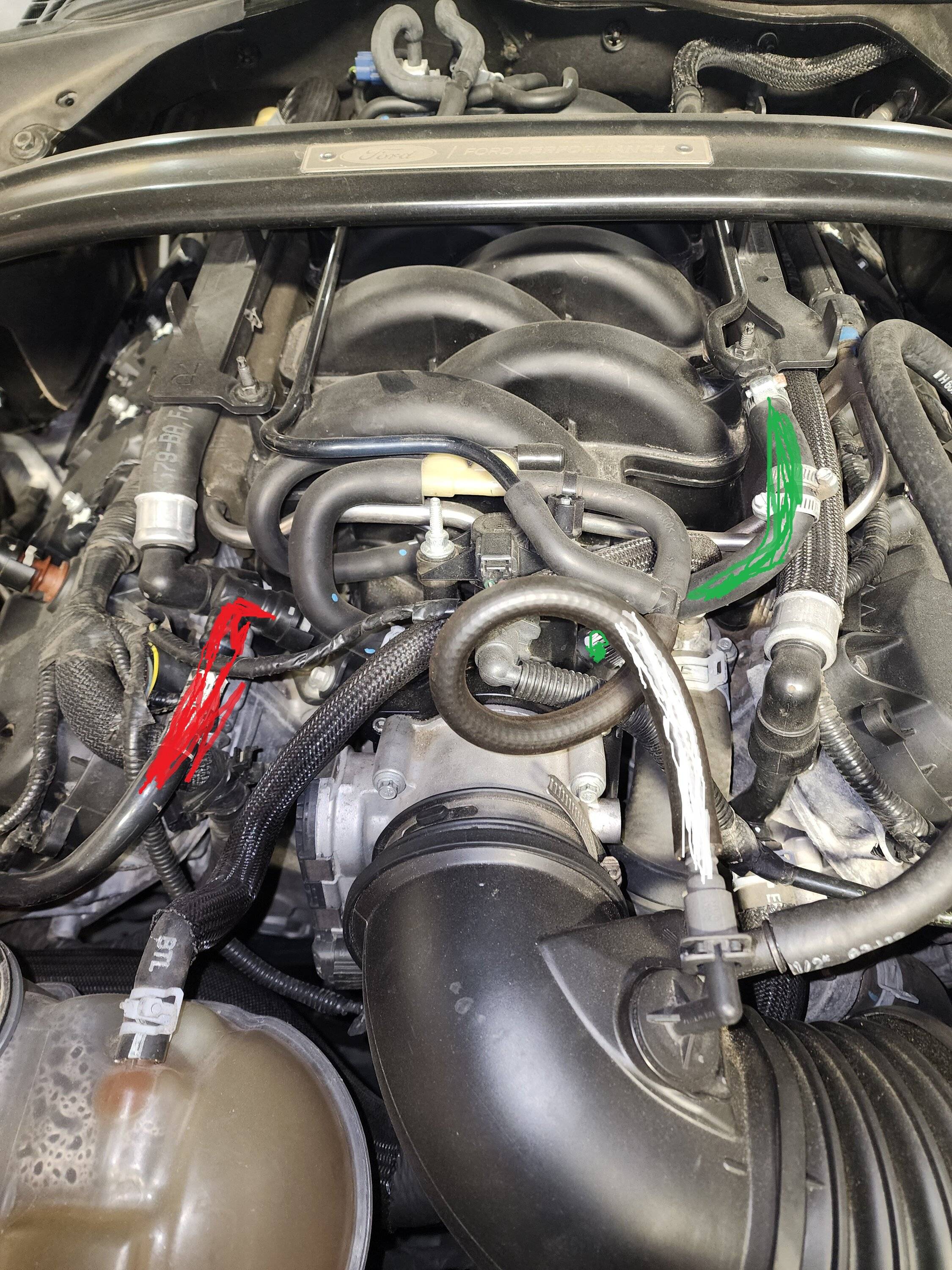

I can send you pics of a properly installed GT350 manifold on a gen 2 if you want. I'll take close ups of the vacuum lines and tell you what they do.

Red is PCV
White goes to cai, I have it looped because I haven't decided on which cai I will run. This gives me enough hose to use all I have.
Green goes to the brake booster. This one is tricky because the ports are 2 different sizes. Easily solvable with an adapter from any parts store.
The hose on the CAI next to the white goes to the driverside valve cover

Thanks for the pic with the color coding. I’ll pop my hood tomorrow and compare.

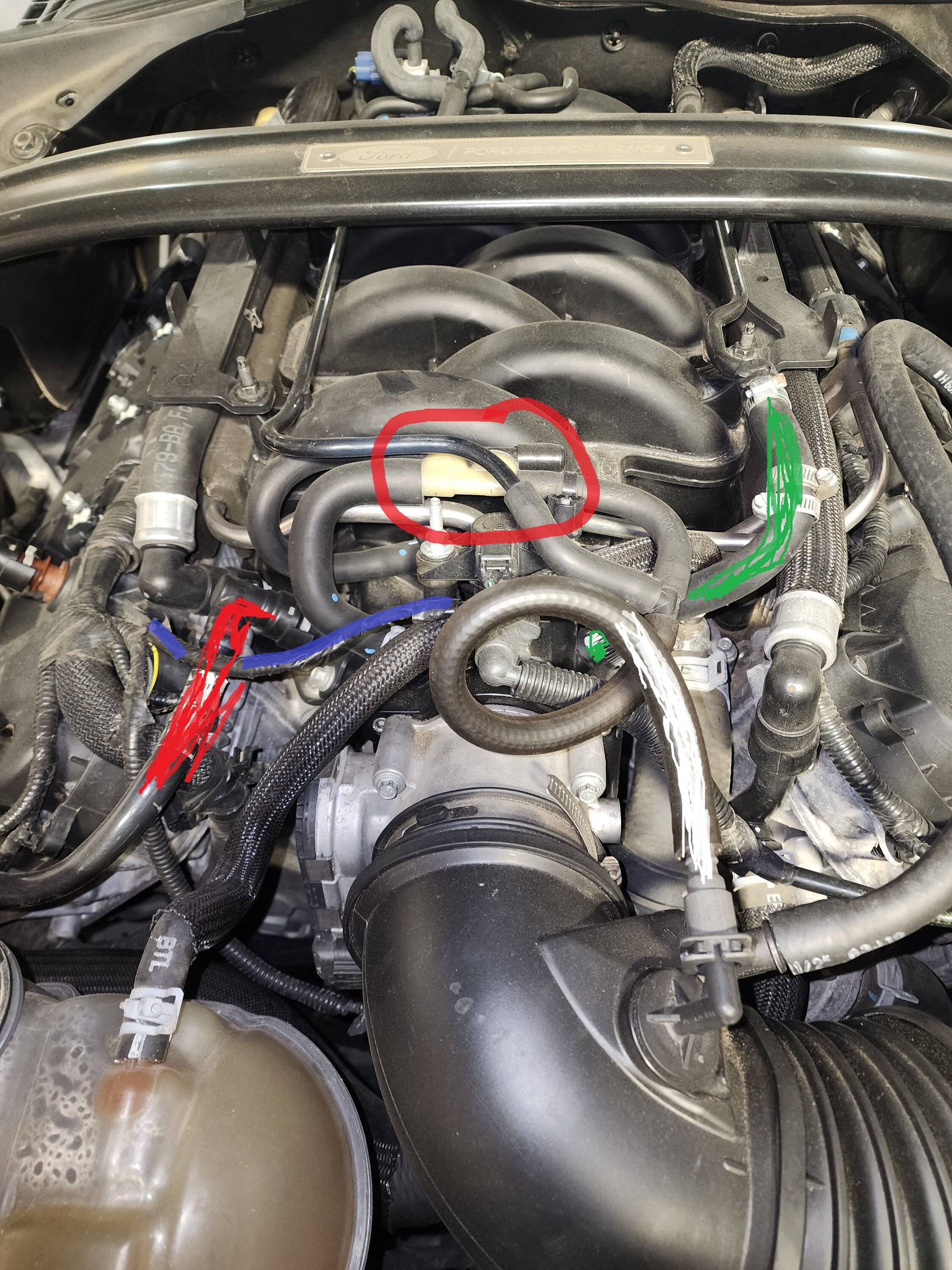

If you look at my picture there is a 4 way valve with one port capped off. Your 17 will have the brake booster connected there.
So you remove the brake hose from it on the 17 mani and hook it to the manifold port on the 350. I marked it in green. As long as you got the vacuum lines with the 350 manifold, new ones come with them, that is the only real modification required.
I'll repost the pic and circle the 4 way valve. I also marked the wire that needs to be stretched. It goes to the purge valve.

Some people hook the booster to the 4 way valve and cap the manifold port. Ford does it the way I have it.
