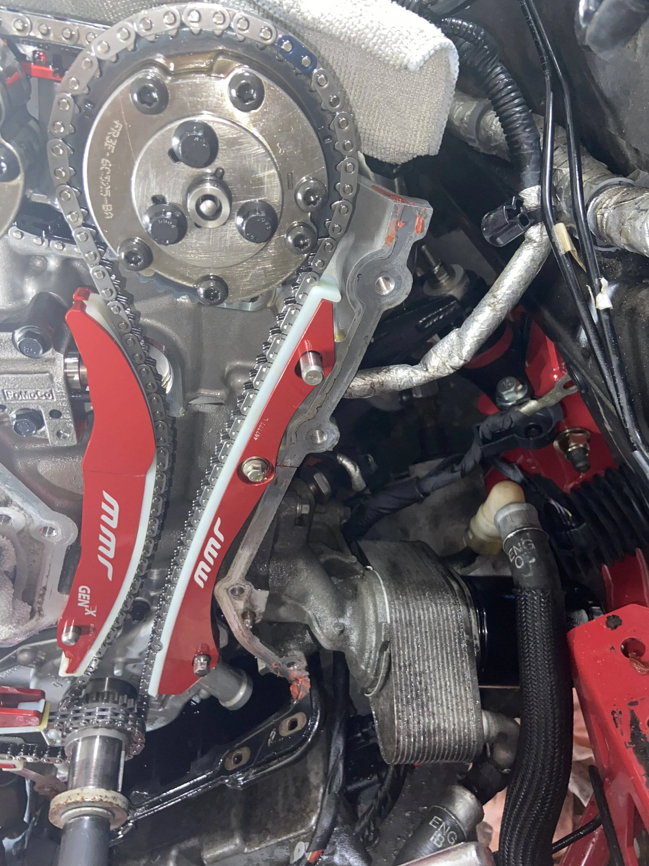

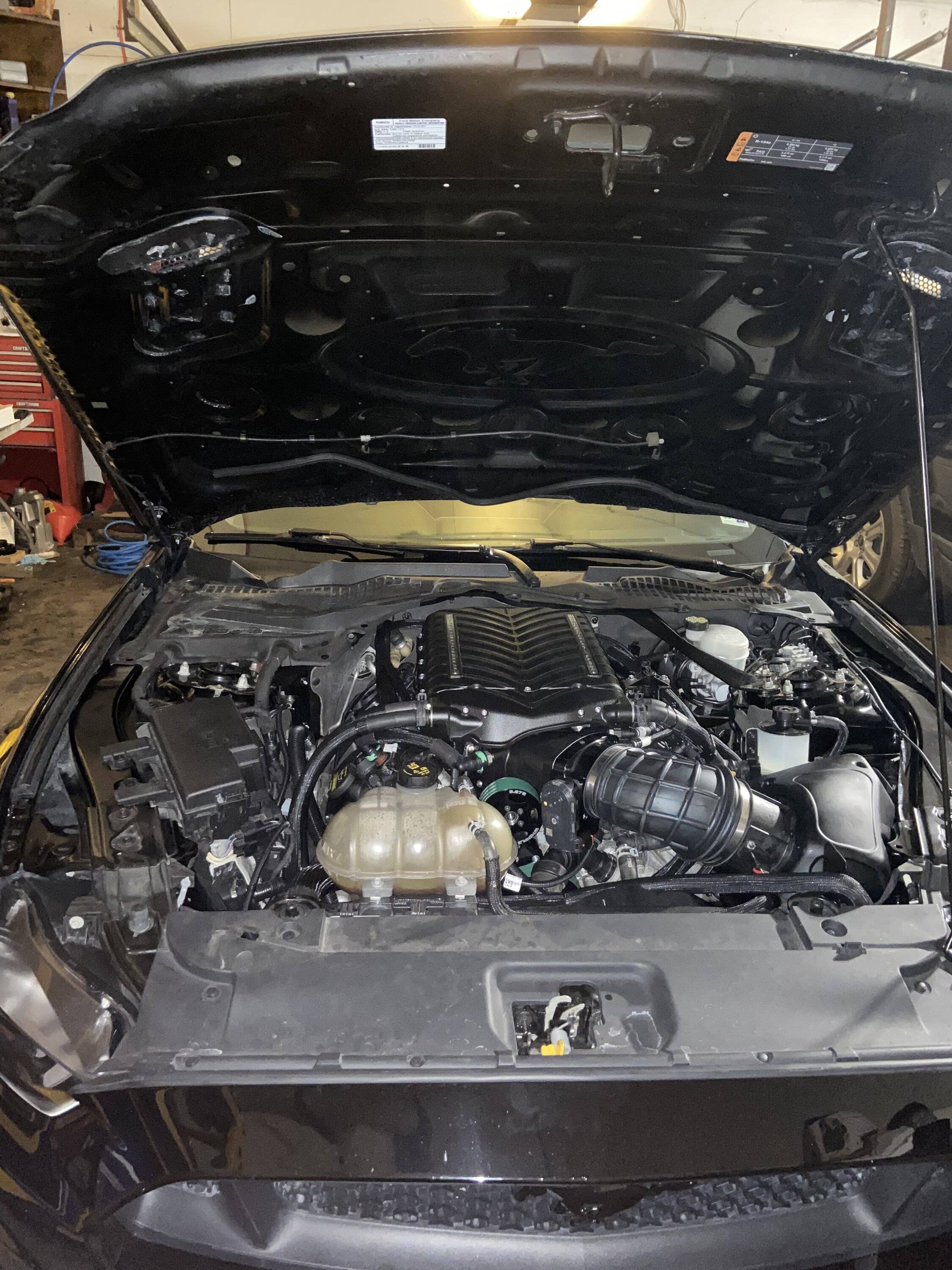

So i have a 2015 gt gen 5 whipple lund tune im wanting to make 900-1000 do you guys recommend buying a shortblock (if so from who) or buying a rotating assembly and do it OR is it even worth it
do the heads need work as well ive read valves are a good idea but is that about it?
im sure this has been answered before couldn’t find exactly what im looking for
the engine currently has the typical stuff opg, cs, timing chains, tensioners, mmr plate, arp cam bolts, kinetic crank stud
