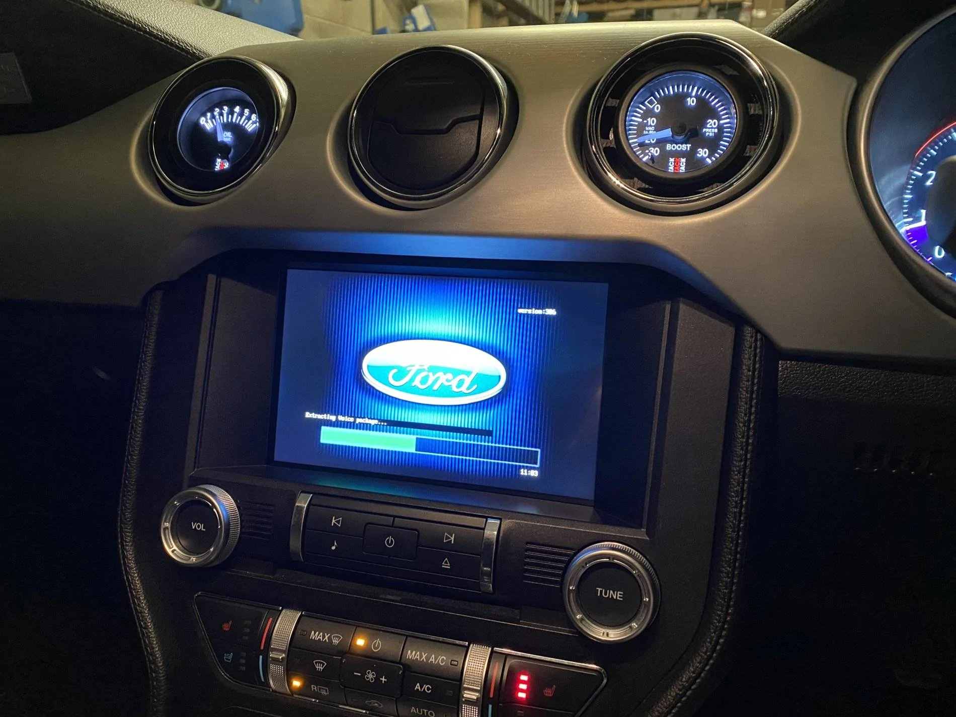

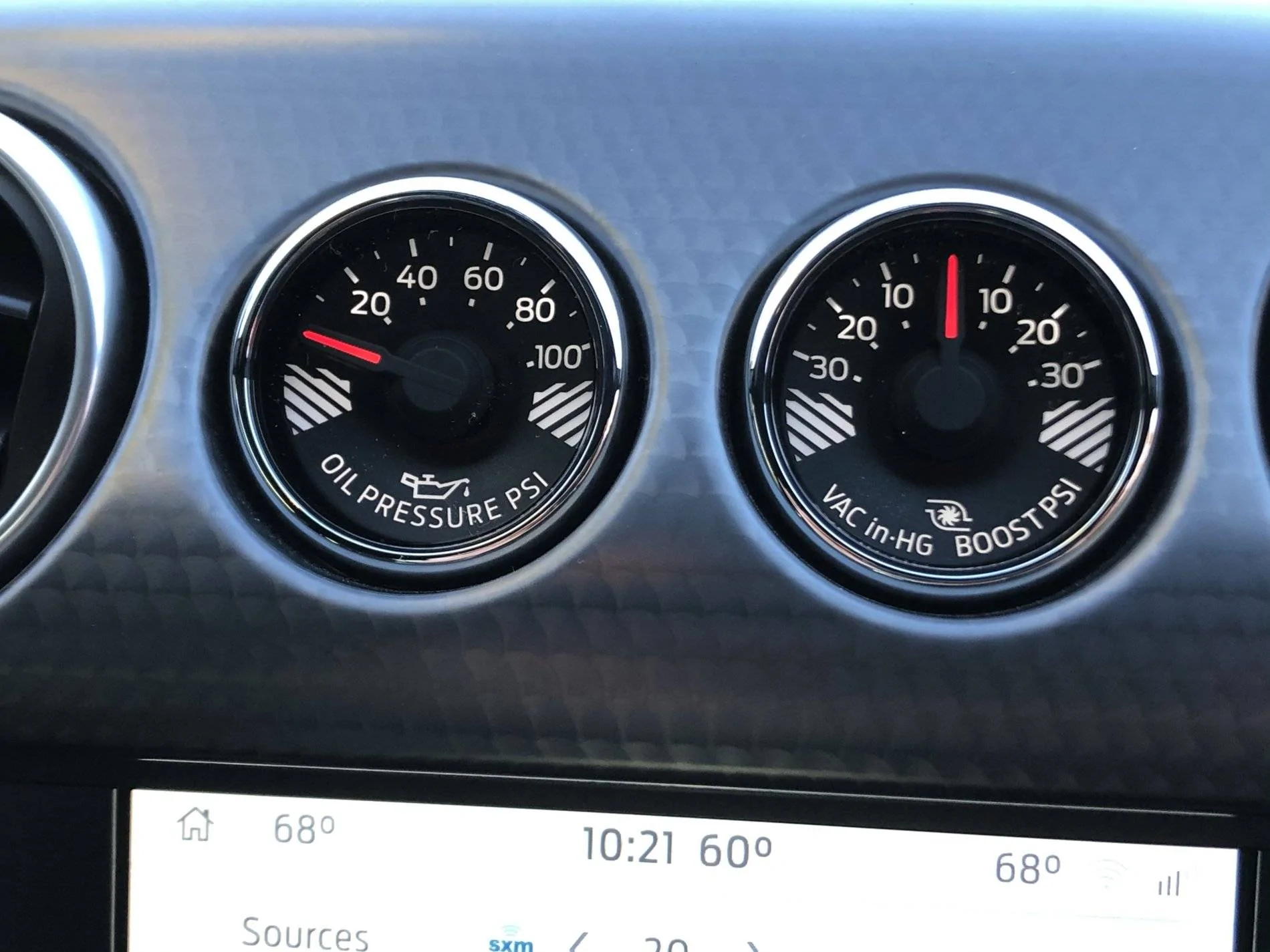

I have no experience with the Interceptor and the Roush OS. I can verify with 100% certainty that the AeroForce Interceptor can be connected directly to the CAN bus and poll data with no issues. I have tested it in that configuration with the Whipple OS and the OEM OS for my car. It didn’t matter if I had it connected via the OBD port or hard wired to the CAN bus, I had no issues with it providing data for my selected PIDs.@GR1MxREAPER we may have chatted a bit in a Facebook thread.
@mejohn50 the problem with both the banks and Aeroforce gauges regarding freezing data is due to them using the OBD2 protocol to poll information at the diagnostic port. The diagnostic port is typically assigned the lowest priority on CANBUS controllers and slow anyway, but with this Roush strategy the ECU gets very busy with rapid load changes, especially transitioning between boost and vacuum. If I "tap" the throttle rapidly the gauge will freeze for seconds at a time, update figures, freeze again, etc, it's not reliable. The next part is that neither allow you to write or configure PIDs (I'll admit this is an assumption I'm making about the Interceptor product range solely based on them offering them for specific car models and year ranges).
A device that will just listen to the whole CANBUS doesn't need to poll and wait for a response from whatever module you're trying to get data from and will refresh as fast as that module is updating. I apologize I'm not prepared with links etc, HPT forums had a discussion about CANBUS over OBD2 vs serial, and then CANchecked offer "gauge clusters" to run on CANBUS as well as some OBD2 type gauges, I did try find where they worded the difference but cannot seem to find it again. I wish I still "bookmarked" pages like I used to.
I have no idea what the polling rate is for the Interceptor and I can’t verify what the polling rate differences are for various modules or connections to the CAN bus.
What I can verify with 100% certainty is that the Ford-specific Interceptor only pulls data from the CAN bus no matter how it’s connected. Is it at some high data rate? No idea. Is the data rate higher than nearly any human can react to a change in the data? Most likely. How is it doing it? No idea.
