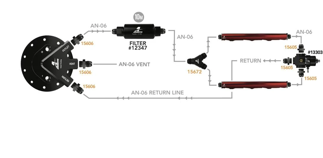

The best is to go to the fuel rails first then to the regulator from each rail and then back to the tank. Most people just deadhead it though
Jackson1320
Sep 26, 2019
3,057
1,228
California
Jaxson
2015 mustang gt
Ideally it should be like this but many other ways work fine. Ignore the sizes
