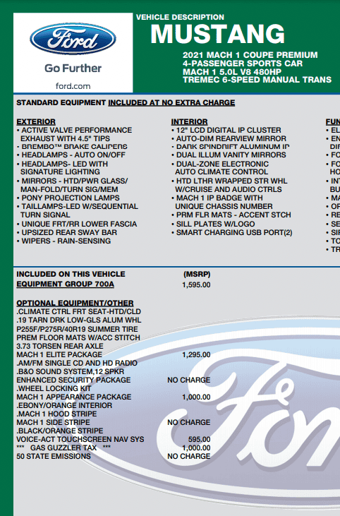

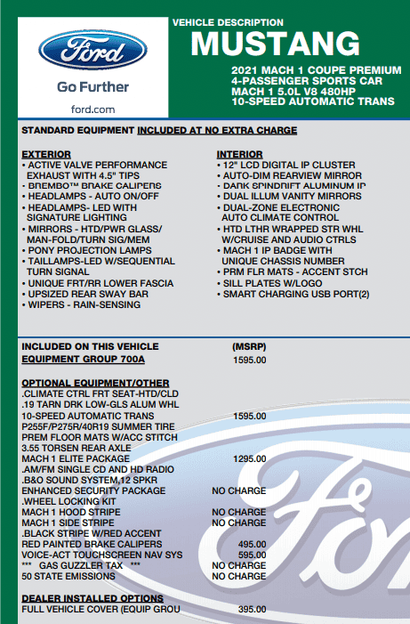

I posted this bottom of page 2. 2 A10 cars, one with the tax, the other without it. Its a build date issue, not the transmission. You are not going to be avoiding this tax unless you had a very early build car.
Today was the first day my sticker became available. It has the EPA area, it is an A10, and the line for Gas Guzzler Tax says NO CHARGE. The blend date is 120210409. So that theory goes out the window. I know it is a Federal standard but has anybody noticed if the state the vehicle is delivered to has an impact on whether or not the tax is on the sticker?

That does seems to negate the early build date theory. The A10 example I provided has an significantly earlier build date than yours, by about two months yet guzzler tax was invoiced as $1,000 on that sticker, I get more and more curious about this as it goes on. I'd really like a definitive answer.

my 21 had the tax (6 speed) and the a10 s didn t then too.
it s a "more fun" tax, LOL

I ordered two 2021 M1's - Manual non HP and A10 with HP. The manual had the tax and the A10 did not. Couldn't tell you why or why not. Came in the same day - bought the A10.
