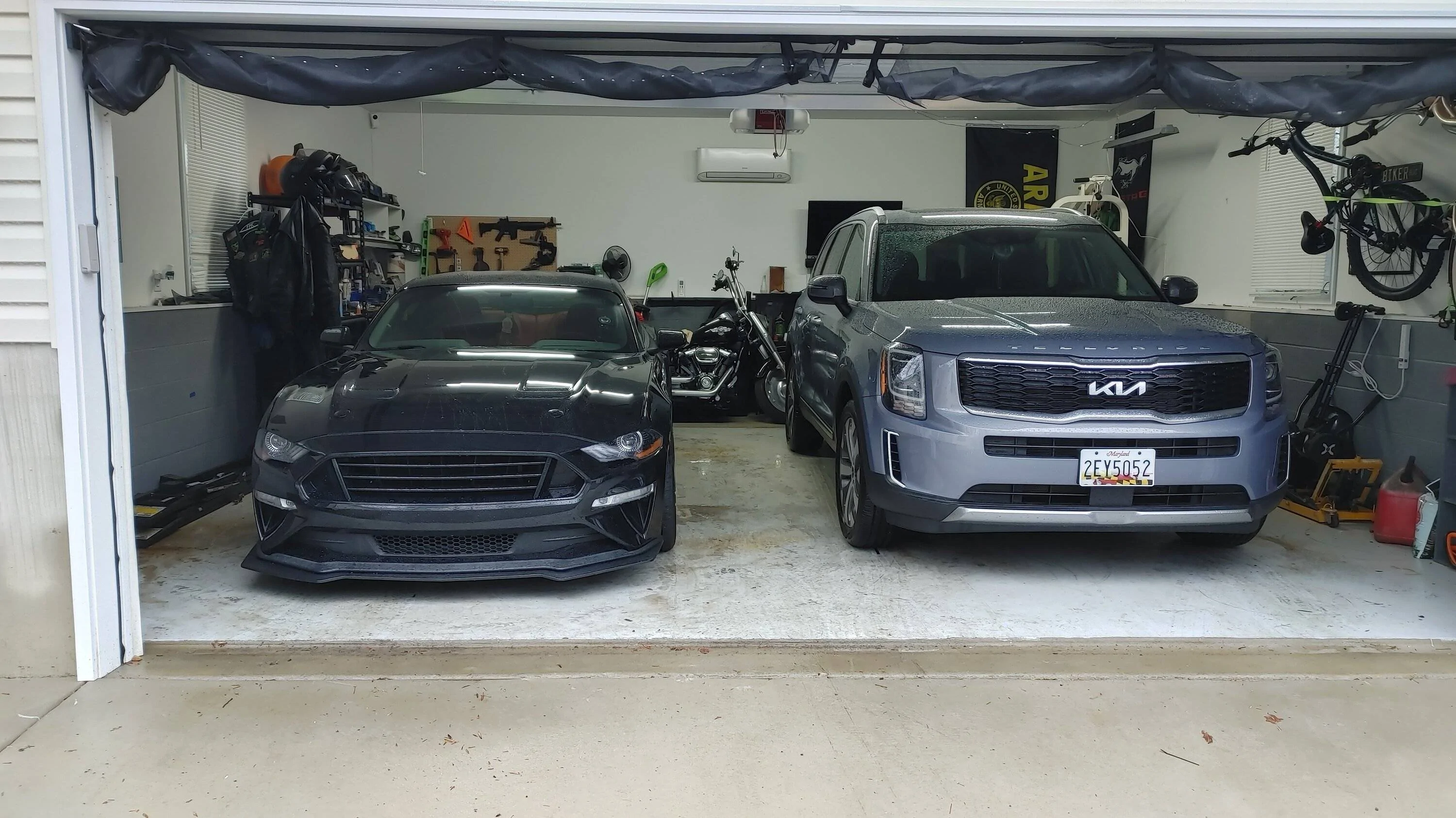

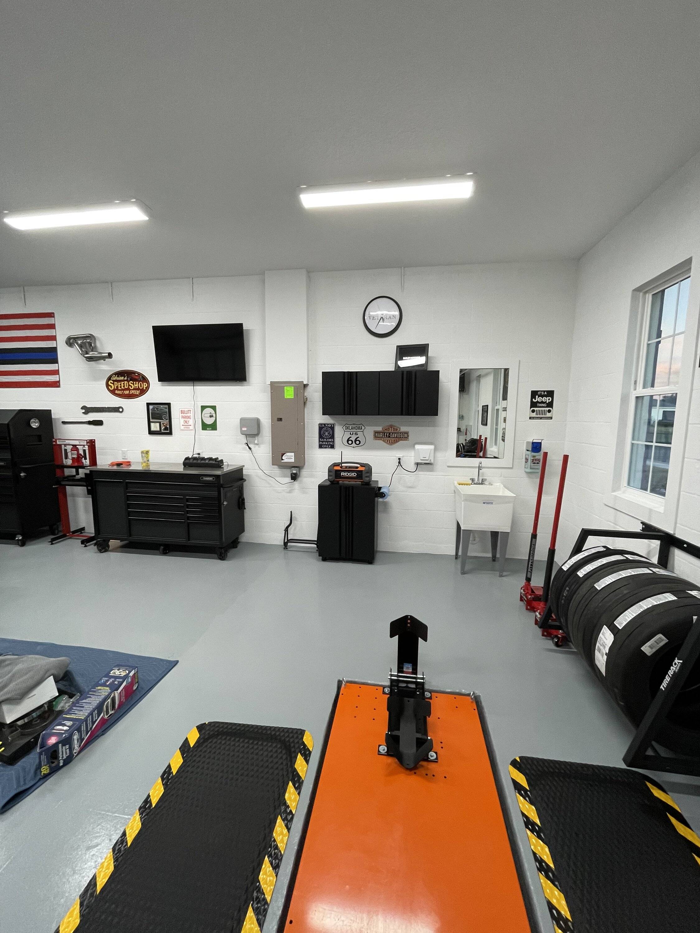

I just recently did this in the last year. I can tell you what I did,then tell you what I would do different.. So I built a 24x24 for my car and motorcycles. Is fully insulated, big windows, 12 ft. Ceiling, attic storage, mini split A/C and heat. I have a lift as well. The quick jack 5000xl. I chose that because it can be moved when not in use.
What I would do different is add a bathroom, and a wash sink. A 40x40 sounds awesome and would give you plenty of room to have all of that

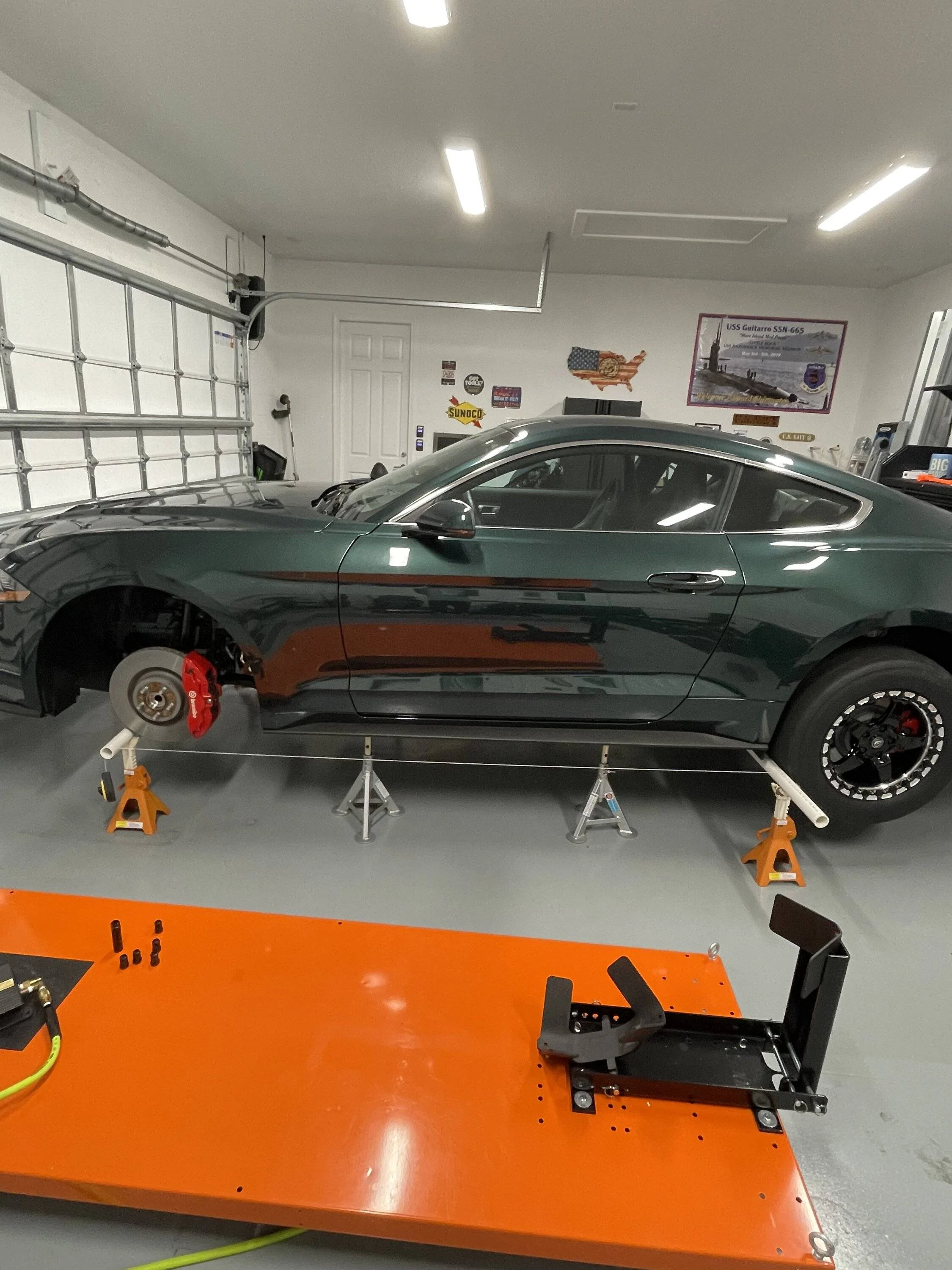

Do you have motorcycles? If so, do you foresee needing a lift for them? If the answer is yes to those questions, I recommend pouring a pit in the ground for your MC lift. This will make getting bikes on and off the lift easy and won’t require any help, as you can simply ride on and then roll backward to get off.
- A utility sink, soap dispenser and hand dryer are also good ideas.
- A urinal or toilet.
- Side mount or jack shaft garage door openers will allow for high lift doors.
- Plenty of electrical outlets to allow you to plug in tools.
- LED lights to make the shop super bright.
- Epoxied floors with no fleck, as the fleck makes it difficult to find screws, bolts and washers that you may drop onto the floor.
- Tire rack if you swap between wheels.
- Mini Split (heat and AC) as mentioned above.
I use my 3 car garage as my shop area. I wish I had put a urinal or toilet out there, but having to share the space with lawn equipment has essentially cut me down to 2 usable bays (one for the motorcycles and the other for my car).

- Loft for extra storage space if you go high enough with the ceilings.
- Run plumbing around perimeter of shop for air lines, or install a hose reel next to your compressor.
- Ultrasonic sink for parts cleaning.
I installed a hose reel next to my compressor, but if I were building a detached garage/shop, I would run plumbing for the air lines from my compressor for more flexibility. I would also keep the compressor in a closet with sound proofed walls to make it quiet in the shop when the compressor is running.

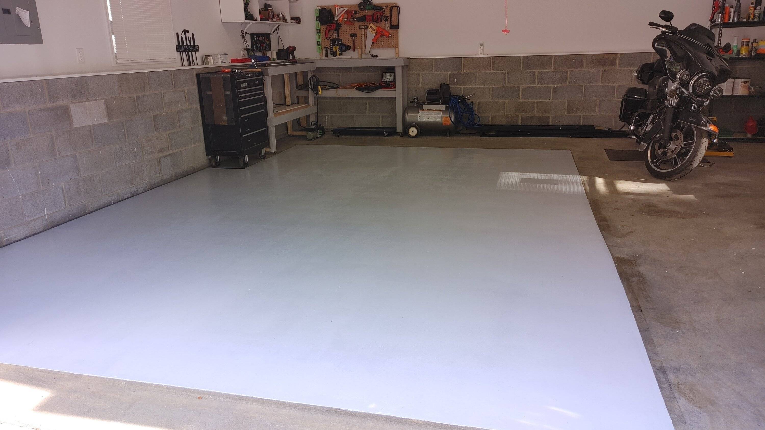

What are your thoughts on block vs framed walls? Looks like you have quite a bit of slope on your slab. How is that working out for you?

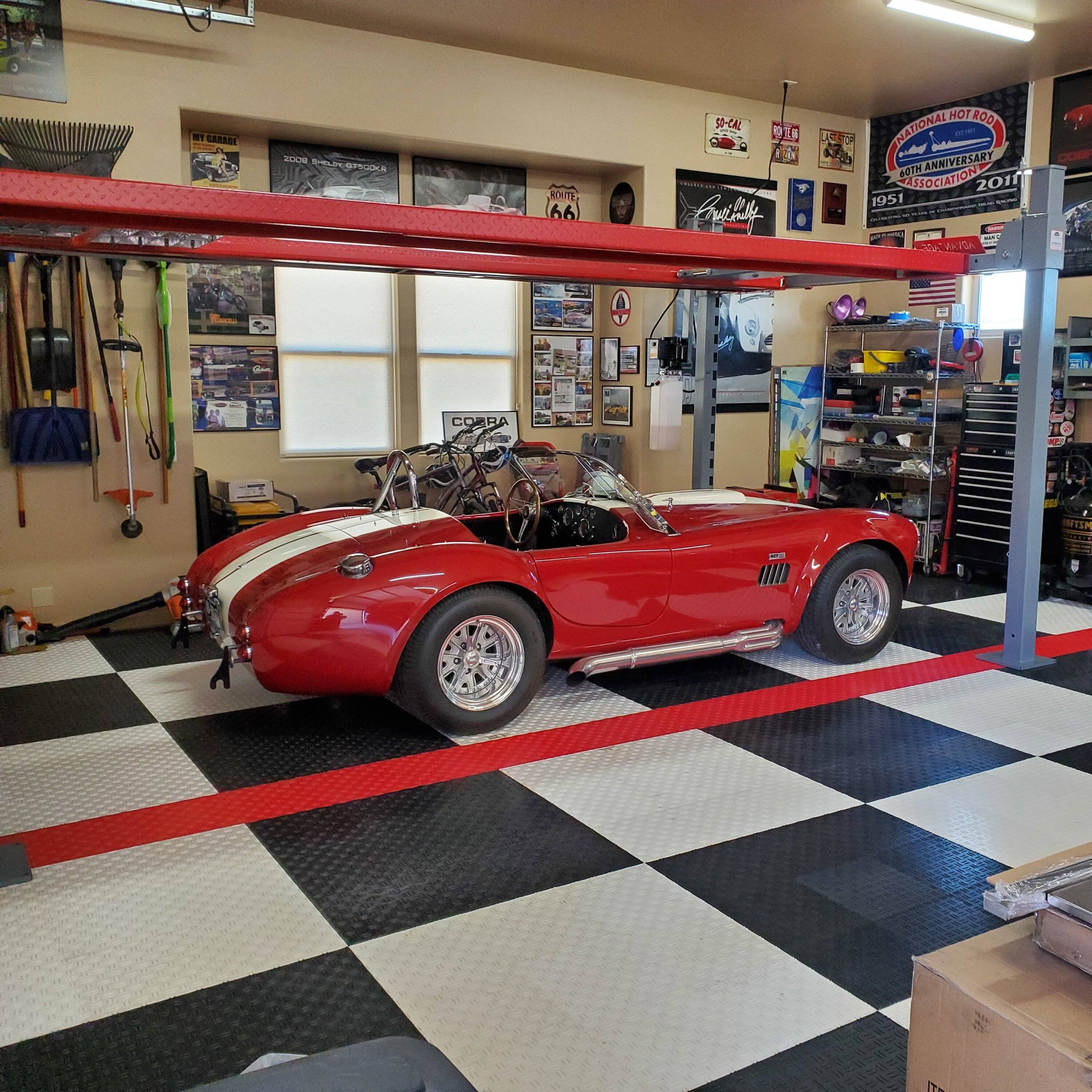

I us the same alignment stuff for my Cobra!

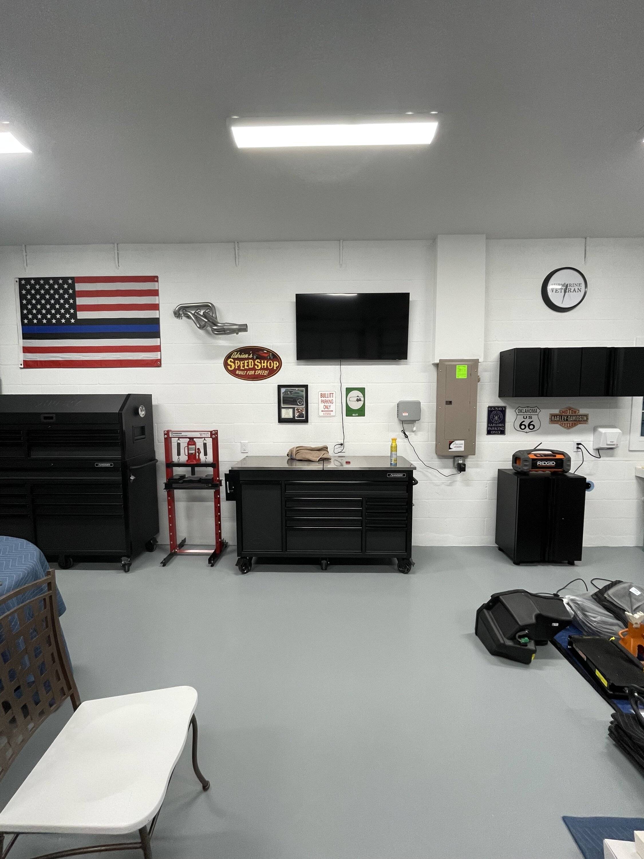

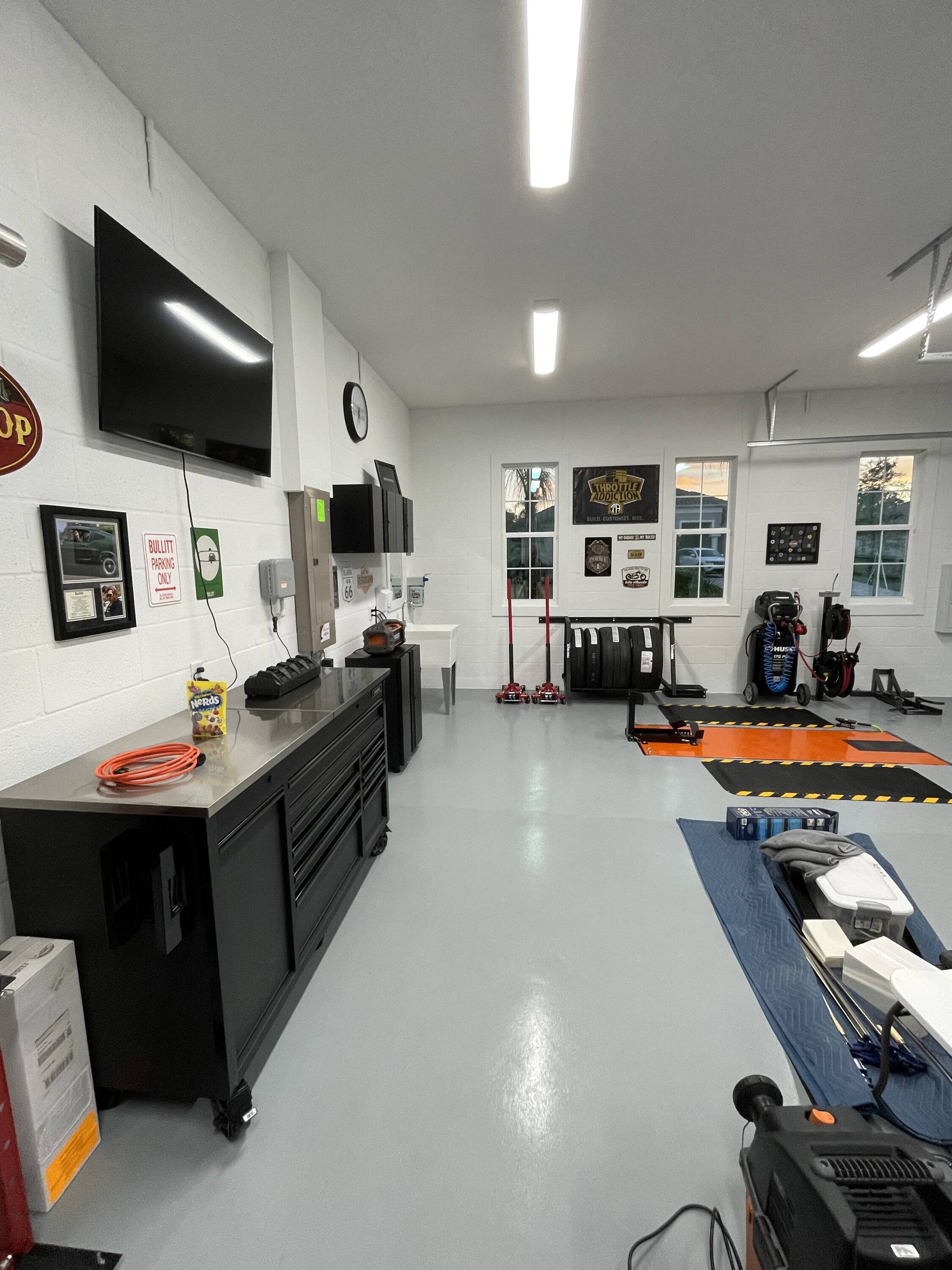

Two of my walls are constructed of block and one is framed with drywall. At first ai thought it would be challenging to mount things on the block, but quickly learned that Tapcon screws are made specifically for that purpose. I used them to mount heavy objects like my TV, header and cabinets on the walls.

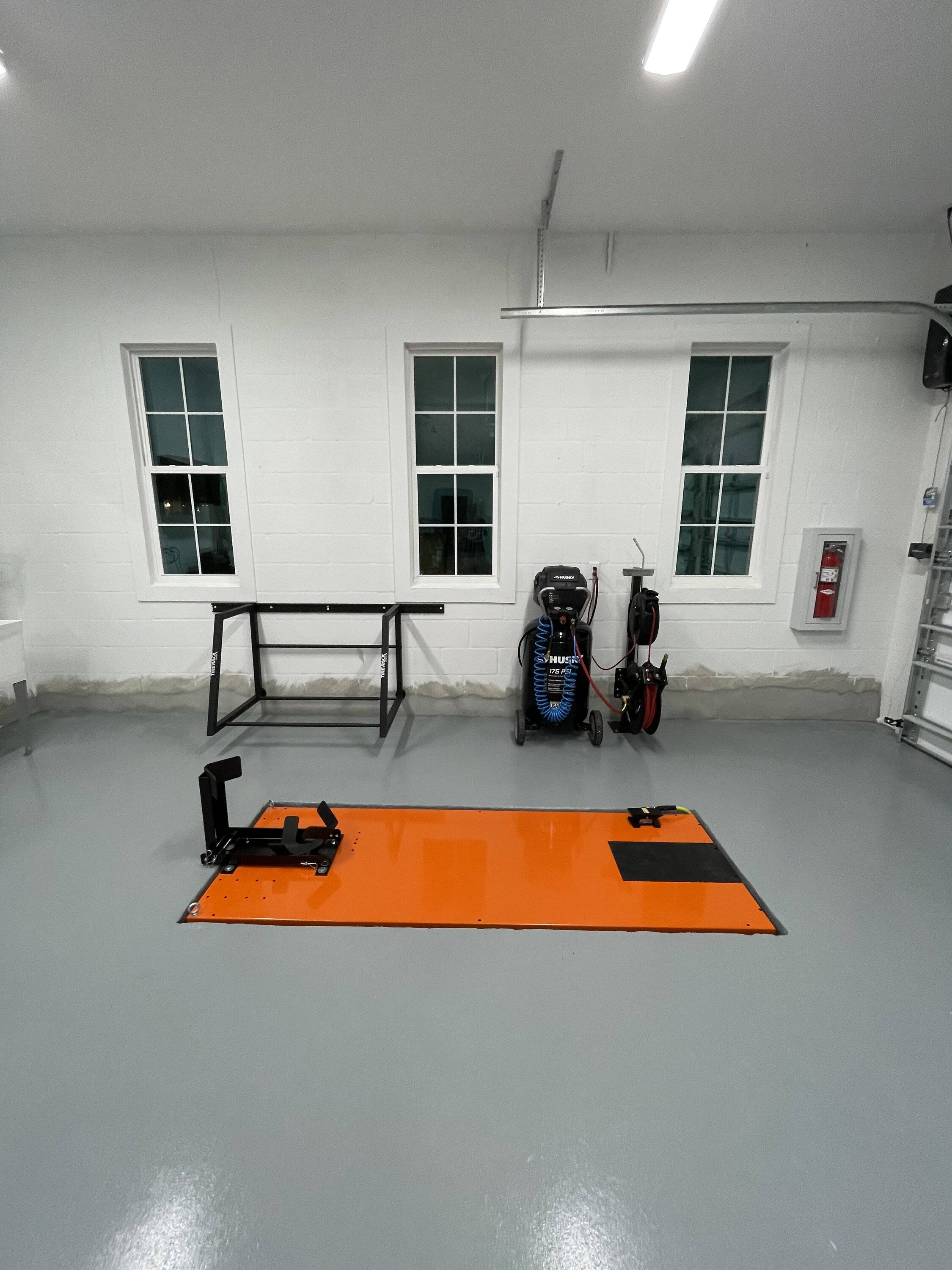

The slope isn’t noticeable at all, unless you look at the walls on either side of the garage bays I actually had them float the wall at the back and side (where the windows are) to make the footer blend in better. I don’t have any issues with jacking the car or anything like that. Being that it is a garage, they have to add runoff, so that it can drain If needed, as most garages don’t have floor drains. In a detached shop you could probably install floor drains, but I would make sure you add traps to be able to access them for clean out purposes. Ever see car wash bay drains full of water? That’s because things are getting backed up in the drainage system. Another benefit to the blocked walls is there is no risk of getting sheetrock wet and soggy. The pic with the car shows the sheetrock wall in the background.
