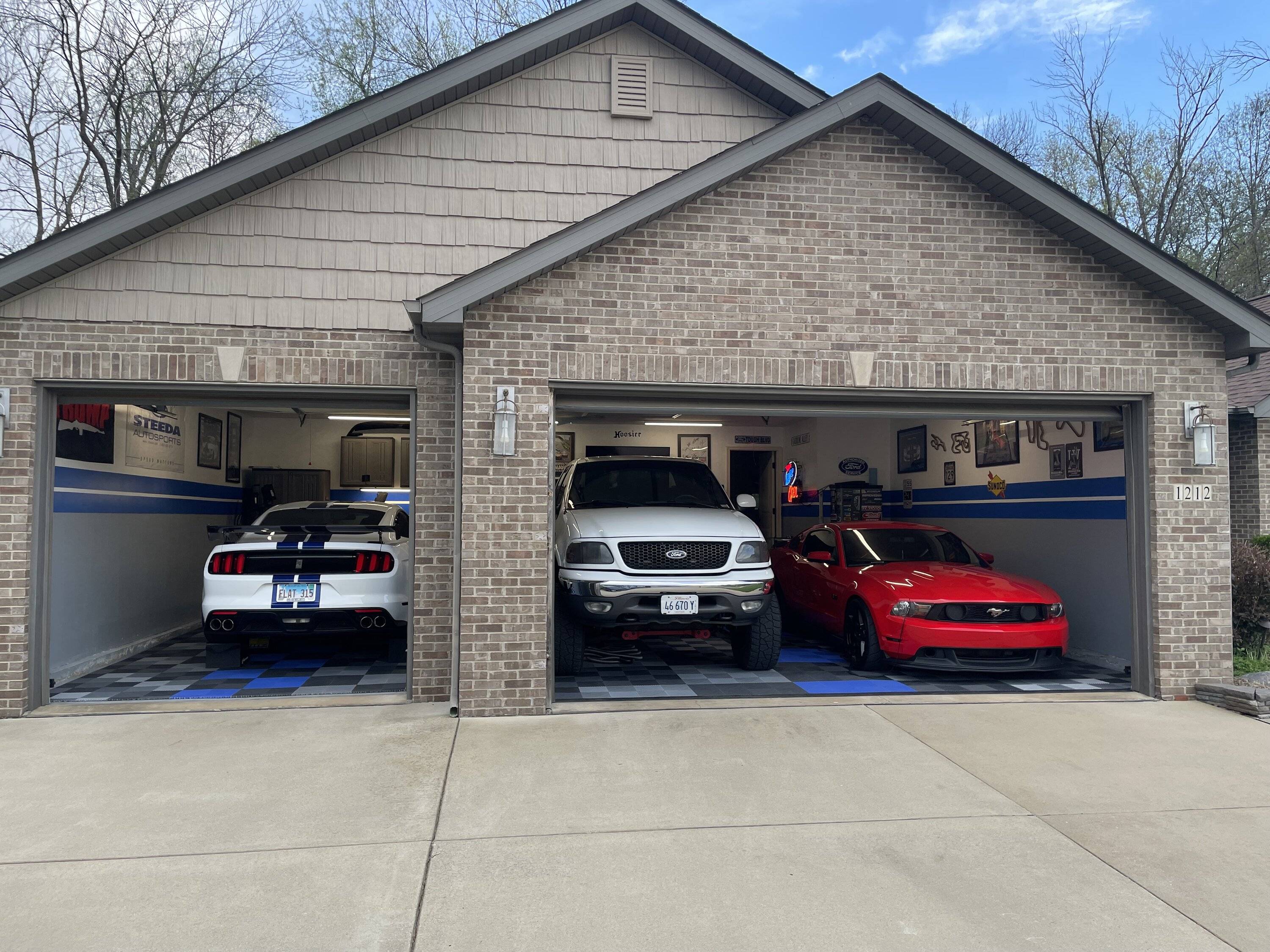

WOW...great thread. I'm just now running across this one. No matter what you do, you'll learn from it and figure out more stuff you want for the next one. I thought for sure I nailed my dream sheet with this build...but, NOPE. Always more. I read through this thread and I know some of these are repeats, but here goes. Oh, and I do have a new one on my list that I noticed wasn't mentioned yet. I got this one right, and is also a must have. So without further adieu...
What I got right...
> 8' door frames!
> min 12' ceiling
> runnign water
> great lighting (you cannot have too much)
> sloped floor for detailing/wash water runoff (my builder flat out refused to install any type of floor drain on a slab, thus he added extra slope)
> insulated
> ceiling fan
What I missed...
> An office - yes, I want a small office in the garage; desk, computer, chairs, lounge area, etc
> small bathroom/urninal
> sink (maybe)
> BIGGER. I have 26'x36' limited by property line.
> some type of heat/AC
> more electrical power and outlets - see lighting; can't have too much
> shaft drive garage door openers

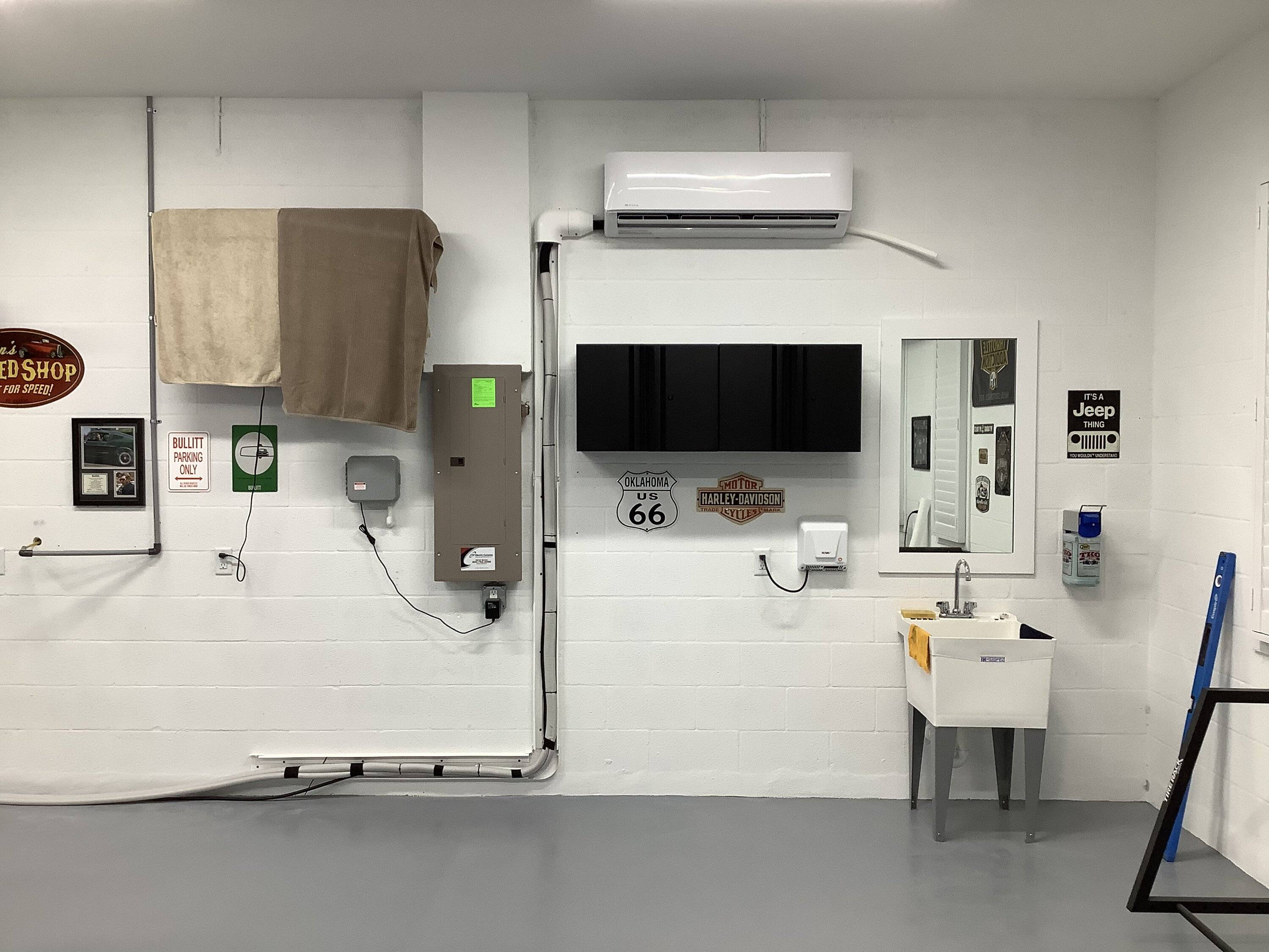

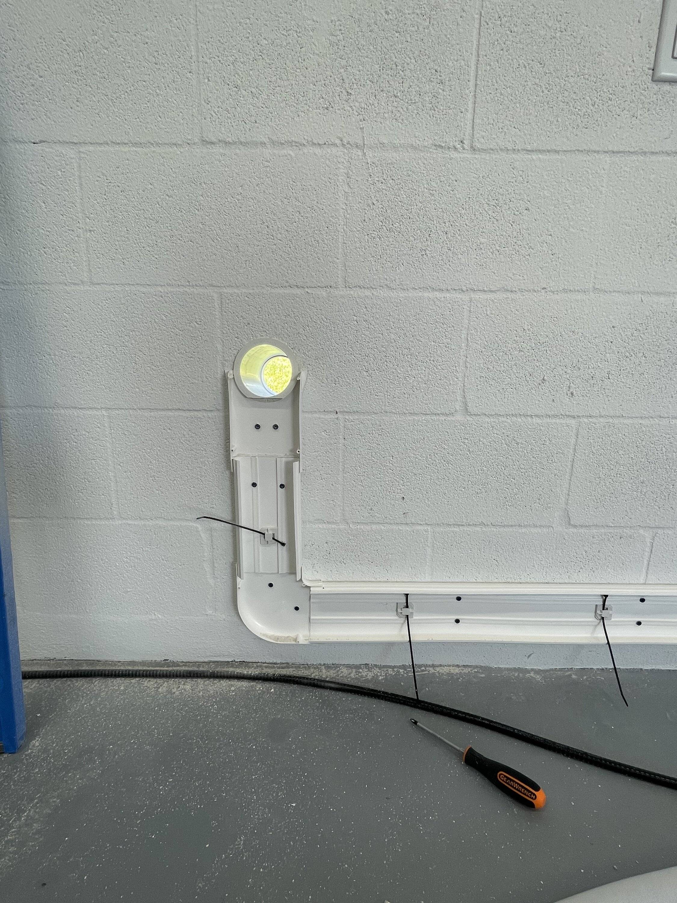

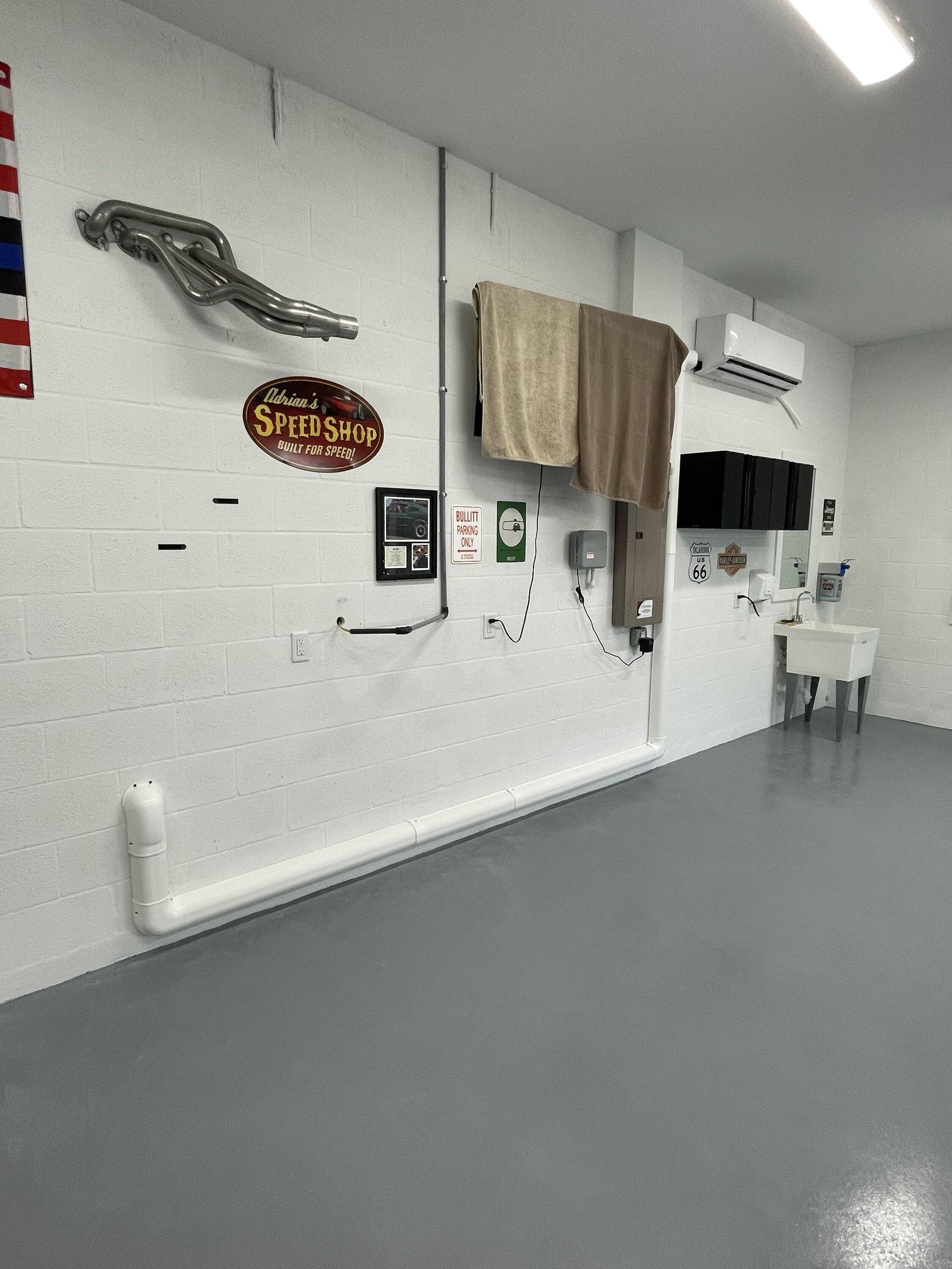

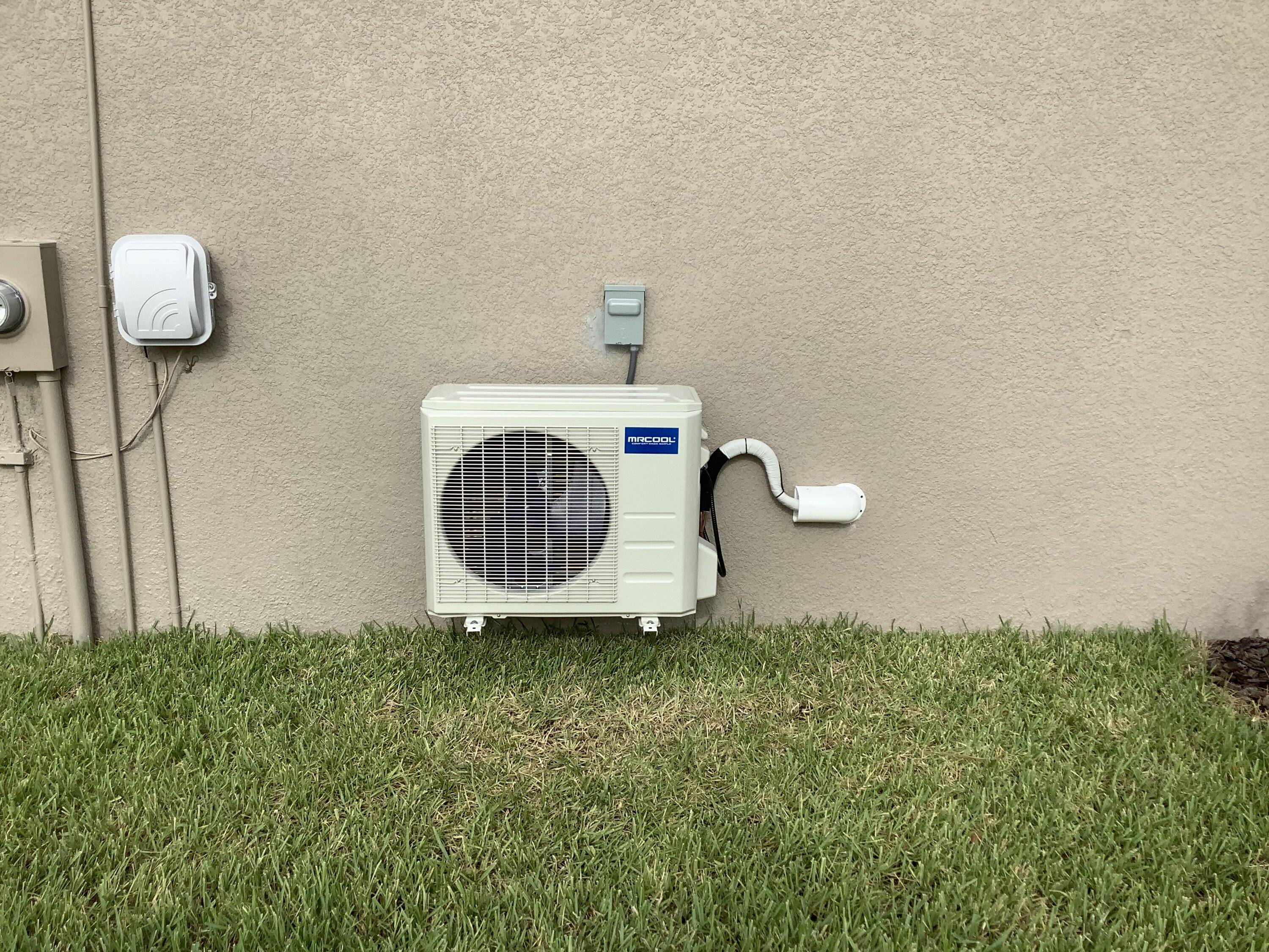

@galaxy, the heat/AC is still very easy to do. I installed mine after the pics that you see on page 1 of this thread. I settled on a mini split and ran the line set on the inside garage wall, to keep a cleaner look on the exterior of the house.
The one thing I haven’t done yet is insulate the attic space above my garage. Even without the insulation, I can still get it too cold out there. That may have something to do with the radiant heat barrier that we had added to the roof.

That would be a dream garage for me!!!
