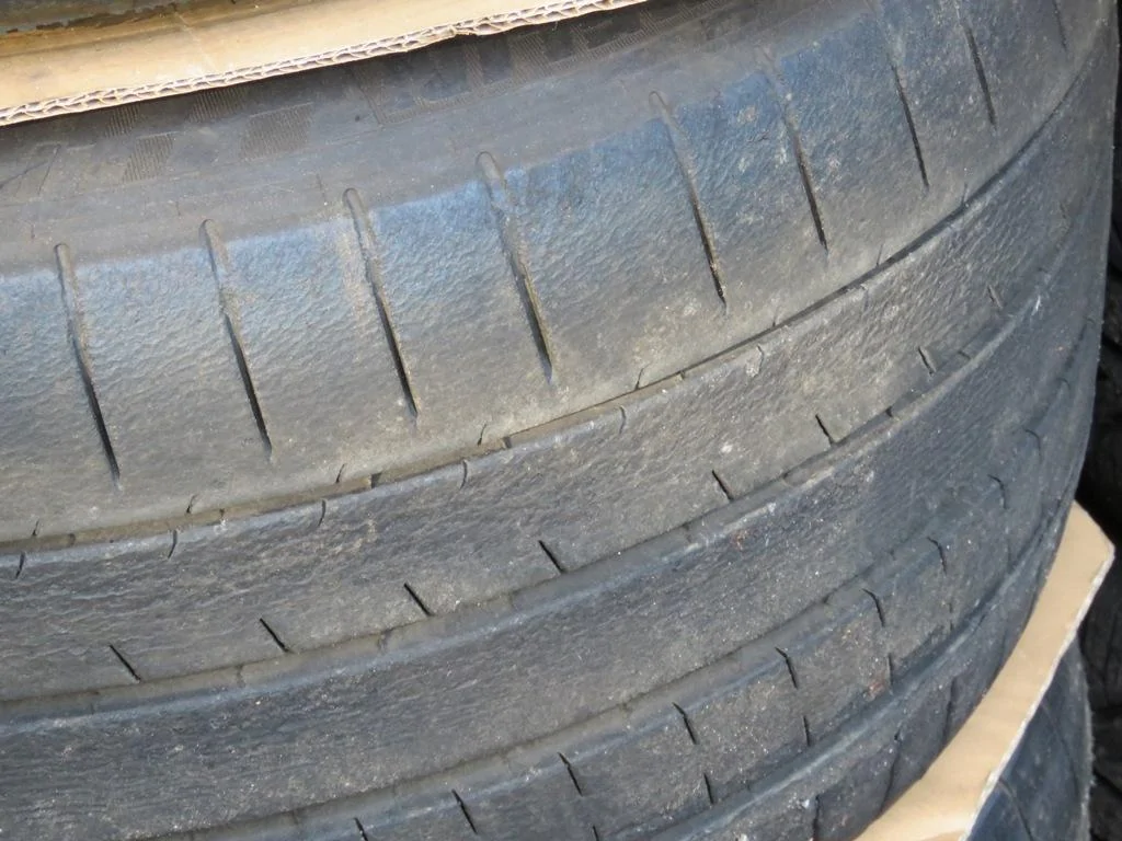

I've found MPSS tires surprisingly durable in track day service, though they are admittedly a bit past their prime after a dozen or so track days (I'll call it intermediate level) and 5000 or so street miles. Excellent wet tires.
Here's what the worst one looked like after the 10th track day. Looks like almost 50% left, though I don't expect them to make it to the 20th track day. You guys with more power will probably go through them a bit faster.
