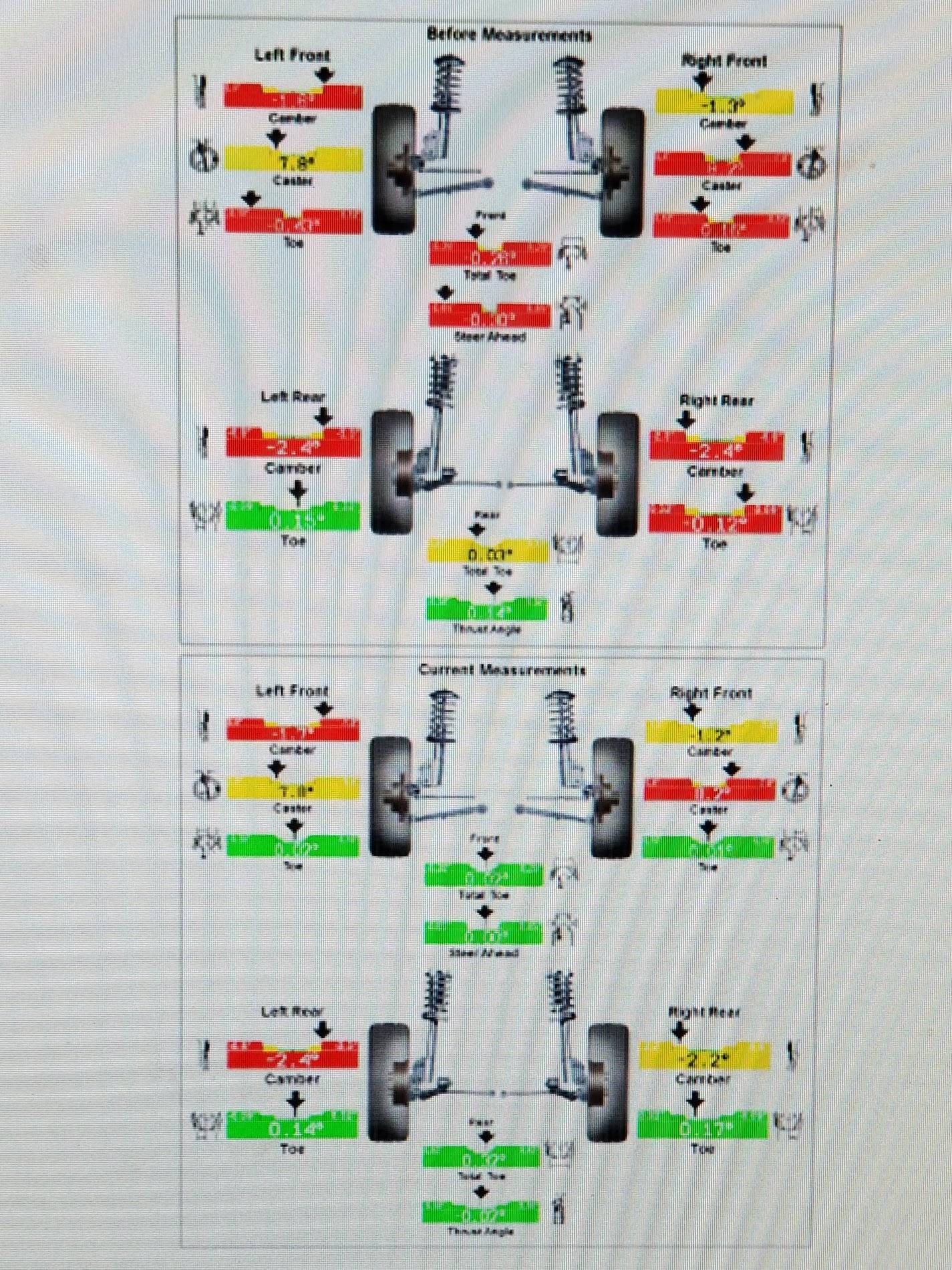

Just got an alignment after lowering Springs and the tech said "I did my best. Your car is done. It's safe to drive."
I have 90 days realignment and am thinking I'll do the camber myself with a digital torpedo level and take it back for them to just do toe. He didn't use a torque wrench after any adjustments and I don't trust he will if I have them make changes. What camber would y'all go with if this is your starting point? He said rear is maxed, but only tried the passenger side once I showed him where the adjustment is made.
Your rear camber isn’t actually all that bad in the scheme of things. Depends what you’re aiming for really. The catch with adjusting the camber DIY is that as soon as they move the toe, there will be some variation in the camber. The two are linked to some extent.
I’d be happy with anywhere from -1.8 to -2.2 for a street driven car with less focus on absolute cornering ability. Everything you do will be a trade-off in one way or another.
