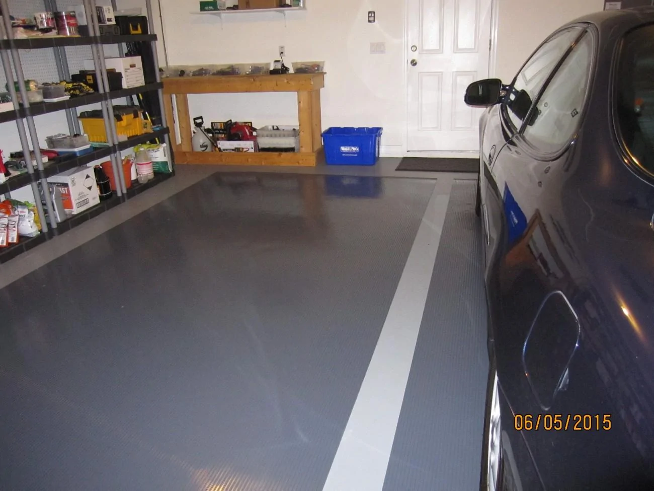

Love my garage mats, they are awesome.

BLT G-Floor Ribbed Garage Mat, 7.6' x 17' for $186 at Amazon (they come in different patterns, sizes and colors)
Got two of them for my painted garage floor, after a half year of driving on them see virtually no wear.
Just unroll and after a few hours if it is warm in the garage they will be perfectly flat. As long as you pull on them straight the mats will not move and haven't for me yet.
They are very durable and easily wipe clean of anything you spill on them, these are listed as parking pads, since they are vinyl I don't think they would hold up to heavy tools, jack stands and lifts that could leave dents in the mats... keep that in mind.
http://www.amazon.com/G-Floor-Ribbed-Garage-Floor-Sandstone/dp/B00028ZL86/ref=sr_1_7_m?s=automotive&ie=UTF8&qid=1462675131&sr=1-7&keywords=blt+g-floor+garage+floor
see below for their other products, all can bought at various sites around the internet

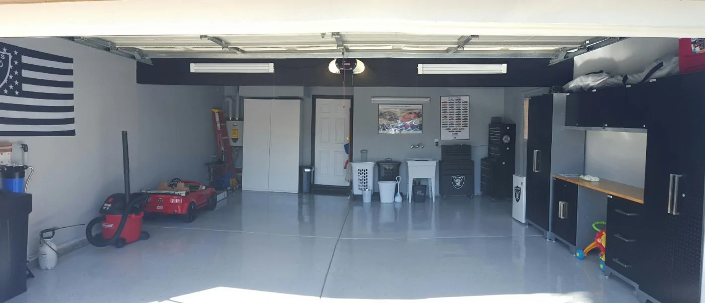

So far water floats on top. I would guess same with oil. 3 days of prep before rolling it. I should have waited until it was a little warmer. I still had some Moisture spots that came up if it wasn't for that I'd rate it 10 for 10
So do you cut in around the edges with a brush first and then roll?
1crazymach
Nov 6, 2015
799
363
Modesto Ca
Simon
2020 Race Red GT 500
No I should have. I also should have did a base coat. Its been 2 yrs now looks good but would have been perfect if i did a base.

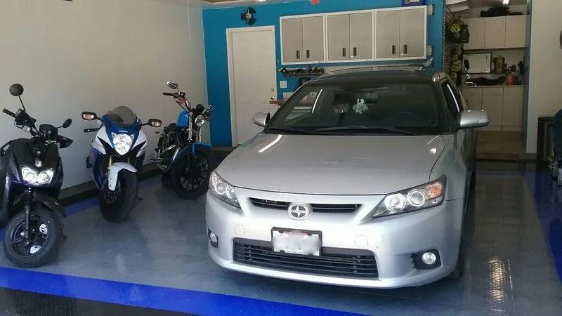

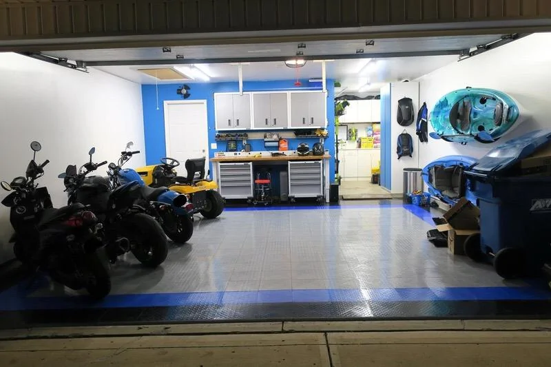

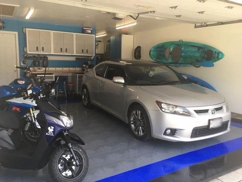

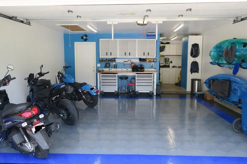

Ive had my garage for almost 4 years now, forgot to add that. .The race deck holds up well, I mop it a couple times a year after I blow it clean with a leaf blower. I've jacked on it, ive spilled oil etc, wipes up. but if anyone gets race deck, I put down 2 layers of high quality landscape fabric under it. I was recommended to do that, +40 buck cost additional to everything but there's no clackily clack. its just solid feeling and sounding. dampened between concrete and plastic.
I just use electric battery leaf blower ryobi and blow it out periodically, mopping takes 5 minutes. literally, the easiest room in house to keep clean. Lol I insulated its roof and walls, its not heated or cooled but it stays 80% of the houses temperature year round. dig it a lot, warm in winter, cold in summer. Put 20 inches of cellulose in entire attic of house, its like a air tight box.
