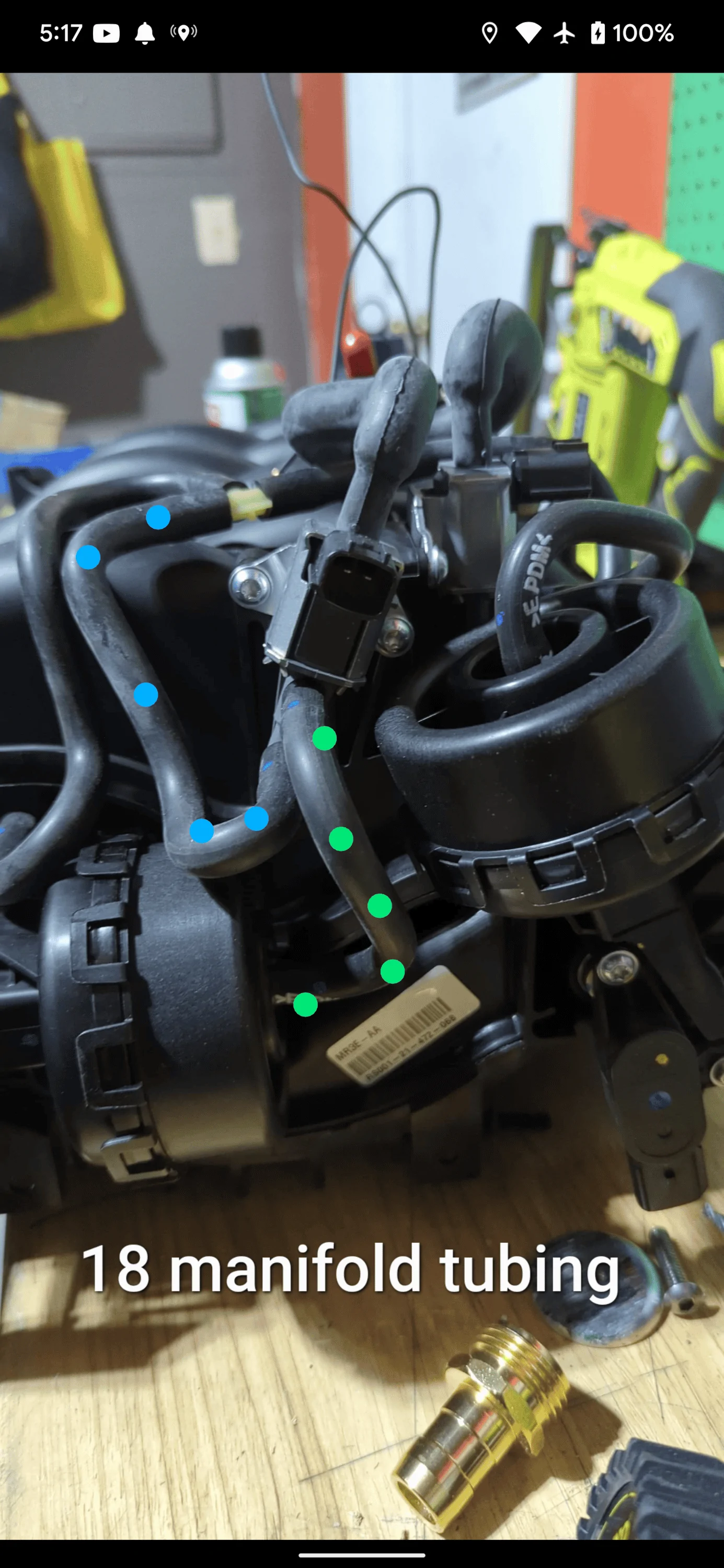

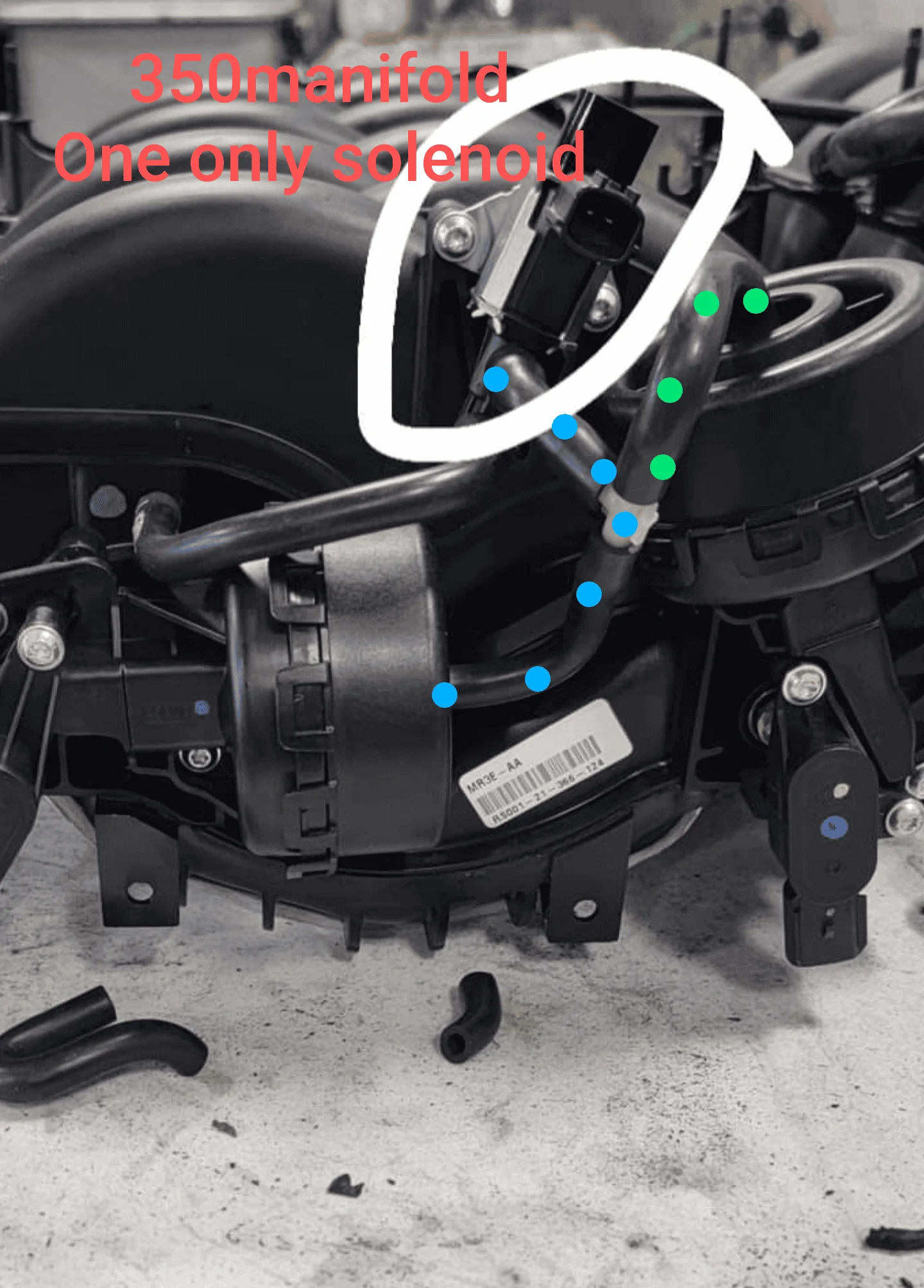

Have you figured out a way to keep the IMRC active without depinning the factory harness or are you locking them out? I installed my GT350 manifold 2 weeks ago and had to lock them out as I could not find any type of jumper harness or factory connectors to make one and not for the sake of not looking hard. Everything I could find was for doing it on a 15-17 and the connectors are different.

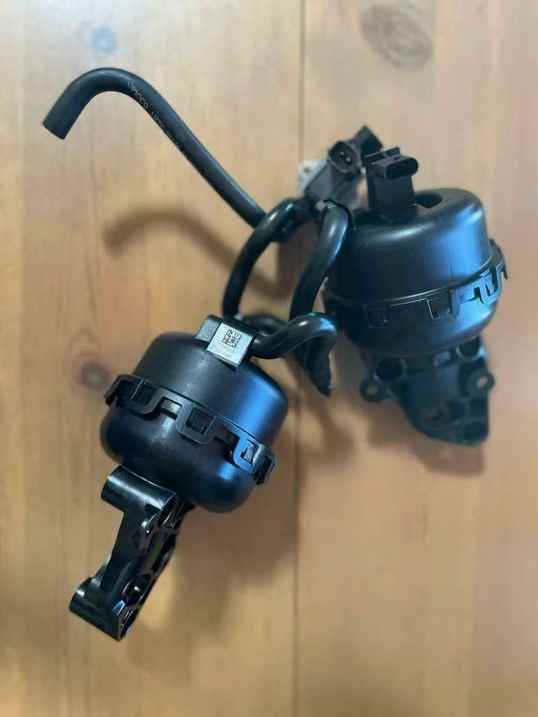

Have you figured out a way to keep the IMRC active without depinning the factory harness or are you locking them out? I installed my GT350 manifold 2 weeks ago and had to lock them out as I could not find ay type of jumper harness or factory connectors to make one and not for the sake of not looking hard.
I think if you were to order the Bullitt or Mach 1 manifold the connectors will be correct. I’m not sure though I’m speculating.
For sure the GT350 manifold will plug into the 2015-17 S550’s.

From everything that I can tell from pictures the Bullitt and Mach manifold are the same as the GT350 with the connectors up top. The ones on the bottom where the vacuum valves are might be different but I have not been able to find a definitive answer. There might be a Bullitt or Mach specific jumper harness but nothing that I was able to find looking online. A dealer might be able to assist with that. That or the whole engine harness is different on Bullitt and Mach but that doesn't make sense to do from a cost perspective on fords part.
Some hosing rerouting. Nothing impossible.
There are definetely difference with 18.
Also difference in the front of the manifold.

The connectors on the 2018 actuators are different and do not have the little "wing tabs" Im second guessing myself on if the connectors on the harness have them now. Once could shave them off with a razor blade but I do not know if the pinout is the same.
