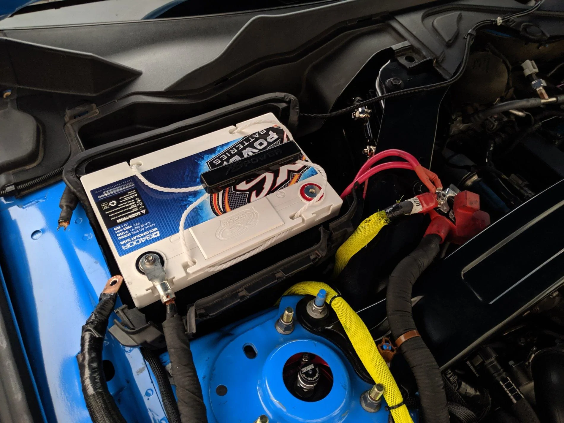

D3400R was a flop , the hood wouldn't close as the battery wouldn't sit properly even with the sides cut, it was just too high. Pffft. I have an after market hood that may be why, IDK, I'm just going to go with the d4700
Since you said any...D3400 should fit if you cut off a short side. It's too wide and starts stressing the plastic enclosure, but there should be enough space for it to sit at the bottom if you remove a side.

So I have it sitting like this, it's flush, but I can't use a terminal post. So how did you get the + (red of course) connected. I'm running "Big3" as well but there's no room for that if I go with this 3400R.

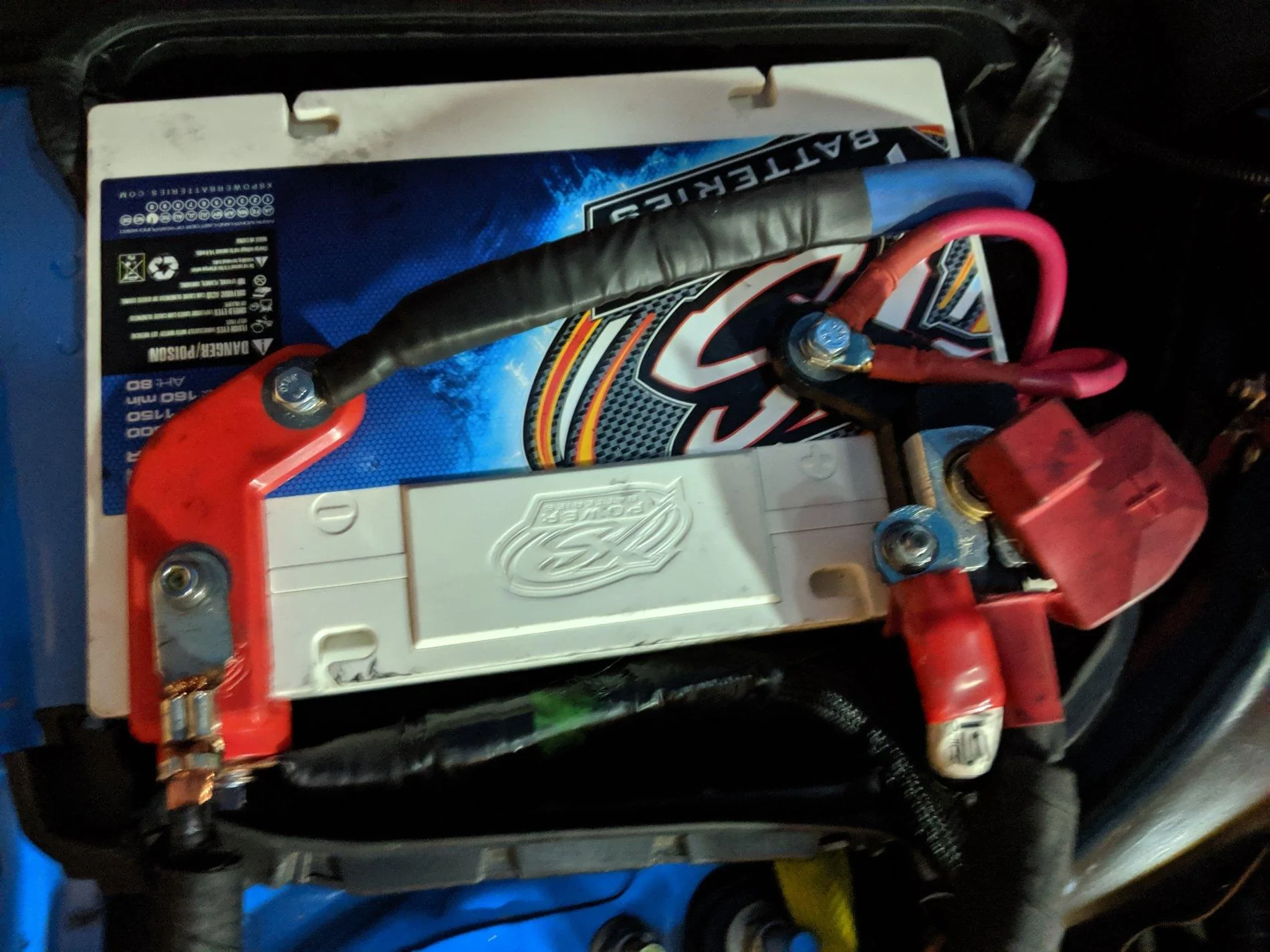

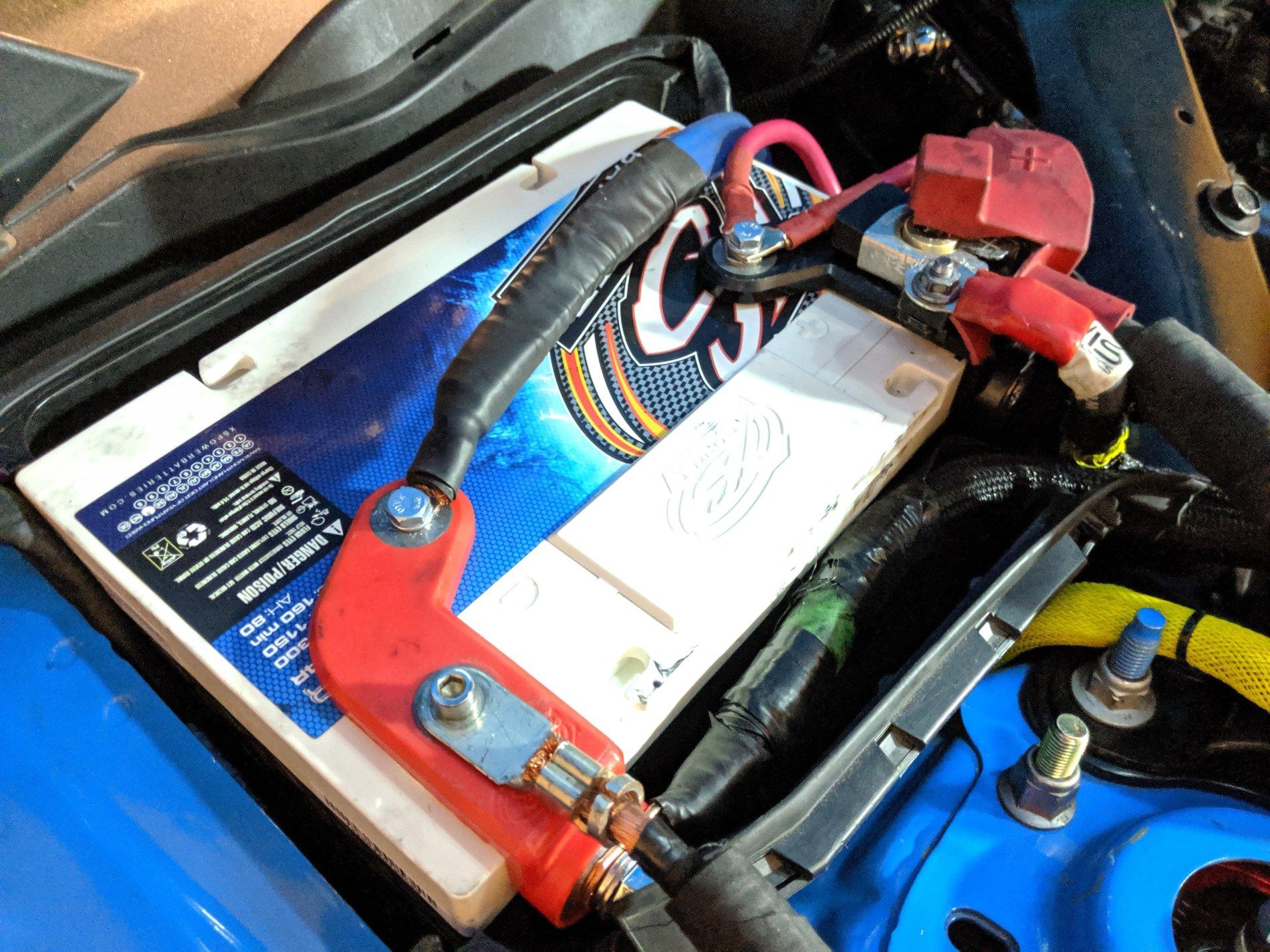

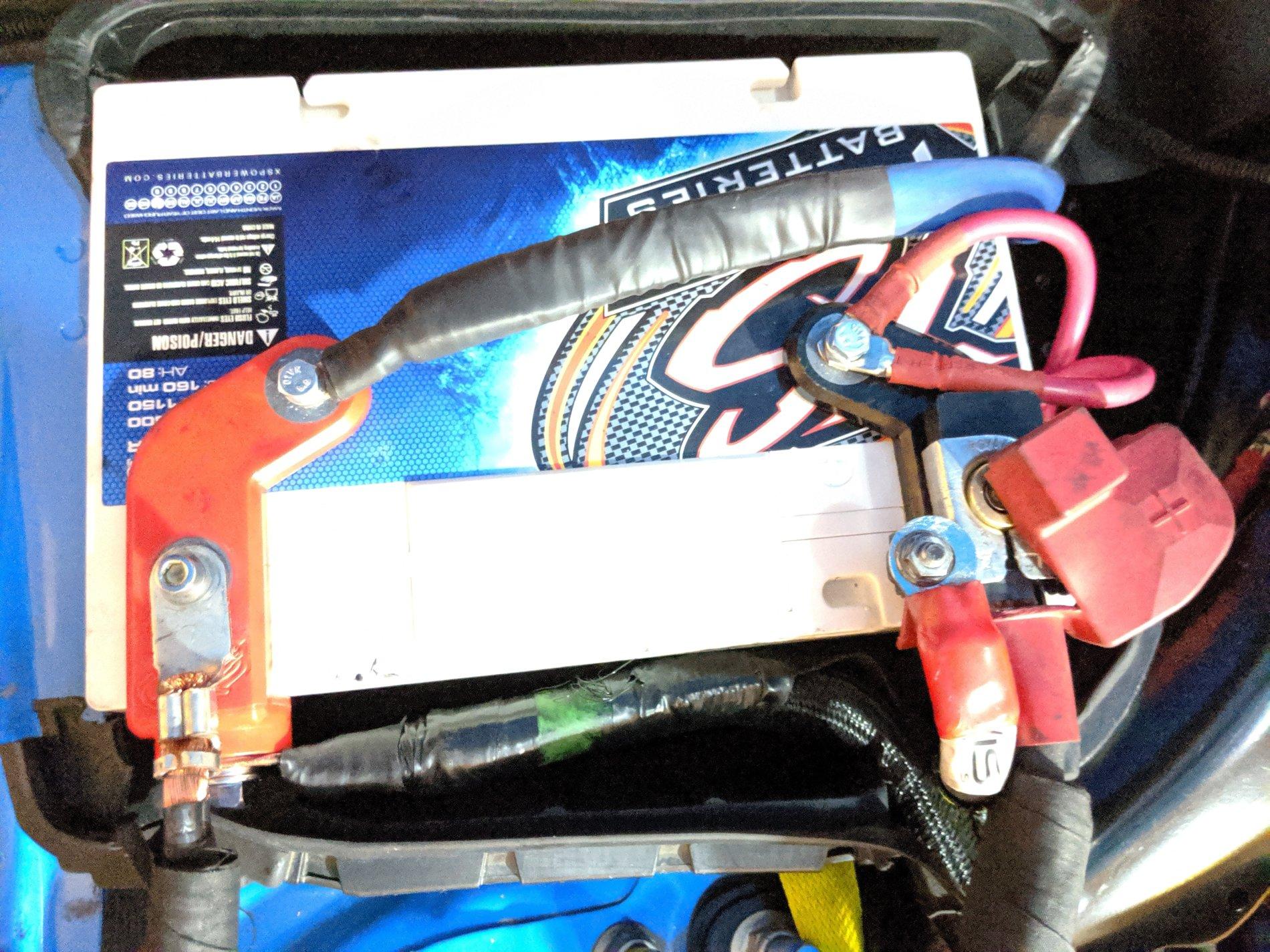

Update!
Here's what I did to make the XS 3400R battery fit. I had purchased the XS Power adapter 555 and booked them on. However since the black negative terminal to the adapter slants left it was blocking the hood from closing. So I swapped them out, positive & negative adapter, (I don't see that XS Power has those terminal adapters slanted the opposite way so I'll have to paint them myself so I don't plug something that should be grounded into the power terminal, if you know that they do make please some please let me know) & tried closing the hood, BAM. You can see in the pictures that all my cables are connected too.
Edit* also, I didn't have to cut the bottom notch out either. (Damn autocorrect!)

Great to see and thanks for the pictures! I wish mine came with that handle bit though (got it used from a guy that was upgrading his stereo system to be an array of Volt batteries!), such a pain moving it around without it.
