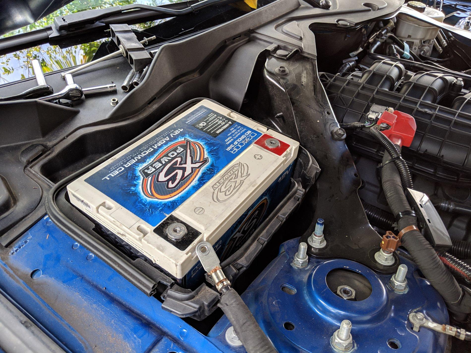

Since you said any...D3400 should fit if you cut off a short side. It's too wide and starts stressing the plastic enclosure, but there should be enough space for it to sit at the bottom if you remove a side.

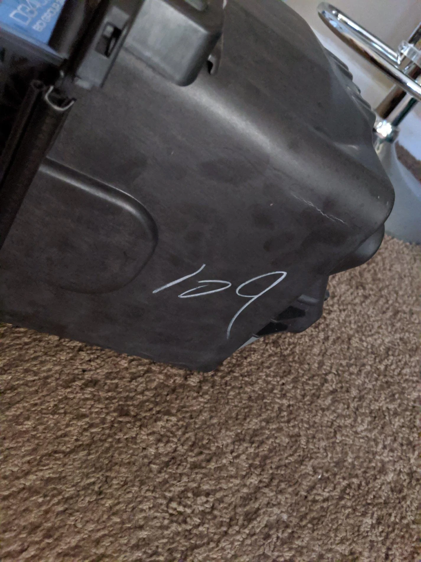

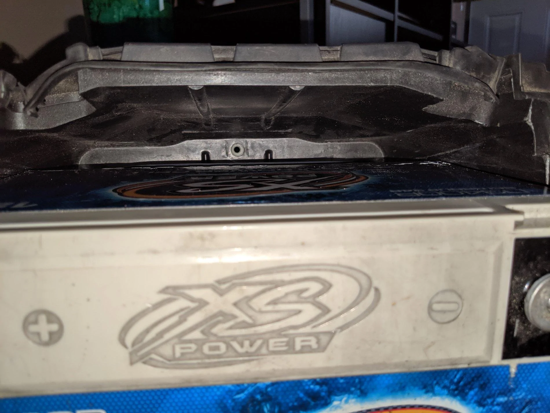

I actually said different battery models but I'll look up this D3400 as well since you posted a picture of our sitting in that same space. Thanks for the info.
***EDIT. I looked up the specs and it should fit better since I already cut the sides. Plus this had better power than the other batteries which is AWESOME!
Please come back and post your results if you go ahead with it. You'll need a D3400R to have it line up properly with the terminals (like I have in the pics). I just don't have a dremel to go ahead and cut the box like I need to in order to get things to fit.
