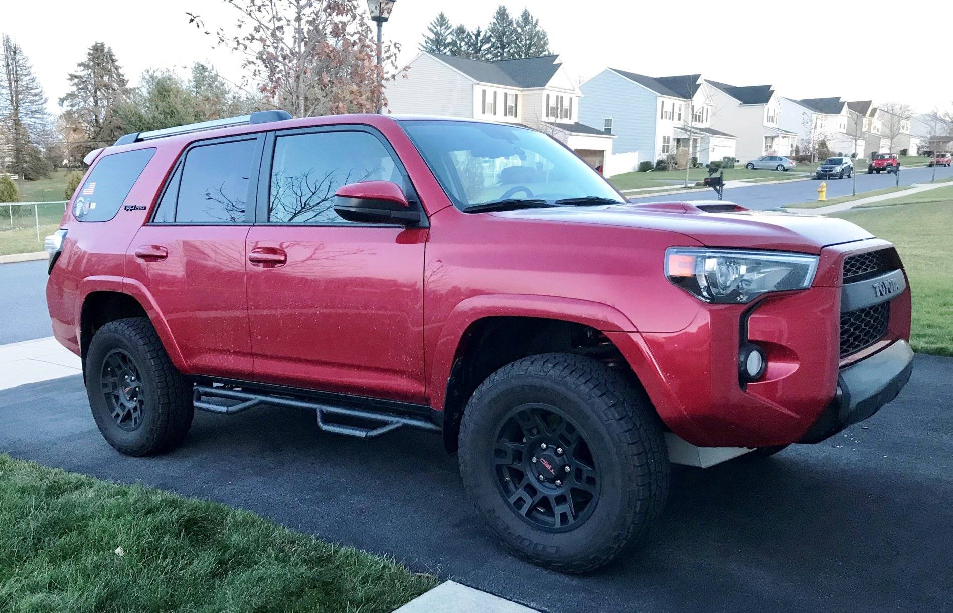

Mustang is safe in the garage. No snow or below 50 degree driving. I have no problem driving in snow or for that matter on just about any road or trail I want to cut. My Mustang is for going fast and this is for snow. Use the right tools to get the job done.

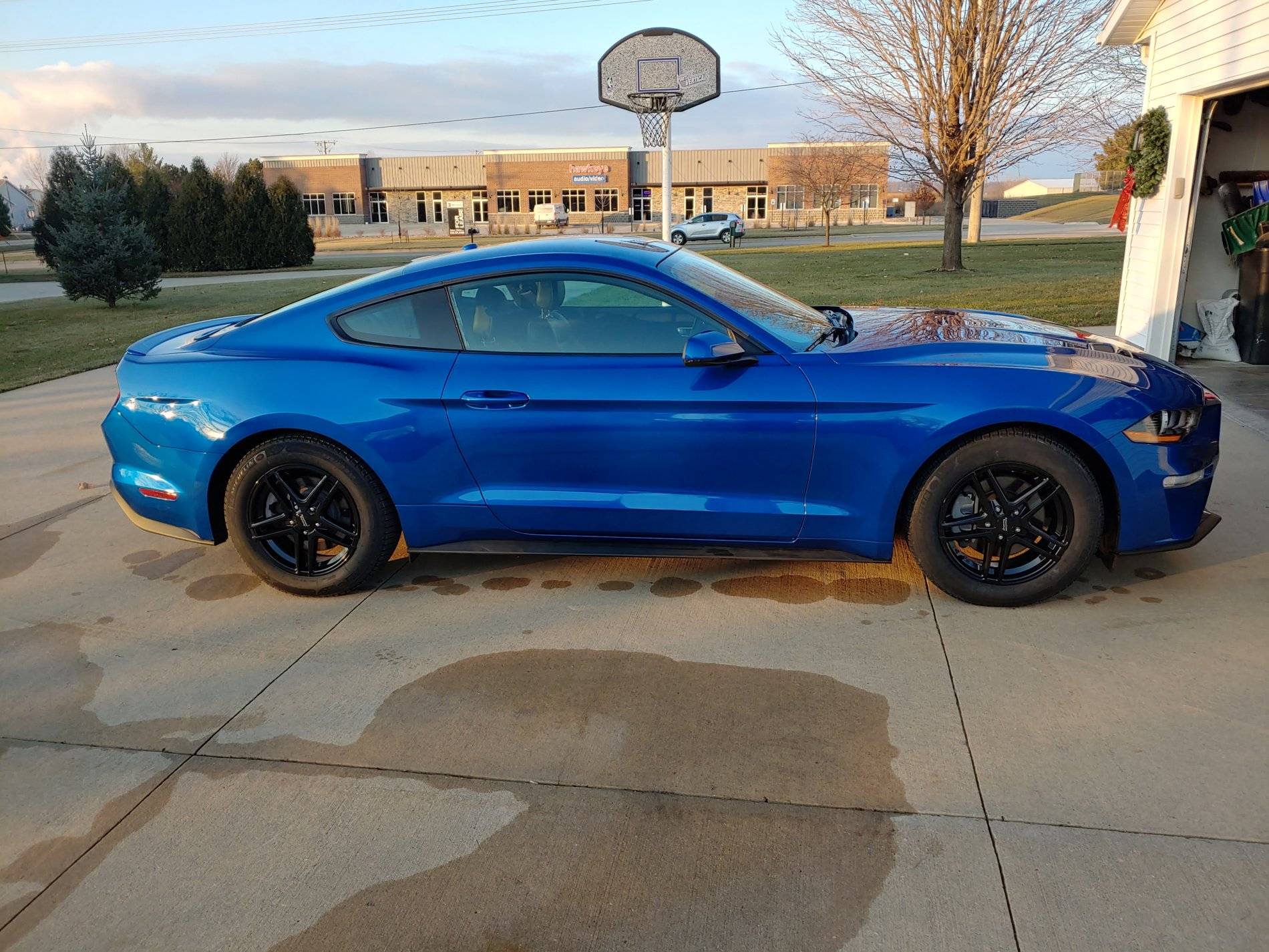

I went with 225/60/17 Michelin X-ice tires on 17x7.5 inch American Racing rims. Did great getting around everyday last winter, have only gotten one snow so far this year!
