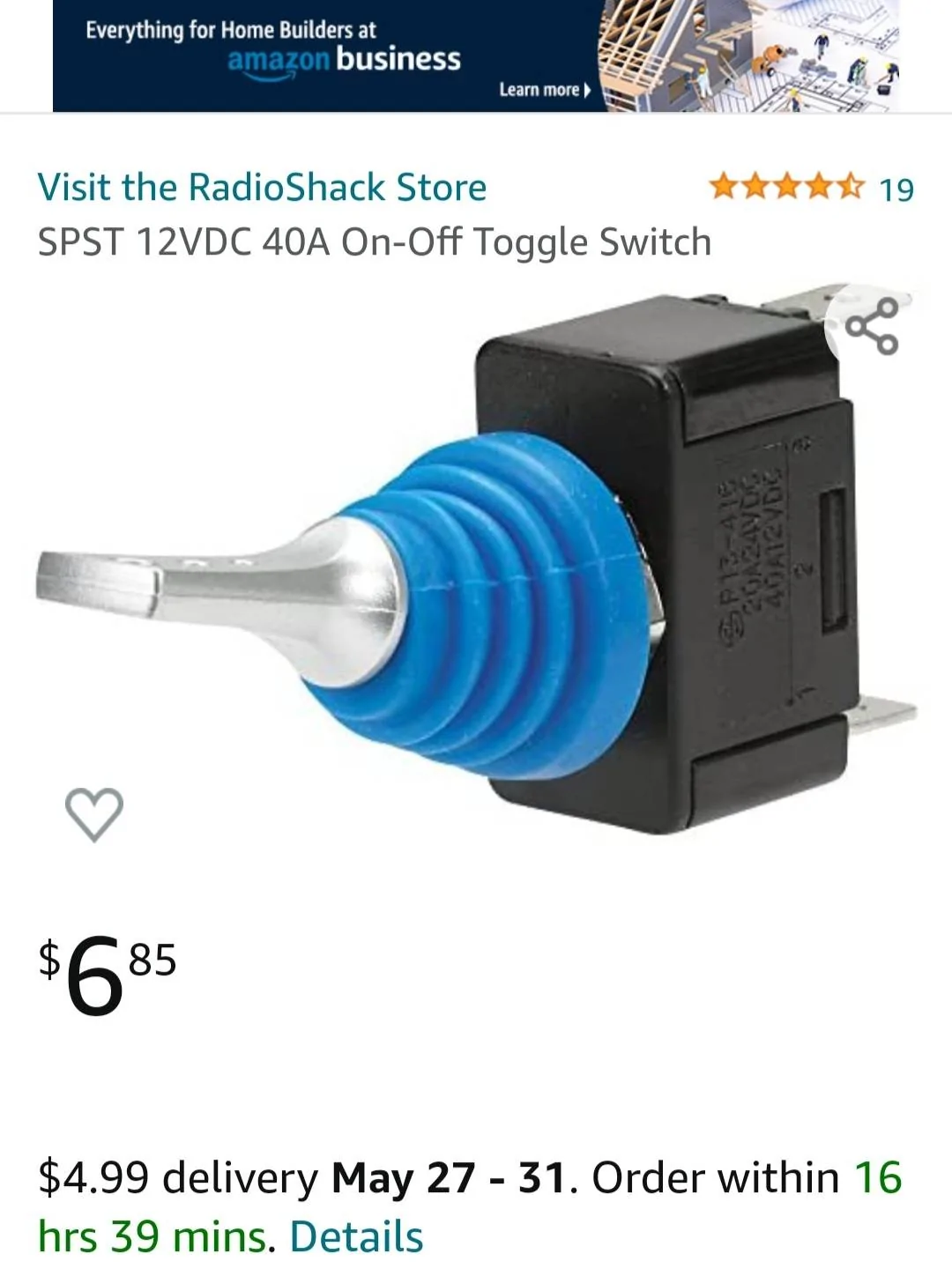

Anyone actually done this? Or could be be just a waste not sure. But sounds easy enough. So no relay. But unsure how to go about the actual connections. Put in a single pole high voltage / switch in the ground line I guess would be one way. Not sure about the fuel pump driver module and how to put a switch into that. Like I said, was an idea but maybe not worth the hassle or even if it would make a difference.
ORRadtech
Sep 12, 2019
4,063
3,994
Atlanta, Georgia
A high voltage switch is unnecessary, your whole car runs on 12V. The thing you need to be concerned with is current capacity. The fuel pump is fused at, I believe, 30A. Any switch that exceeds that capacity will be fine.
I'd be leary of messing with any of the comand wires though they'd likely require a less robust switch.
