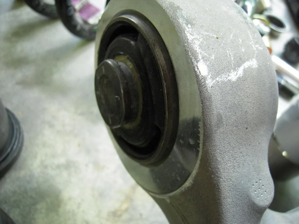

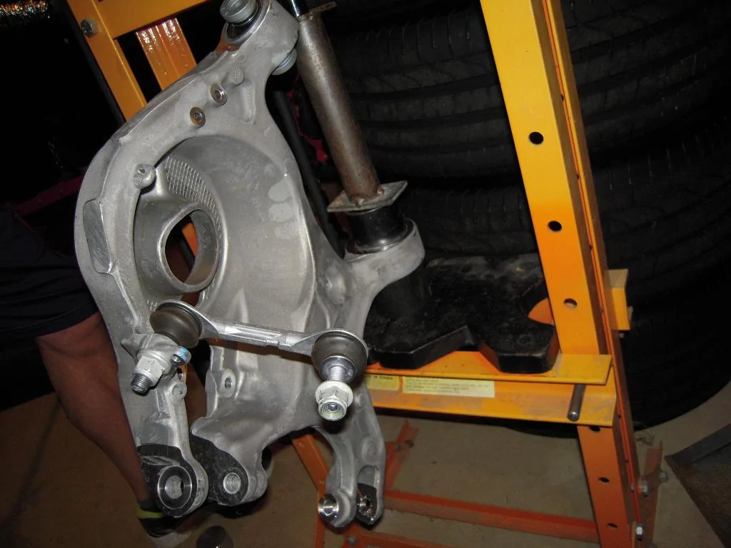

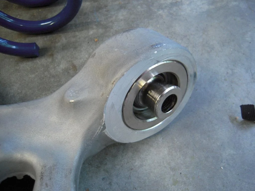

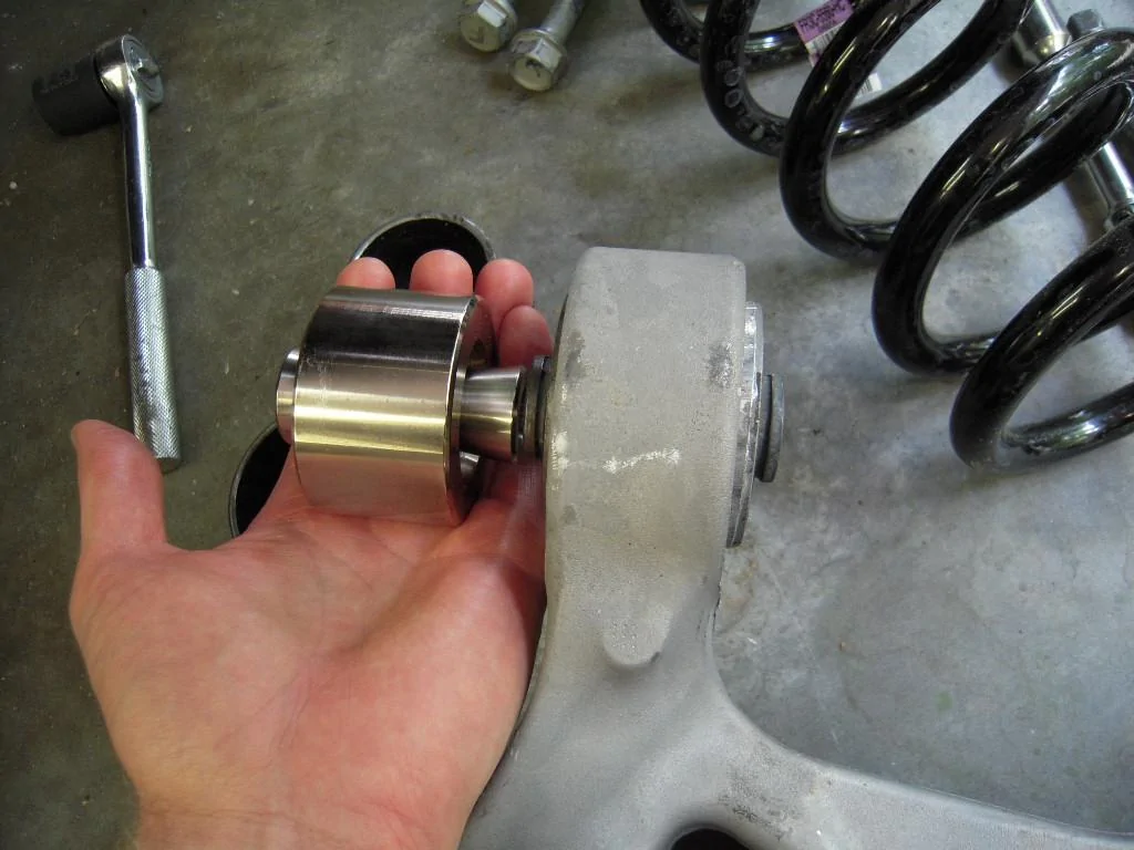

The first one we pressed in we had a helluva time with... probably took us 1.5 hours. We almost gave up on it. The second side went in like buttermilk. The control arm is also very awkward to get a straight shot in a press (see pic of what we finally did) and if you don't have a nice straight shot at it, you're not going to get that bearing in straight. The BMR setup where you can buy the LCA with bearings already pressed in is probably the way to go. Getting the control arm in and out really wasn't hard at all using the BMR recommended instructions.
