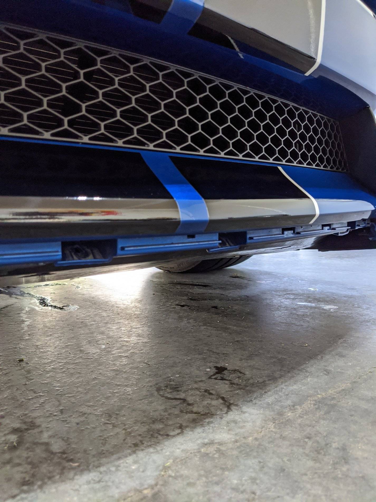

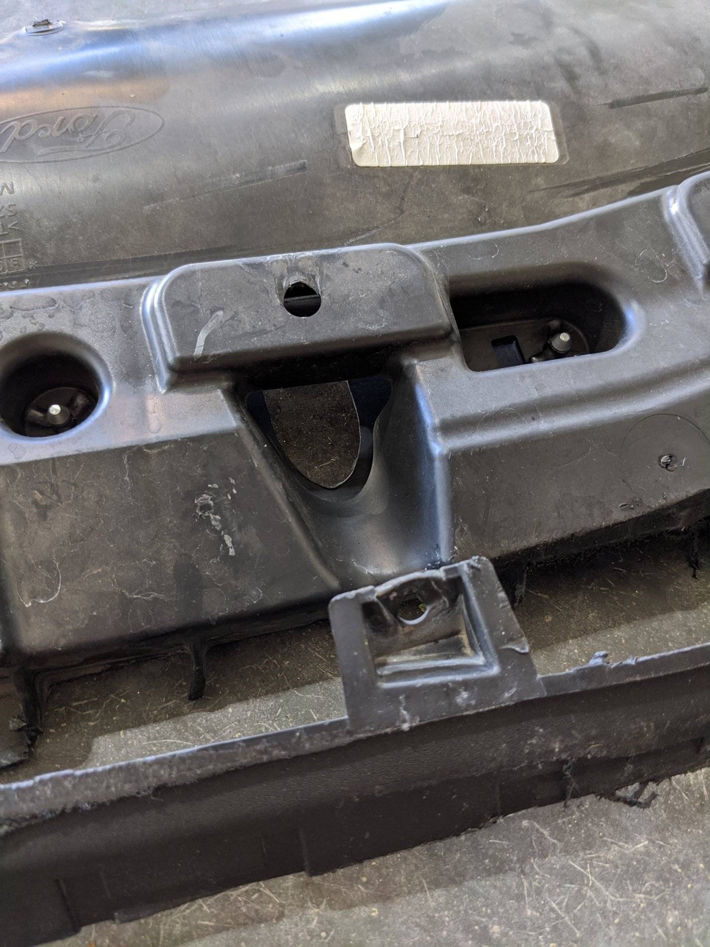

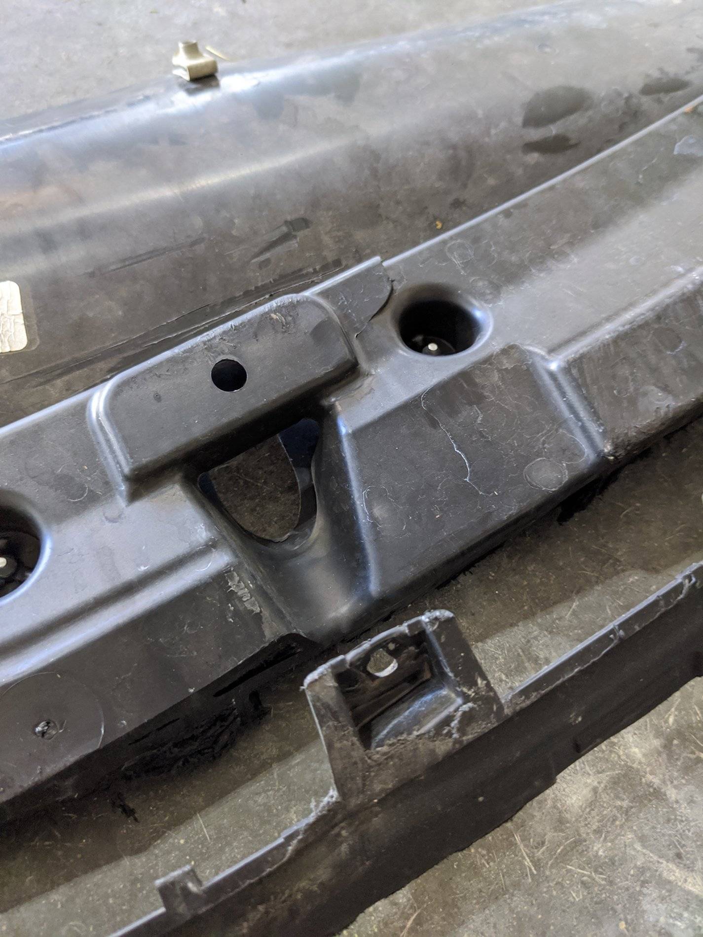

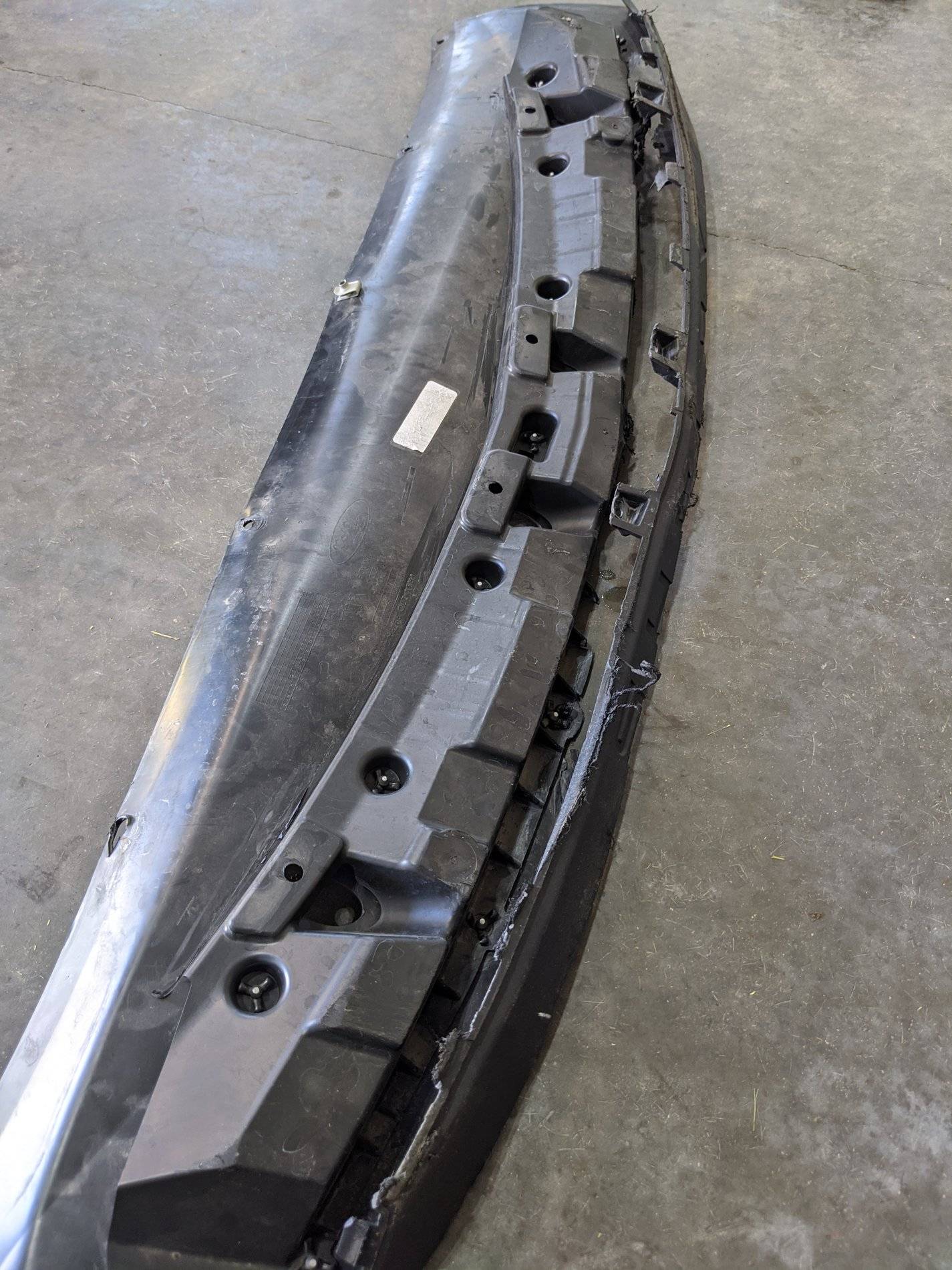

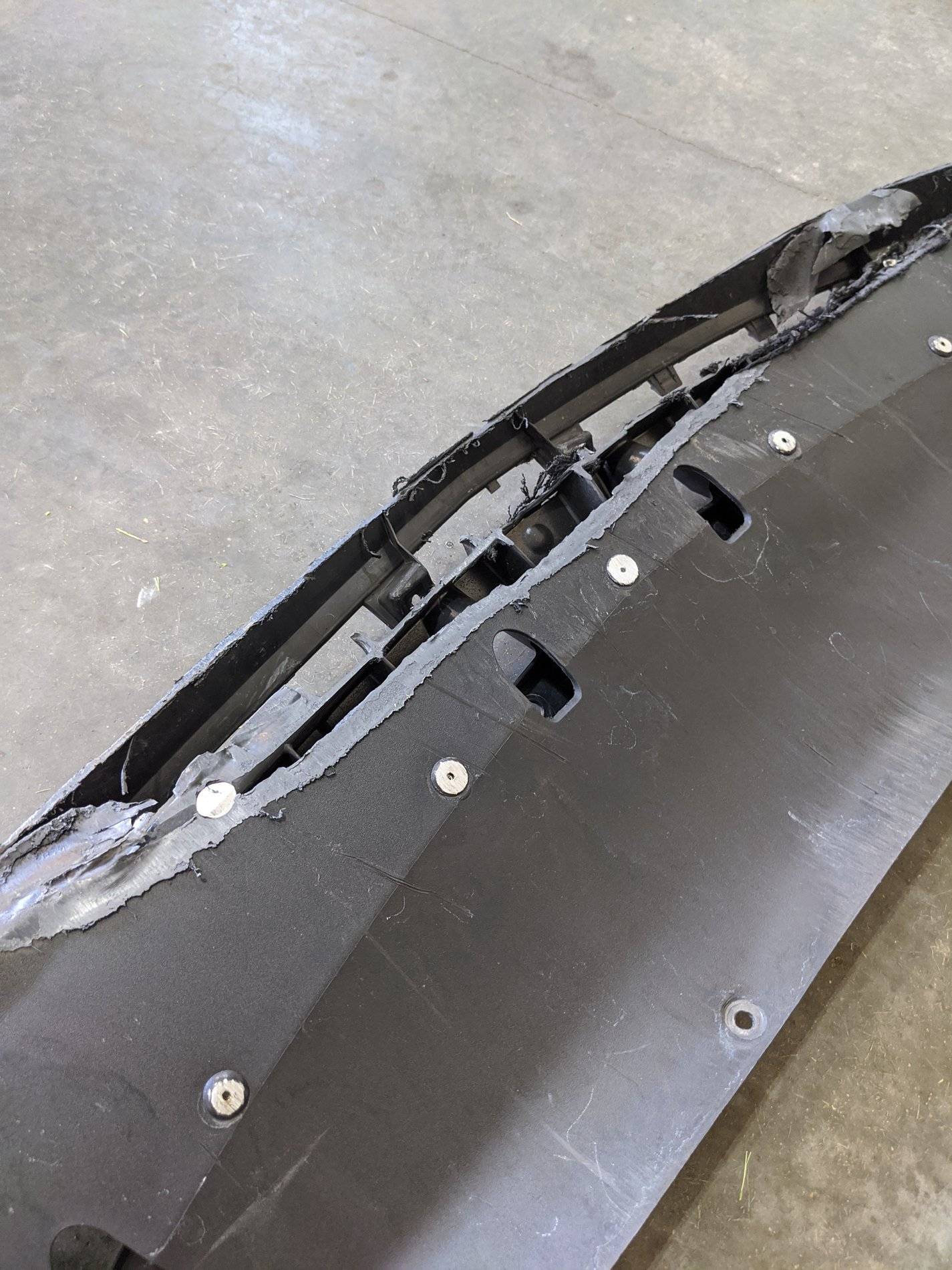

Ok here is what we got.. NO other damage to the car. Here are the pics of the damage splitter. I can see where all of you are talking about the 4 extra bolts that hold the front clip. Those were clearly not installed.
Order a new one from these guys. https://parts.autonationfordwhitebearlake.com/oem-parts/ford-spoiler-fr3z17626e
Also order sliplo to protect the new one...
Also I washed the car. Then decided it will never leave the garage again so it can never be further damaged... :)

Awesome that you had no other damage. Clearly it was installed without the correct hardware and it just took time to come loose enough for the wind to catch it and pull the tabs out of the mounting slots at high speed. Really good that the belly pan didn't get stripped out or broken where the rear of the splitter mounts to it!
