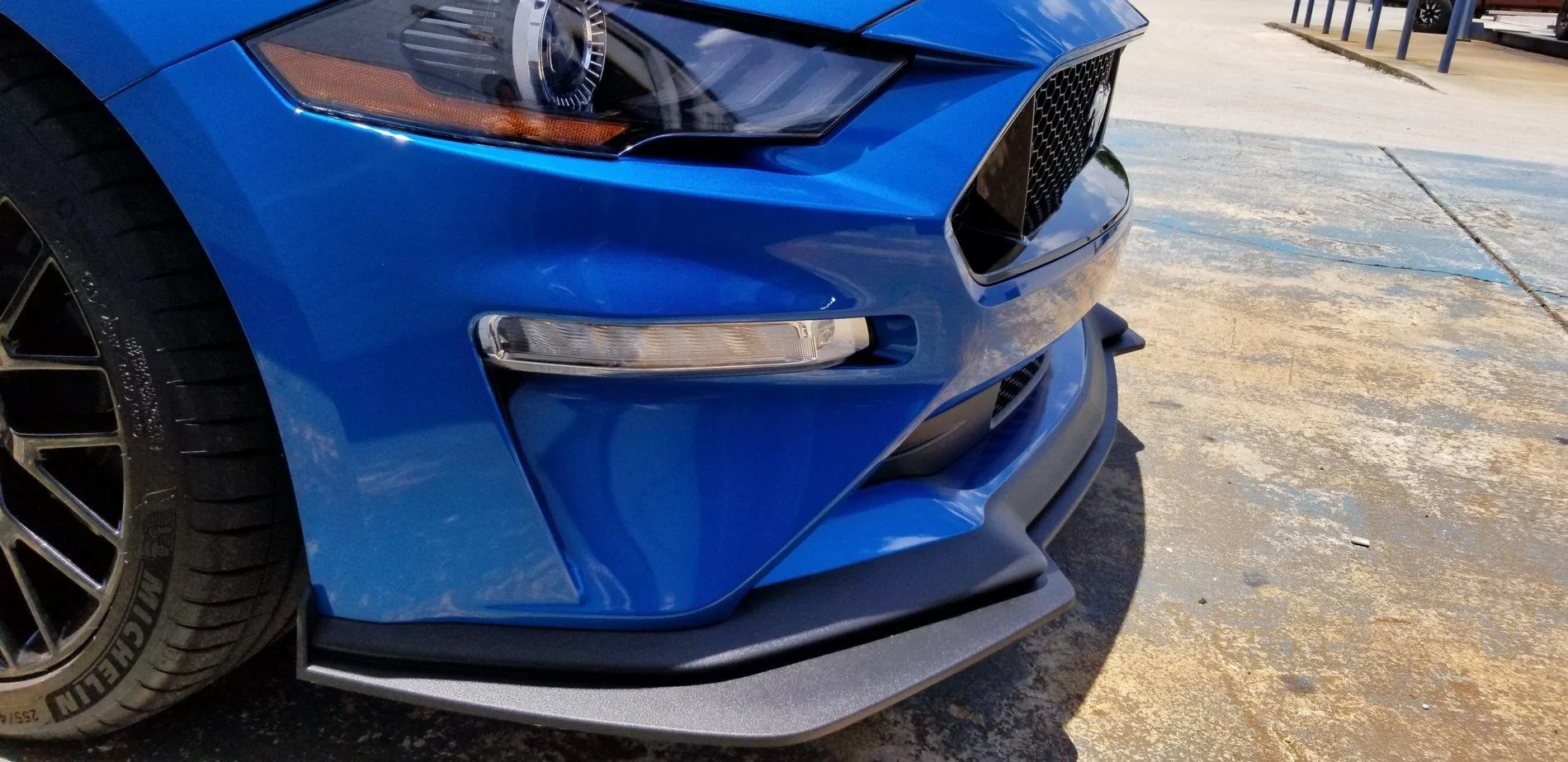

Just recently installed the Scott Drake front splitter from LMR. It's slightly bigger than the PP2 and definitely gives it a more agressive look. It's secured by 3M tape and bolts as well. I've taken it multiple times over 100 and it's been holding up well. I'm going to add some splitter rods soon as well for more support.

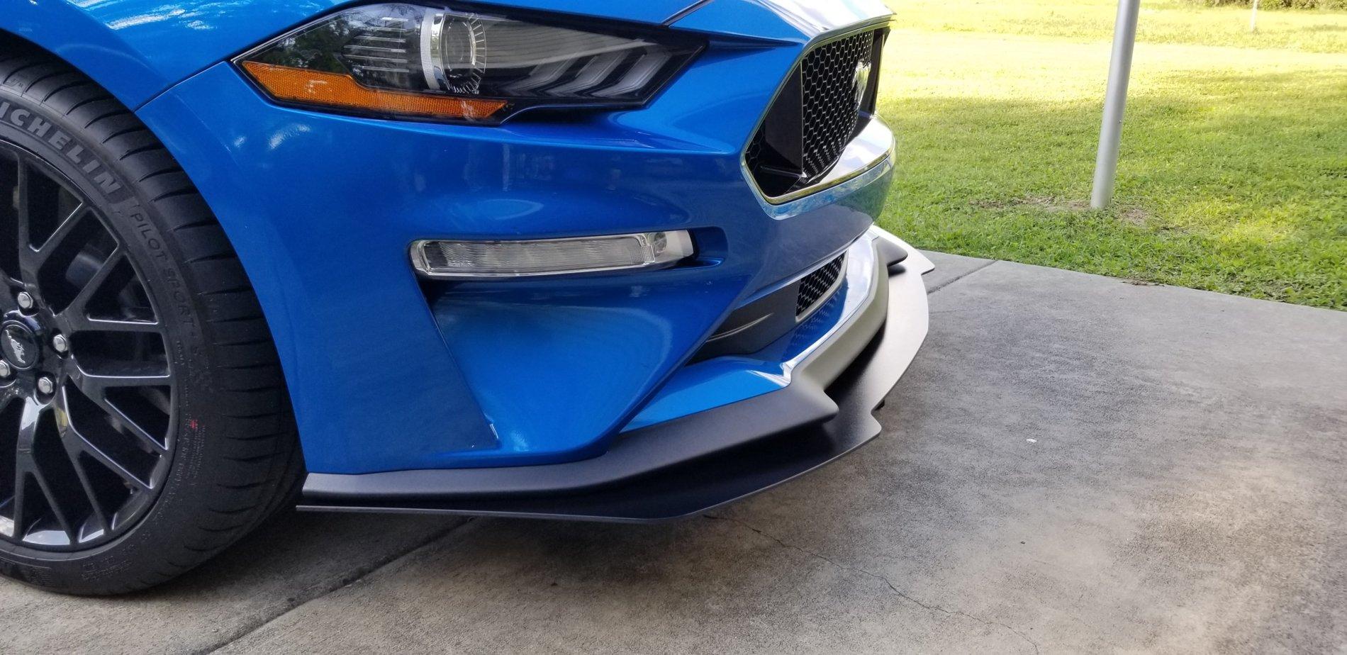

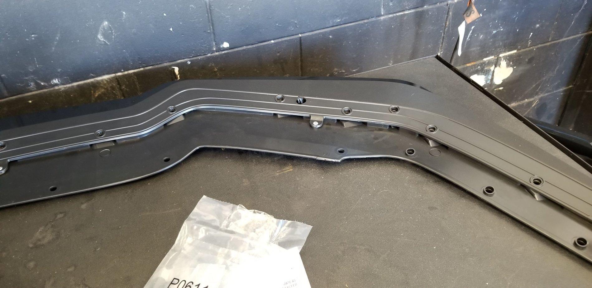

I am a tech at a Ford dealership, I ran the VIN from a PP2 car we have on the lot against my PP1. It comes exactly how the PP2 cars do, in a bag with all hardware and instructions. Cost is about $380, employee pricing is 10% over that.
You do need to drill for the 3 alignment pegs and for the nut plates along the front. The Plastic rivets just support the back of the splitter to the pan and are easy to remove if the splitter or pan needs to be removed, these can be replaced with locking push pins. View attachment 365412

You don't need to drill the pan, it has holes from the factory, you only drill into the splitter to access the nut plates and for the alignment pins.
I drilled for the nut plates once everything else was riveted and bolted up.

For the alignment pegs did measure somehow on where to drill?

They do not, the stock splitter on the pp2 cars come predrilled. I mounted the lower splitter up with a few push pins along the back and bolted the side up then marked the pins, they don't need to be perfect, and probably can be removed.
