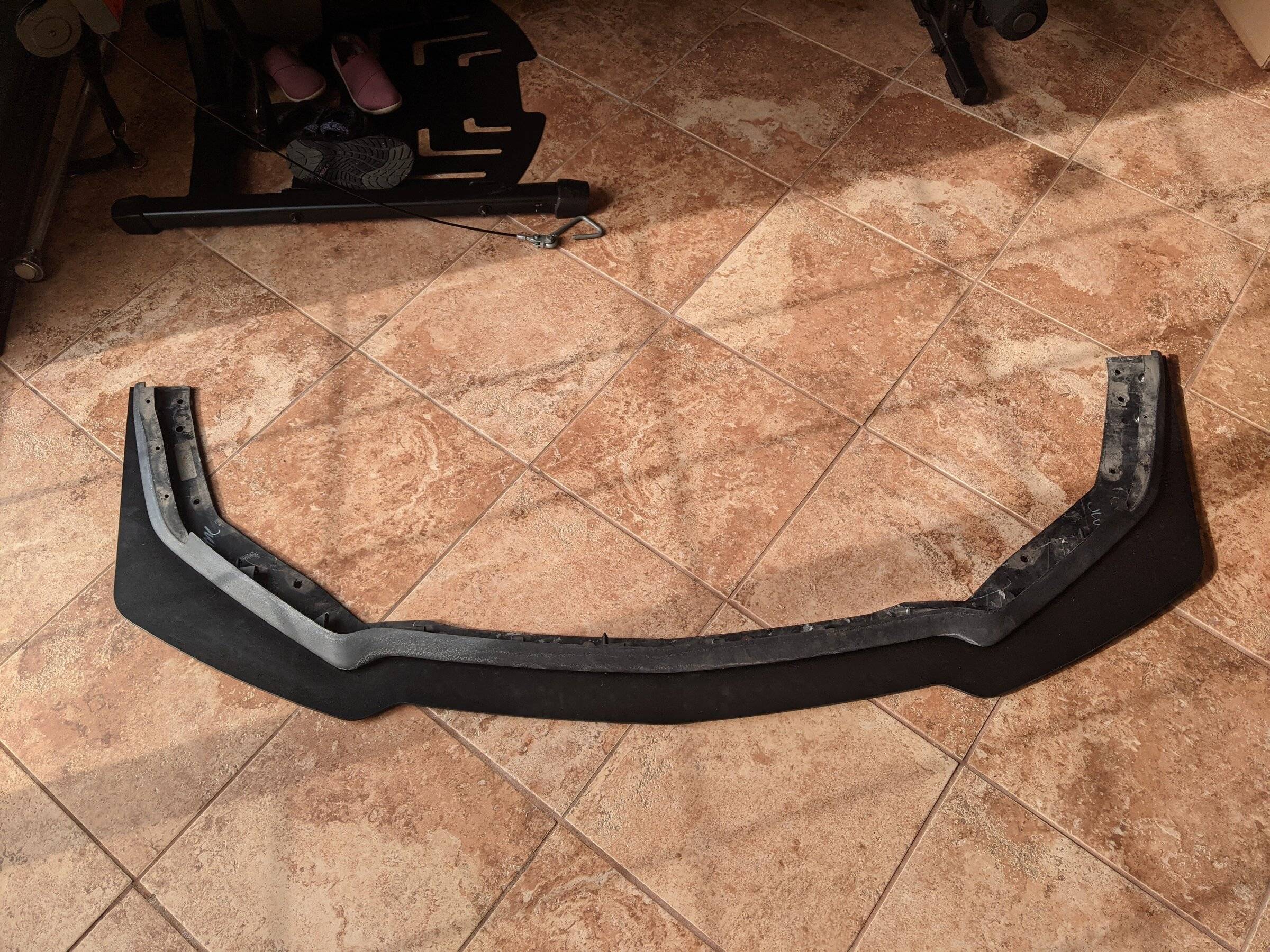

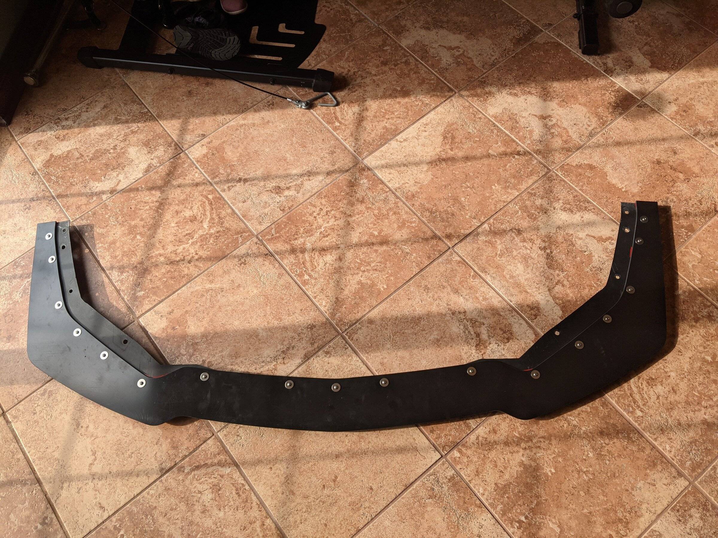

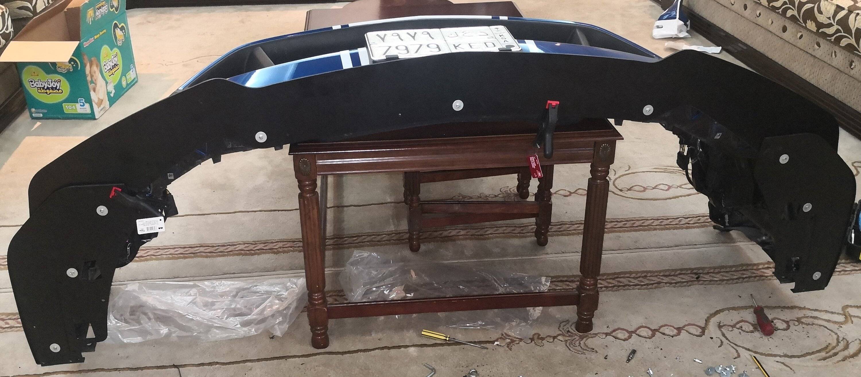

I got the Scott Drake front splitter for PP cars. While it is described as applicable to both GT and EB PP cars, I can attest to the fact that it does not simply bolt on to a EB PP car. None of the holes lined up. Not sure why that is. The front chin spoilers on both GT and EB PP look the same from the outside. But apparently there are differences. I'm going to still use it, but I did my own mounting configuration, with many more attachment points to the chin spoiler (see below). However, looking at it, it seems to stick out a bit further than what it does on a GT PP. Since I use this car for some HPDE, at a long track (Road America), speeds will exceed 130 MPH. I don't see the splitter ever departing from the chin spoiler, but I am a bit concerned that the splitter/chin spoiler combo could part ways with the bumper cover. I was hoping to avoid support rods, but will install them if absolutely necessary.

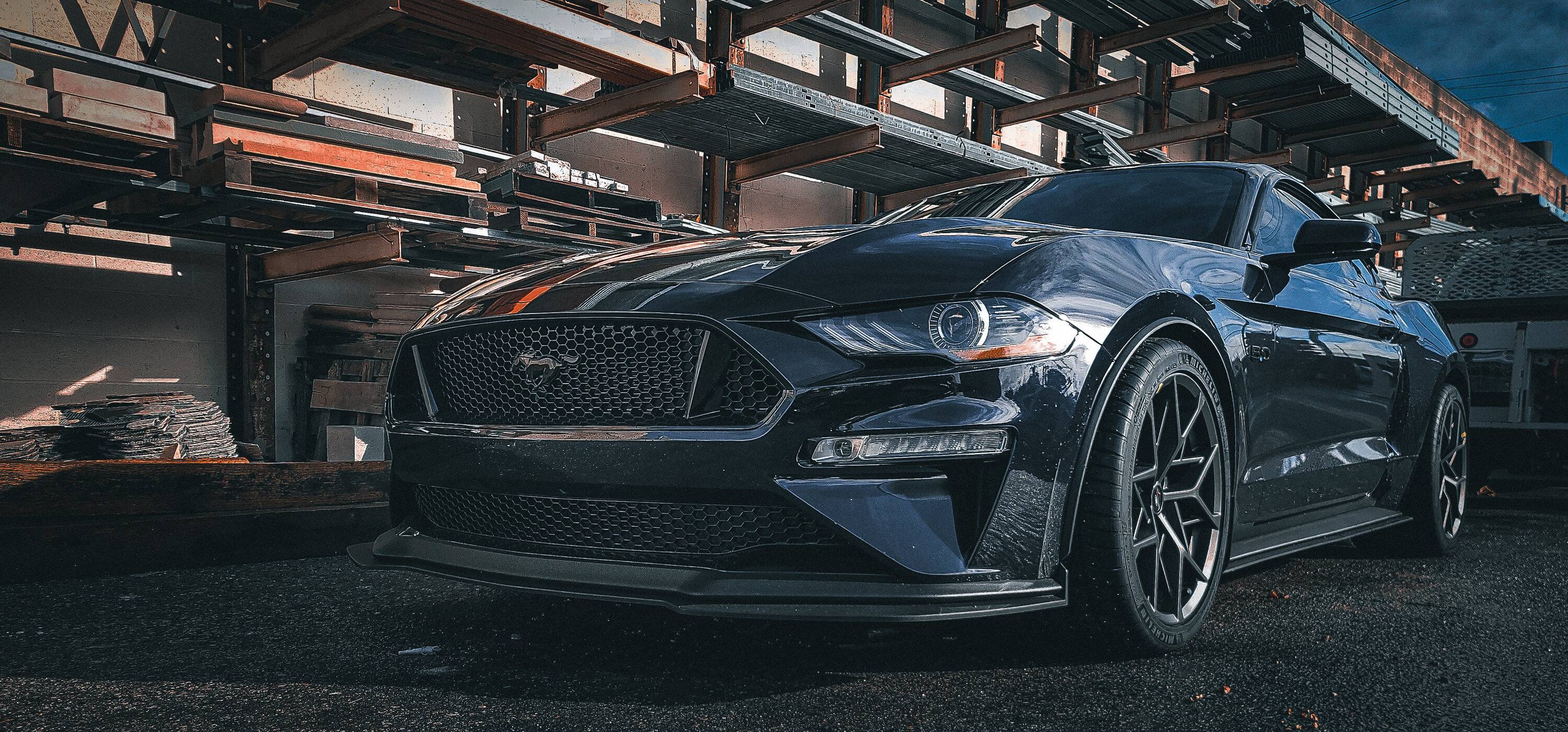

I went with the most expensive option.
2 piece oem chin spoiler and splitter for pp2 installed on my pp1! It's the nicest and cleanest imo...
My biggest concern was pretty much everything everyone inhread has dealt with. Holes not lining up, sticking out too far,
I Didn't want rods and I wanted install to go smooth! No bumber removal required, no drilling and everything lined up perfect!
Both are very strong and came with good instructions!
Someone once told me "cheap splitters aren't good and good splitters aren't cheap"! Something to think about when considering all options!

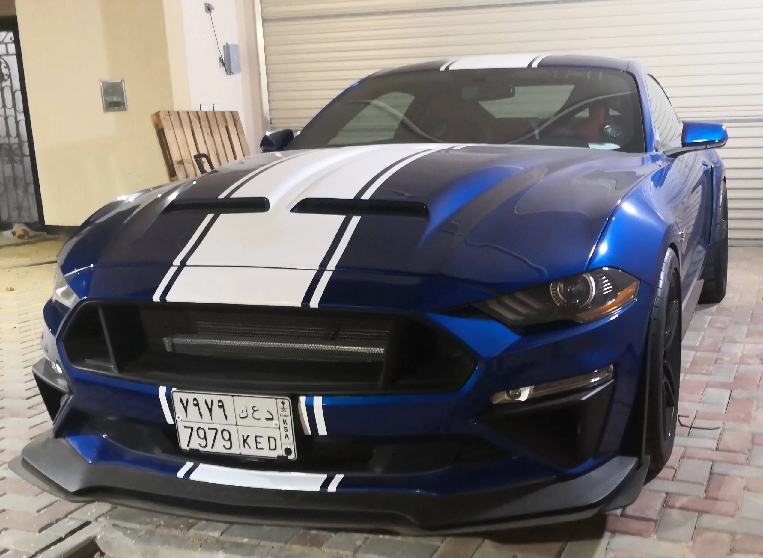

I just did my own version of combining the Scott Drake front splitter along with the GT500 Lower Front Chin Splitter Side Wickers! Along with the factory ROUSH front lip.
